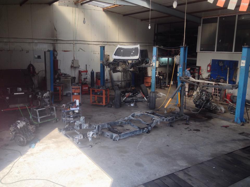

alin-jeep Posted October 3, 2014 Share Posted October 3, 2014 (edited) Masina este din 2008 ,varianta scurta . Vom face transformari la: - puntea fata DANA 44 -inlocuire planetare -inlocuire pivoti -raNforsare carcasa -interventii sistem franare -inlocuire furtune frana -Kit inaltare -inlocuire roti cu 35x12.5x17 -revopsire integrala -negru mat -bara fata+spate HD -montare troliu -inlocuire grila fata -inlocuire aparatori noroi ...si mai vedem intre timp Va tin la curent -promit :wink: Edited October 3, 2014 by Astral 1 Link to comment Share on other sites More sharing options...

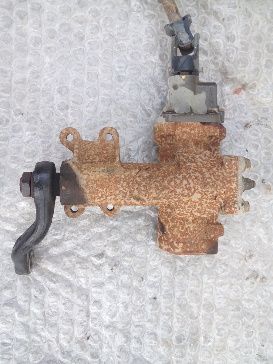

alin-jeep Posted October 7, 2014 Author Share Posted October 7, 2014 Re: Wrangler Rubicon -upgrade Jucariile pentru puntea fata : -pivoti Synergi -planetare RCV -simeringuri punte Crown [ATTACH=CONFIG]226110[/ATTACH] Furnizor : Jeepmania.ro :grin: :h5 Link to comment Share on other sites More sharing options...

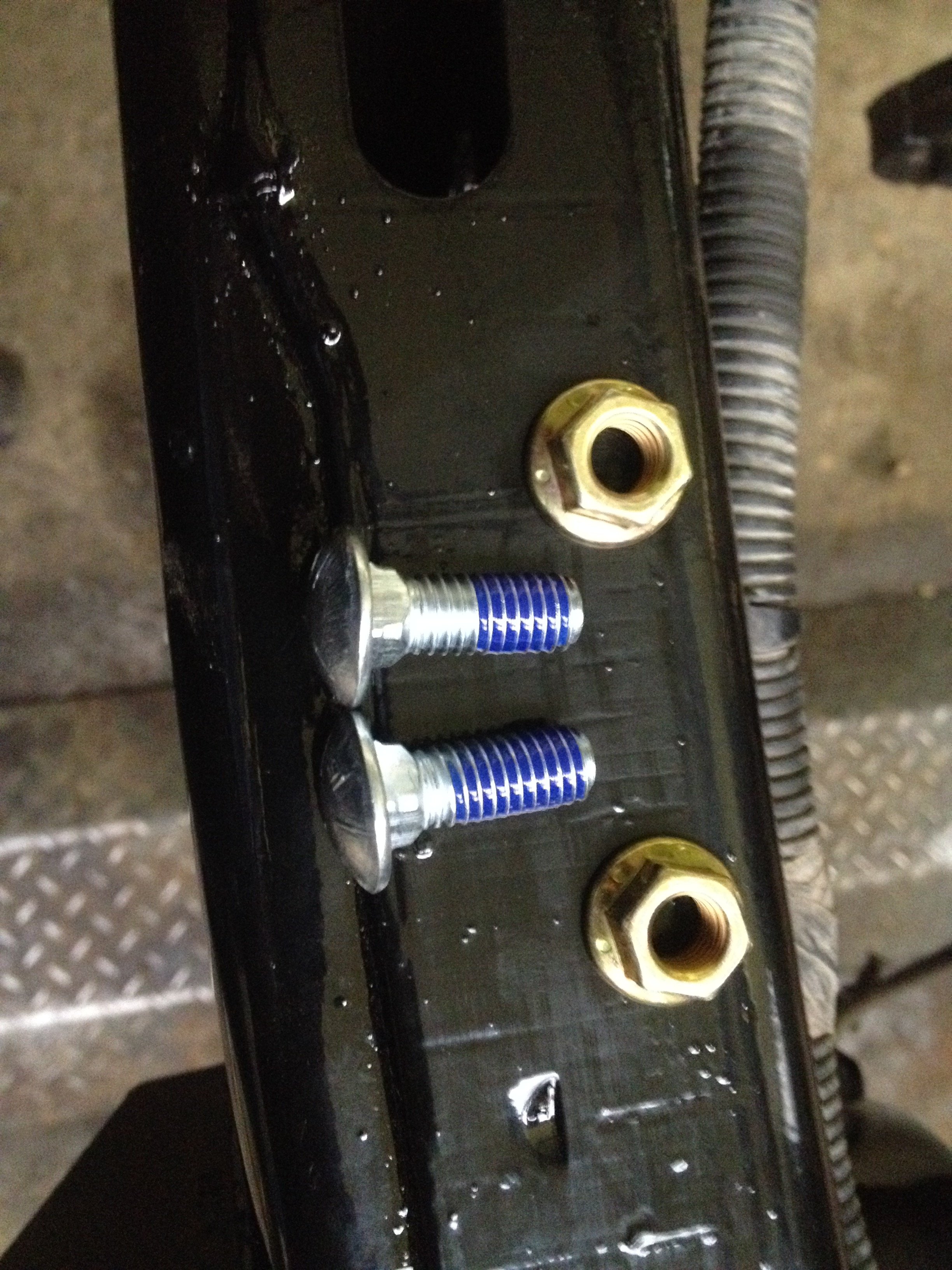

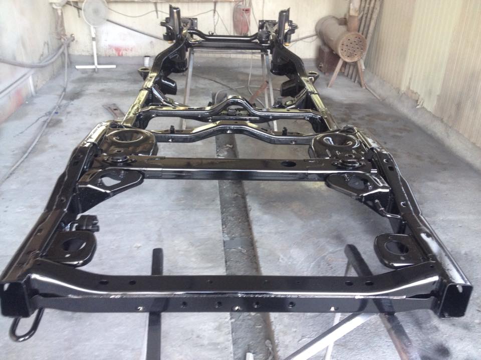

alin-jeep Posted October 14, 2014 Author Share Posted October 14, 2014 (edited) Re: Wrangler Rubicon -upgrade Am inceput cu sasiul pentru ca am vazut ca vopseaua este cam subtire si in multe locuri a aparut rugina . -spalat cu jet de apa fierbinte -curatat cu periii de sarma si matuit cu smirghel -degresat cu diluant -aplicat 3 straturide vopsea negru mat Superplast -aplicat 2 straturi consistente de lac+intaritor Klar HS Urmeaza sa tratam interiorul cu o ceara speciala Maine va fi uscat si gata pentru remontrea componentelor :h5 Edited October 15, 2014 by alin-jeep 1 Link to comment Share on other sites More sharing options...

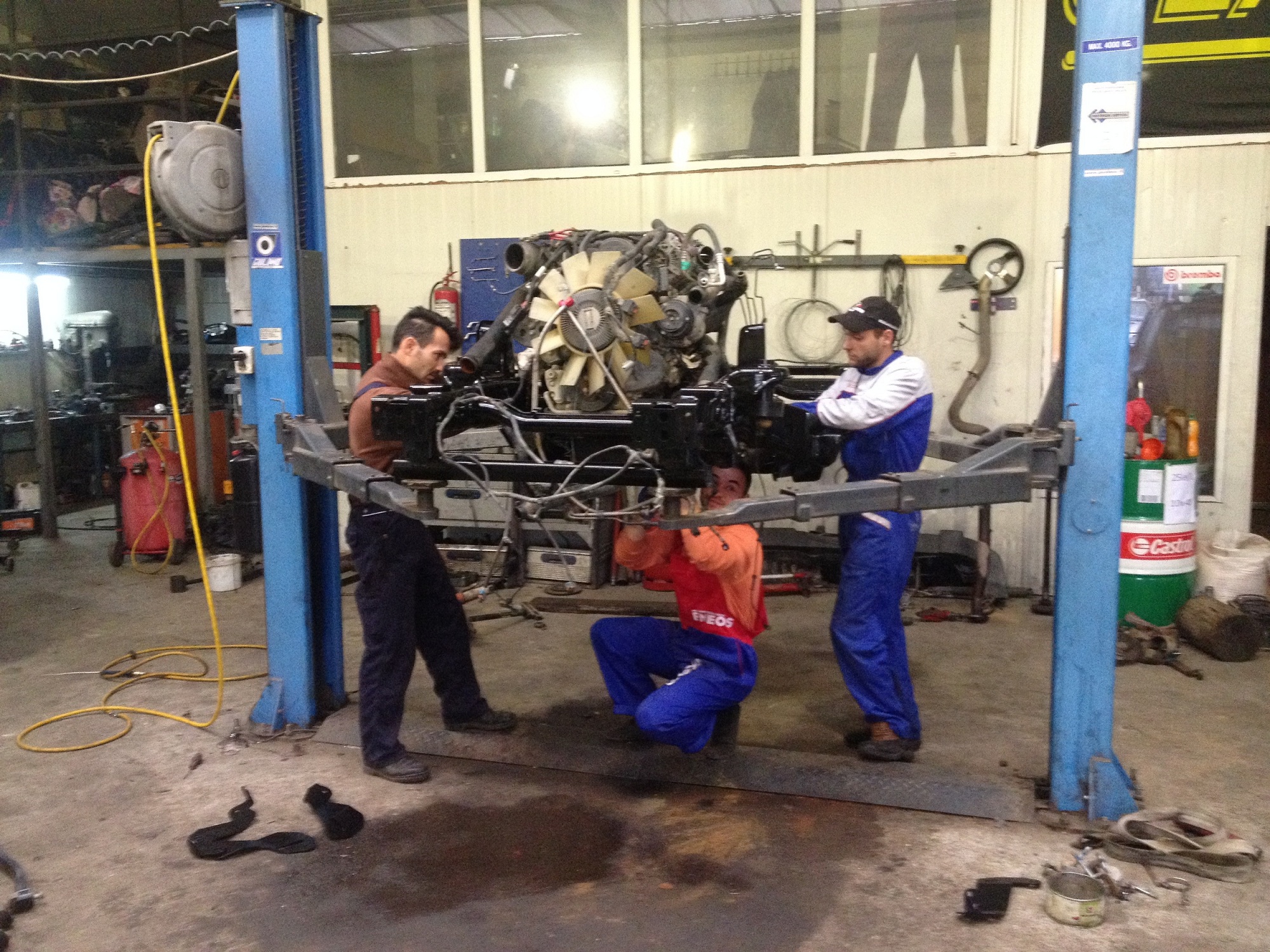

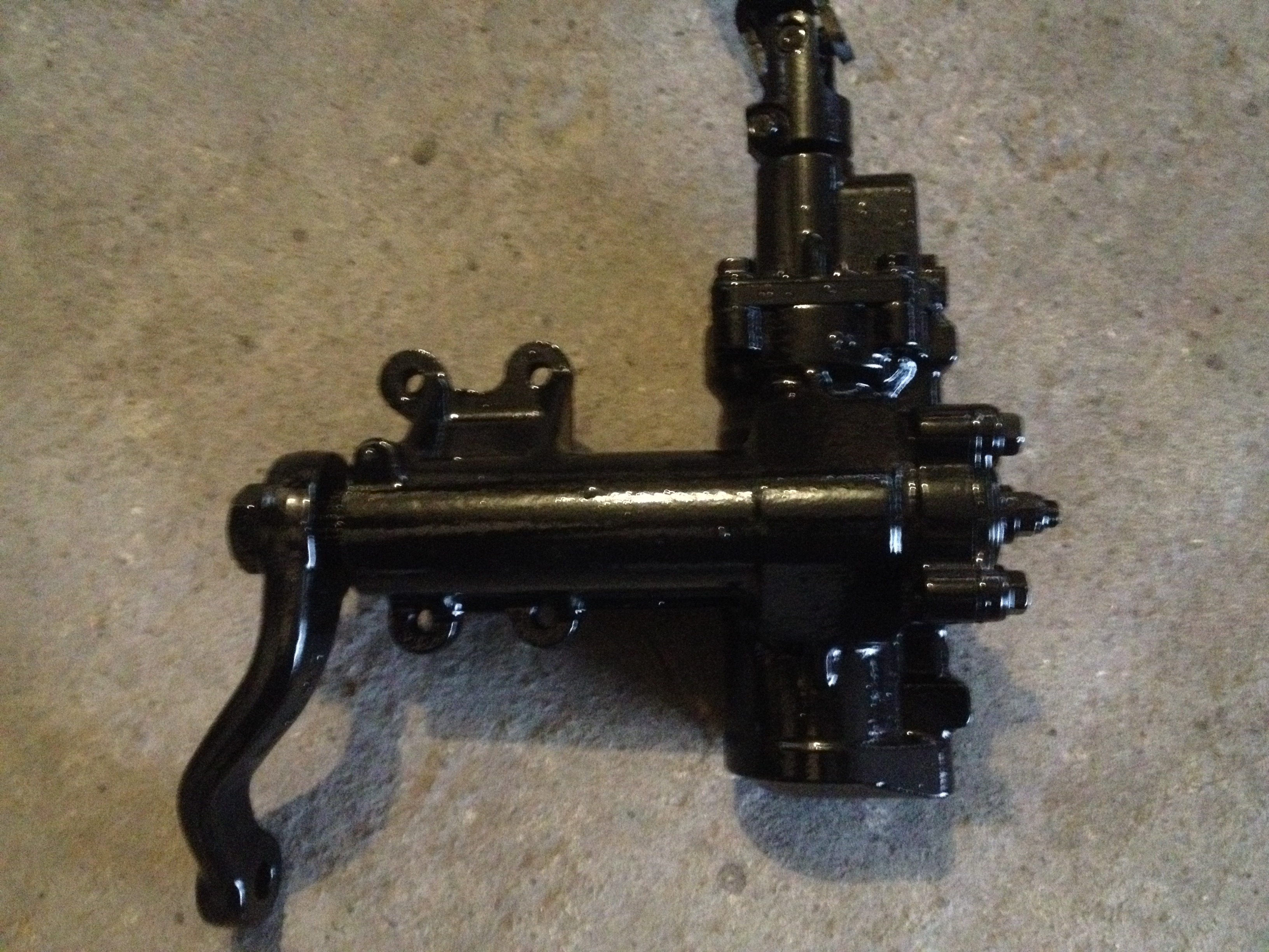

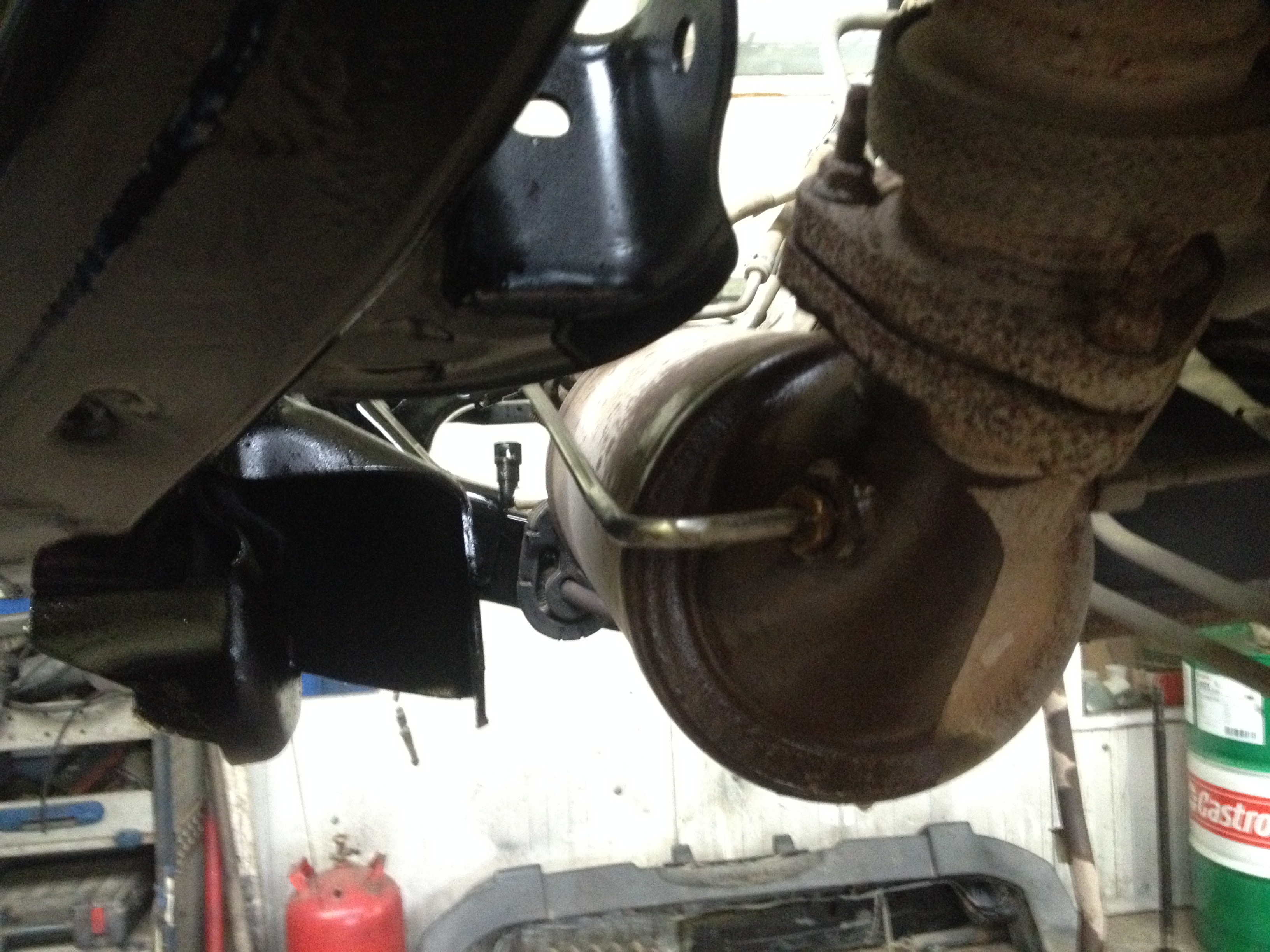

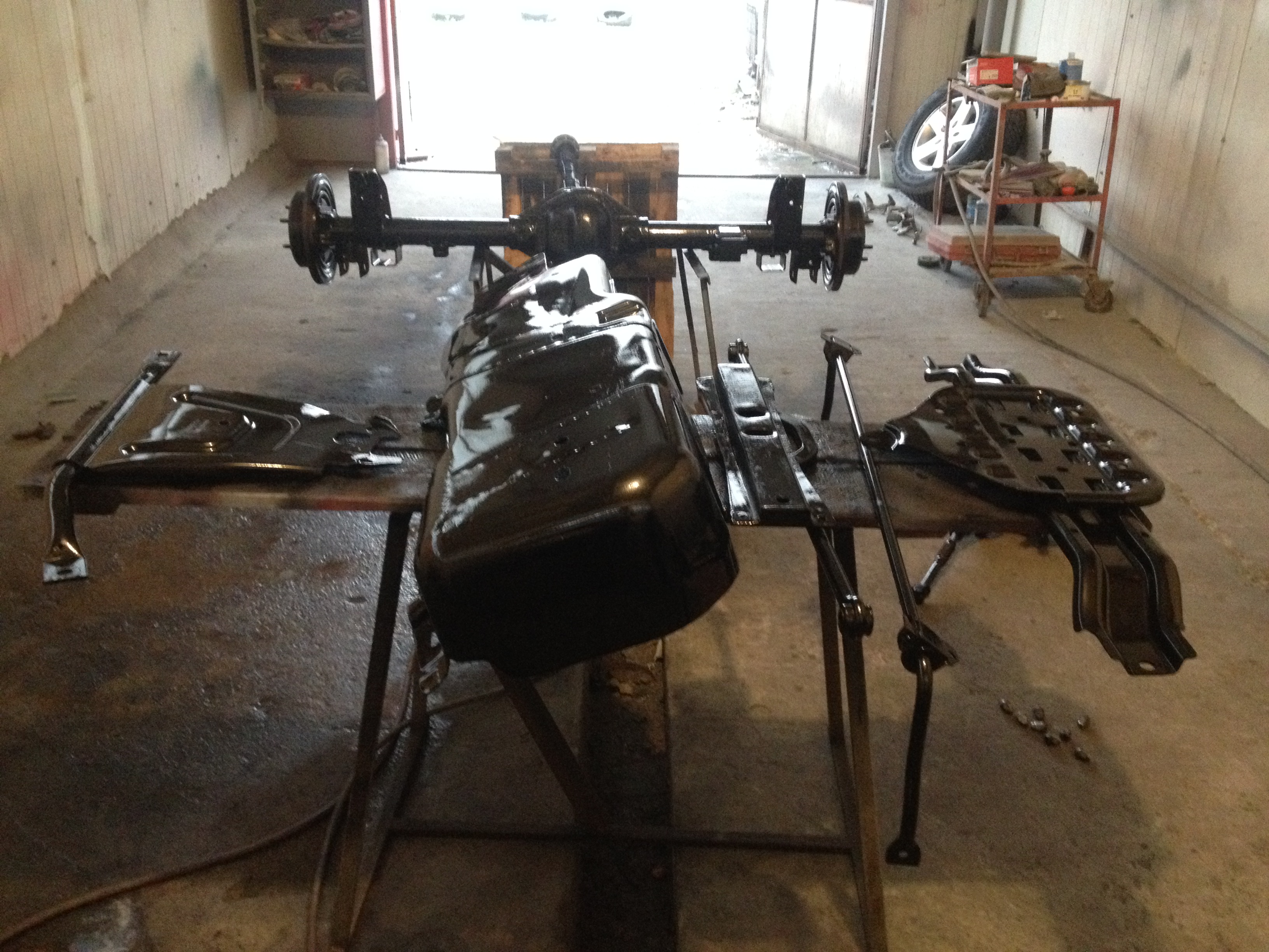

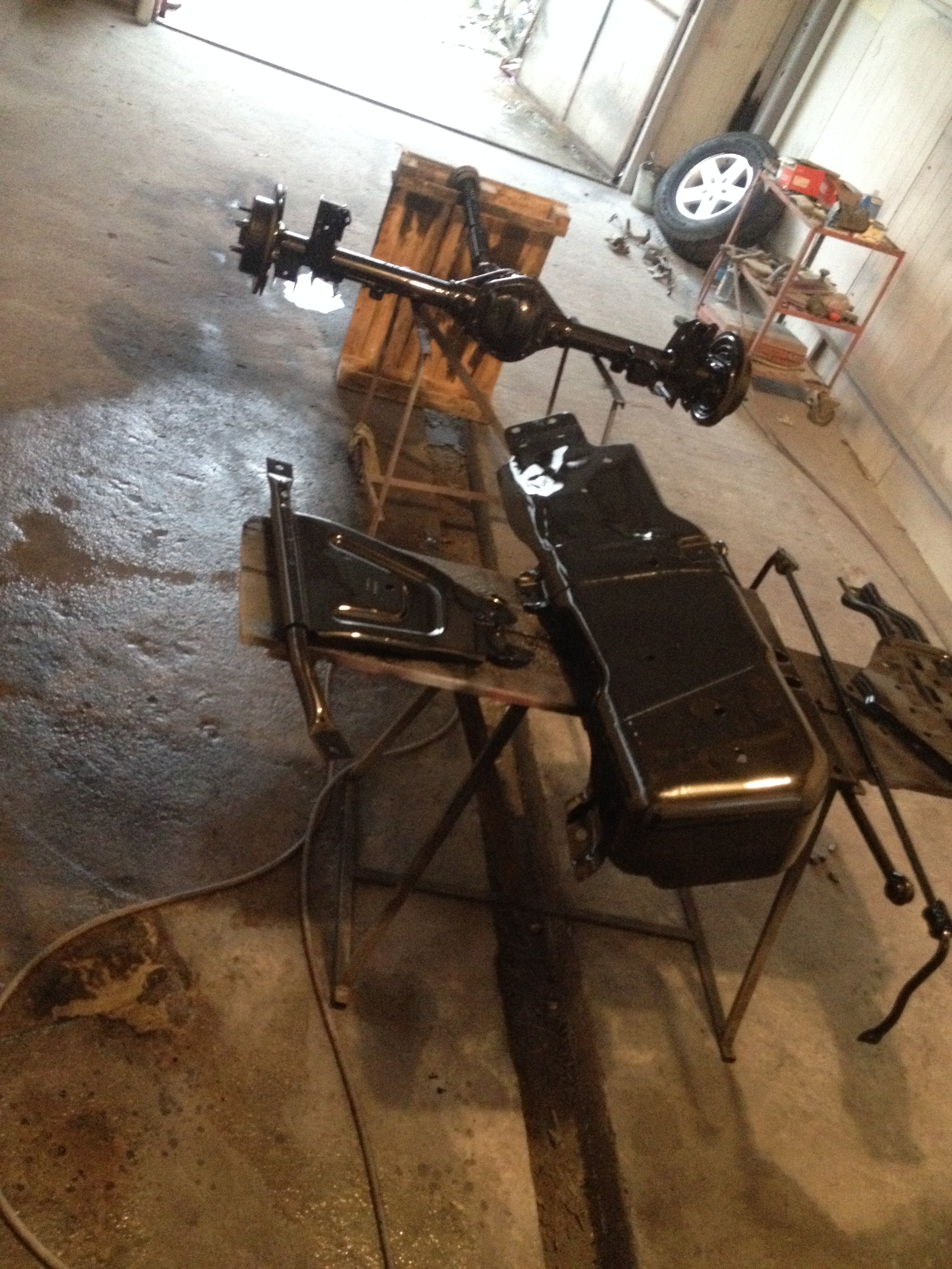

alin-jeep Posted October 15, 2014 Author Share Posted October 15, 2014 (edited) Re: Wrangler Rubicon -upgrade Azi nu prea am avut chef de lucru asa ca nu am facut decat : -curatat si vopsit : caseta de directie ,scut rezervor ,scuturi ,puntea spate -remontat instalatia electrica -remontat conductele de frana -montat in sasiu motorul si cutia Edited October 15, 2014 by alin-jeep Link to comment Share on other sites More sharing options...

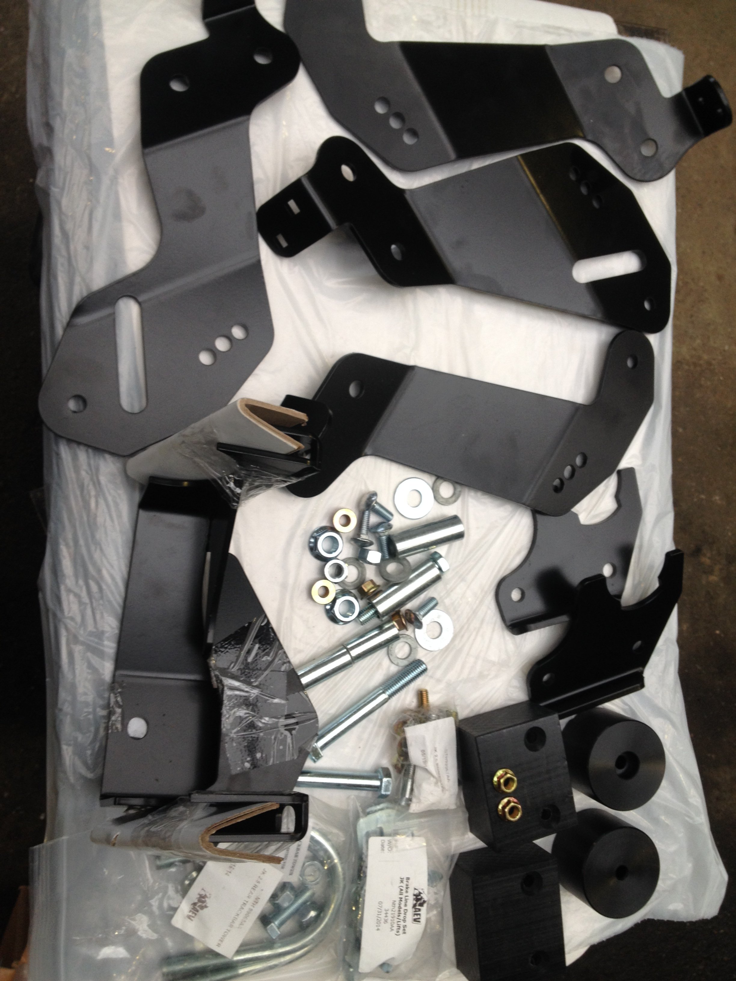

alin-jeep Posted October 15, 2014 Author Share Posted October 15, 2014 Re: Wrangler Rubicon -upgrade Relocari / AEV:grin: -Brake line drop set -Rear trackbar tower -Geometry correction front control arm -Plate stab end link Link to comment Share on other sites More sharing options...

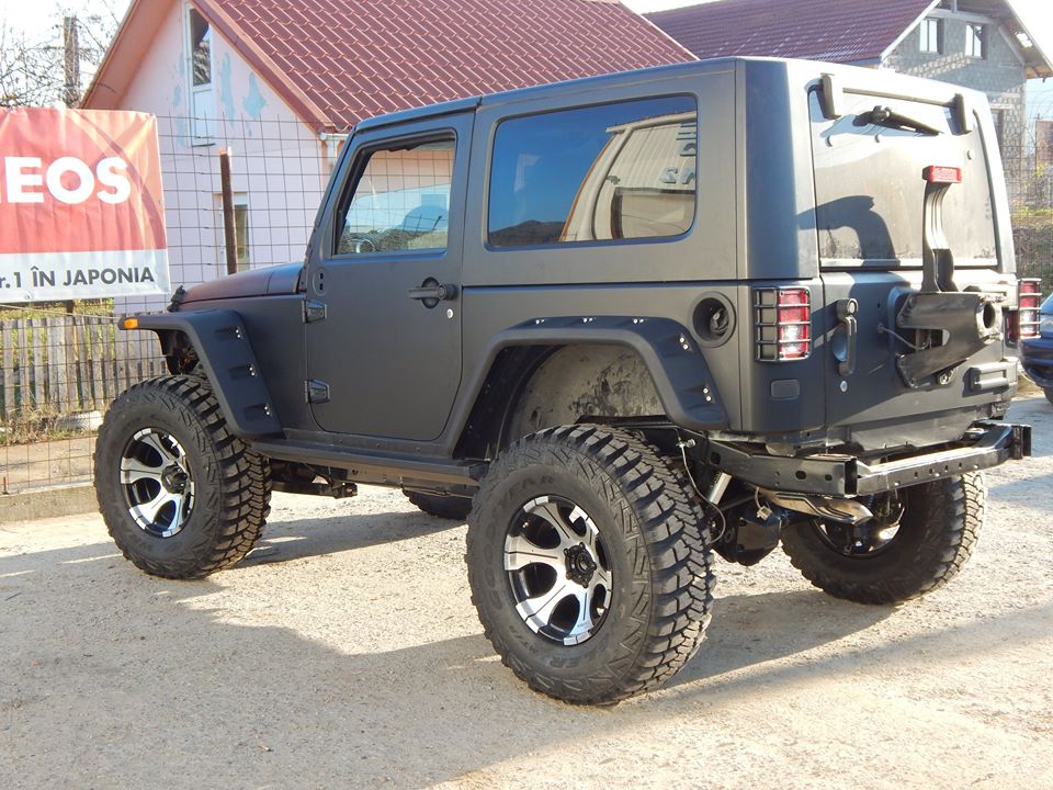

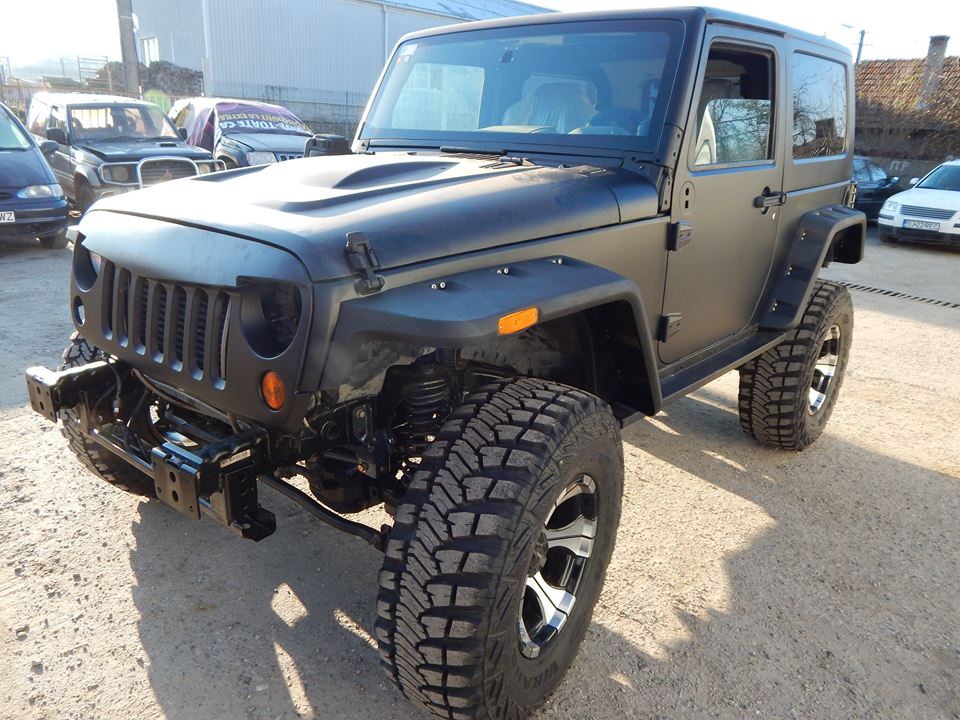

alin-jeep Posted December 8, 2014 Author Share Posted December 8, 2014 Re: Wrangler Rubicon -upgrade Culoarea este negru dar de la lacul foarte mat pare a fi gri . Link to comment Share on other sites More sharing options...
ElSpa Posted December 9, 2014 Share Posted December 9, 2014 Re: Wrangler Rubicon -upgrade aripile sunt bushwacker ? sunt mai late decat stoc ? Link to comment Share on other sites More sharing options...
alin-jeep Posted December 10, 2014 Author Share Posted December 10, 2014 Re: Wrangler Rubicon -upgrade aripile sunt bushwacker ? sunt mai late decat stoc ? Sunt produse de Rugged Ridge si se numesc ,,Hurricane" Sunt mai late decat cele de fabrica. Mai multe detalii ne poate da @Worldscape & Co :grin: :h5 Link to comment Share on other sites More sharing options...

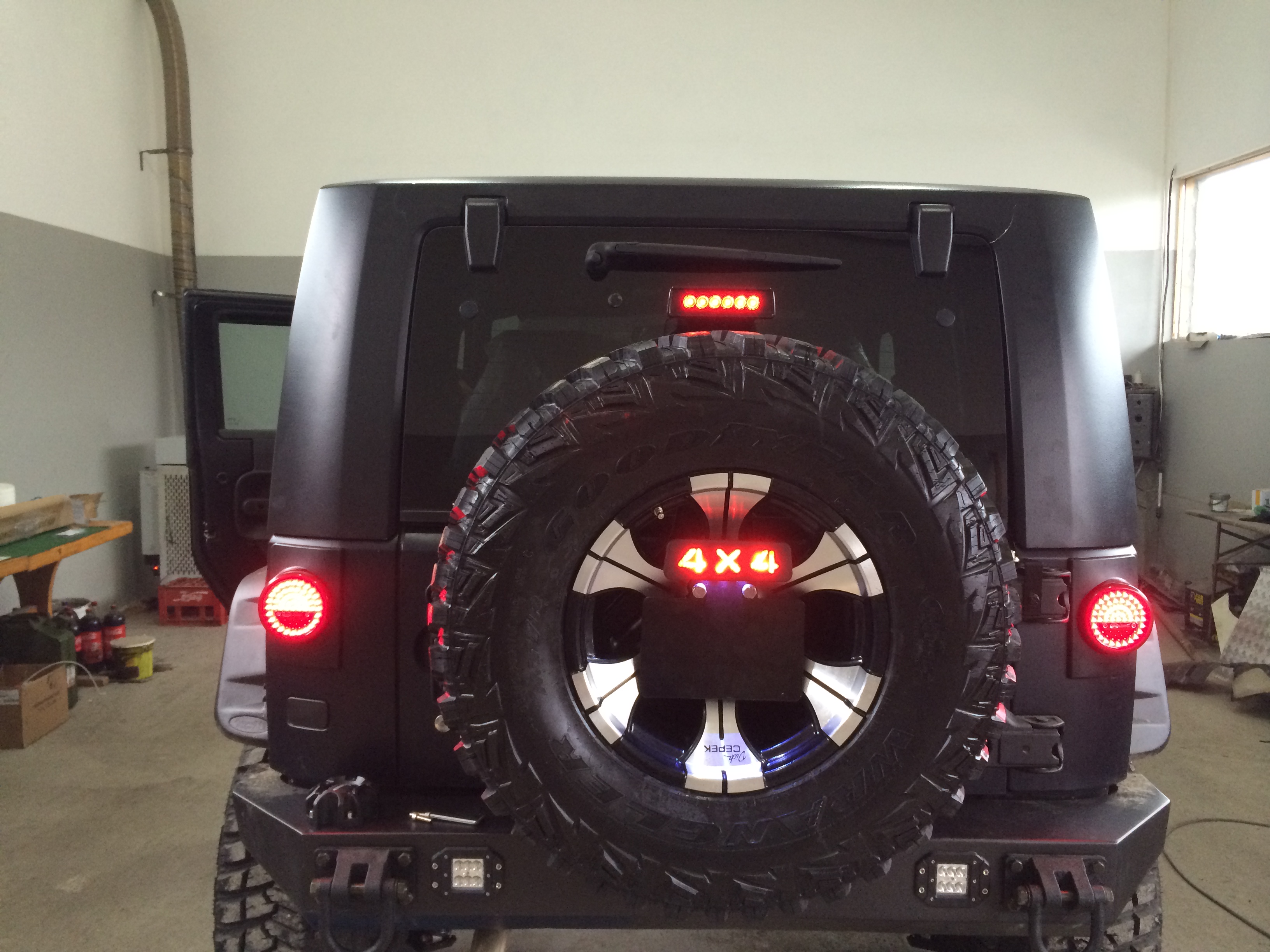

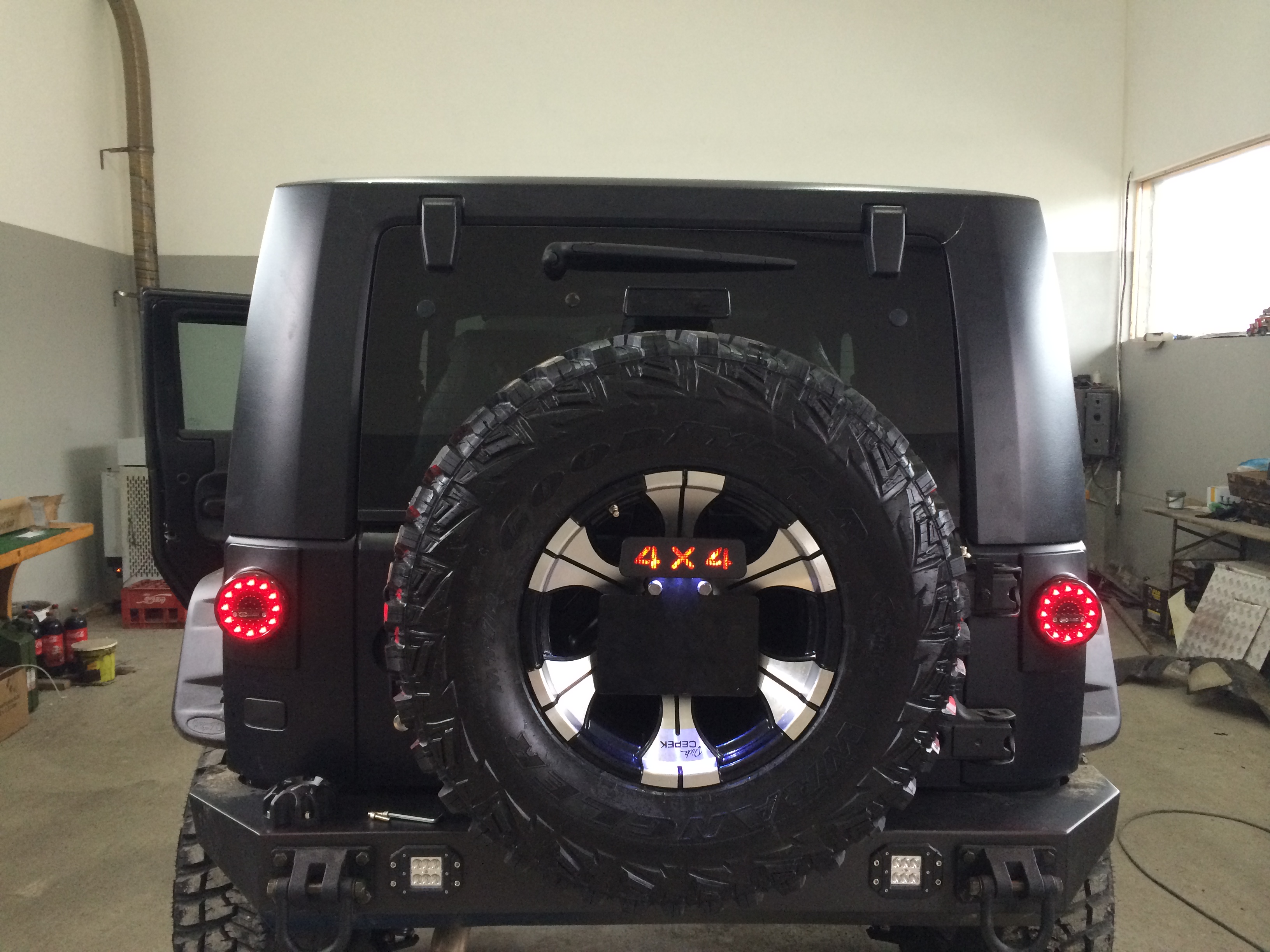

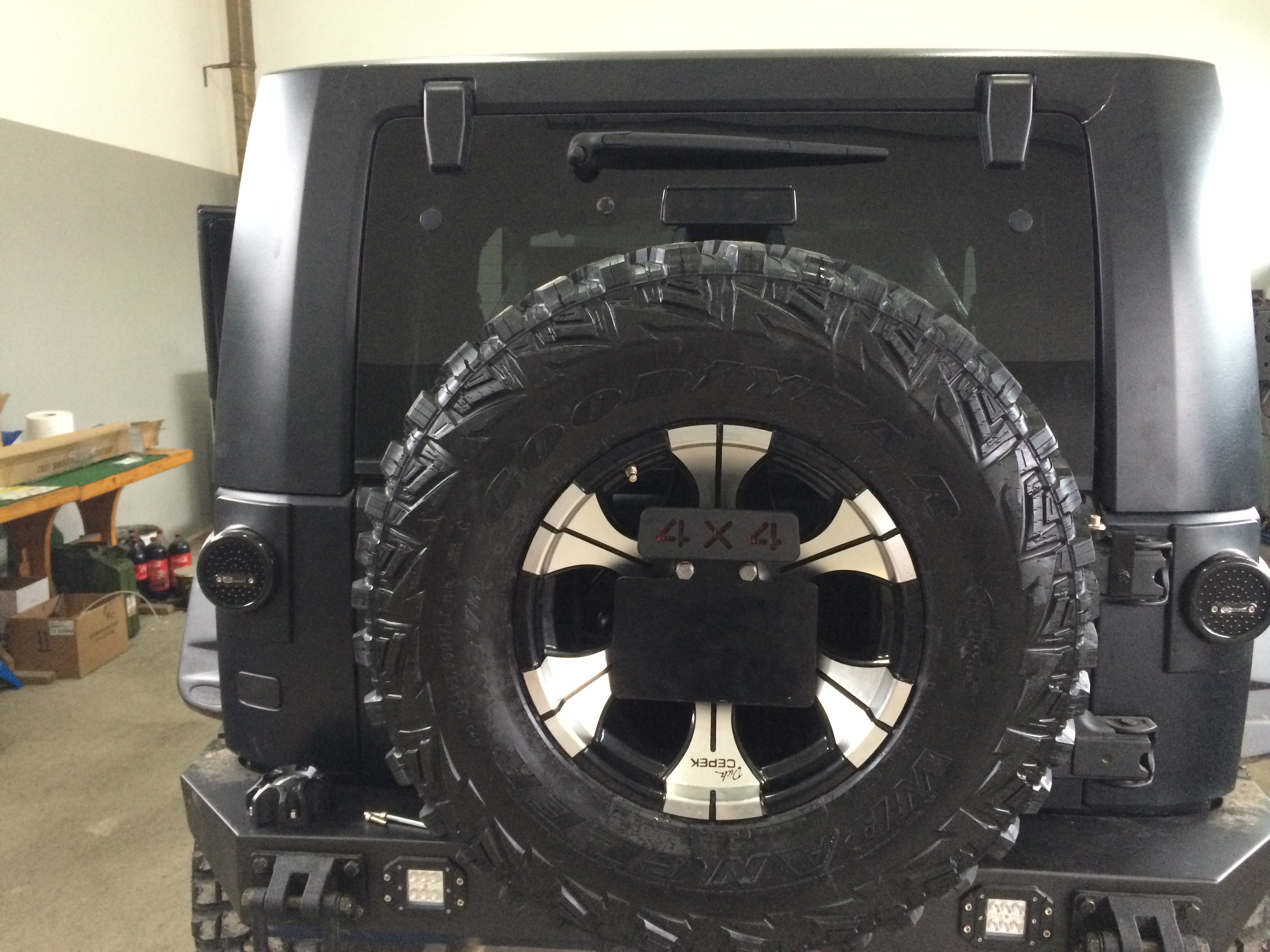

luk4x4 Posted January 23, 2015 Share Posted January 23, 2015 Re: Wrangler Rubicon -upgrade Astazi am terminat cu luminile pe spate . Link to comment Share on other sites More sharing options...
hdragos Posted January 23, 2015 Share Posted January 23, 2015 Re: Wrangler Rubicon -upgrade Buna treaba,iti vine usor sa dai jos suportul de numar ca sa dai jos roata? Mergea si ceva poze de la sistemul de prindere al suportului de numar,sau astepti sa patentezi brevetu si pe urma? Stopurile rotunde sunt de mare efect. Daca stau noaptea in spatele tau ma induci in eroare/teroare ca nu mai recunosc un Wrangler. Sunt modest din fire,toti au gipane,eu am doar JEEP Link to comment Share on other sites More sharing options...
