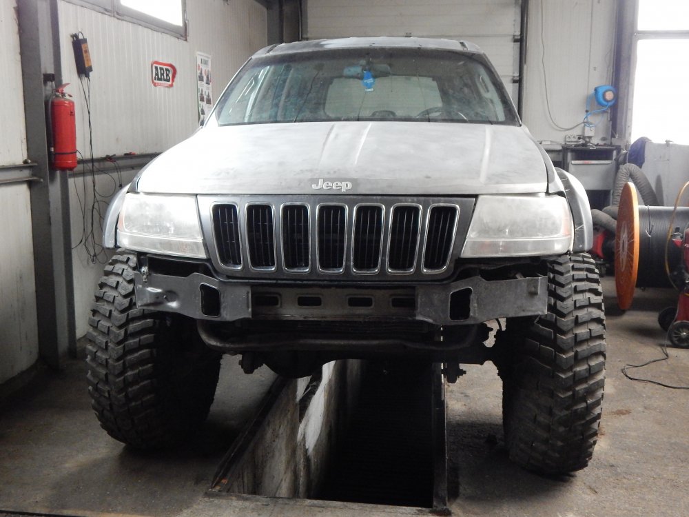

alin-jeep Posted December 26, 2014 Author Share Posted December 26, 2014 Re: Wg-ul meu Masina are montate puntile ,cutia de viteze mecanica cu 6 trepte ,motorul porneste . -Am renuntal la locasul rotii de rezerva in primul rand ca este inutil in cazul rotilor actuale si in plus am ridicat rezervorul de combustibil foarte mult si nu va mai atinge . Urmeaza sa montez cutia de transfer dar trebuie sa construiesc cuplajul dintre ele ,timoneria ,cardane ,fenderele ,bari fata spate ,vopsire Revin cu pozele :h5 Link to comment Share on other sites More sharing options...

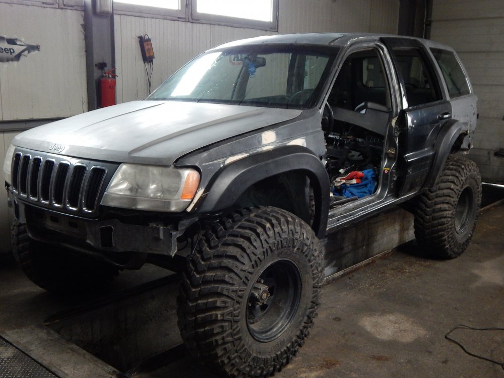

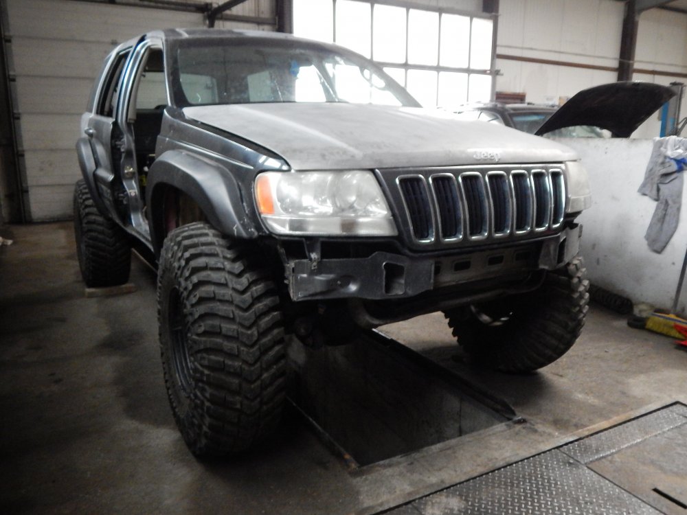

alin-jeep Posted January 11, 2015 Author Share Posted January 11, 2015 Re: Wg-ul meu Starea actuala : :h5 Link to comment Share on other sites More sharing options...
szabo laszlo Posted January 11, 2015 Share Posted January 11, 2015 Re: Wg-ul meu OMG! Deci la asta lucrezu tu...Arata bestial si cred ca va merge si mai bestial :)....Oare cind e gata o sa fie de vinzare? Littlesoky Link to comment Share on other sites More sharing options...
alin-jeep Posted January 11, 2015 Author Share Posted January 11, 2015 Re: Wg-ul meu La pretul corect DAAAAAAAAAAAAA :h5 Link to comment Share on other sites More sharing options...
Eddie Posted January 11, 2015 Share Posted January 11, 2015 Re: Wg-ul meu Salut Aline Pana aici sigur ne faci sa vrem si noi asa :). Felicitari, capata forma...monstruoasa fata de original. Gaura din traversa dintre lonjeroane va face loc unui troliu ? E o idee la care aspir si eu dar se pare ca vei batatori calea inainte. Daca e asa, cum vezi rezistenta la impact frontal sau pe verticala, deformarea lonjeroanelor nu e oare ajutata de solutia asta? Traversa originala are nervuri de absorbtie a impactului, troliul nu va avea... Frumoasa masina, fain rezultat pana acum. Felicitari Jeep Grand Cherokee Overland 2004 - OME +4cm+1cm distantier, BFG AT, Jante Goss ET+10, Addco SwayBar spate, JKS Quick Disconnects fata Link to comment Share on other sites More sharing options...
