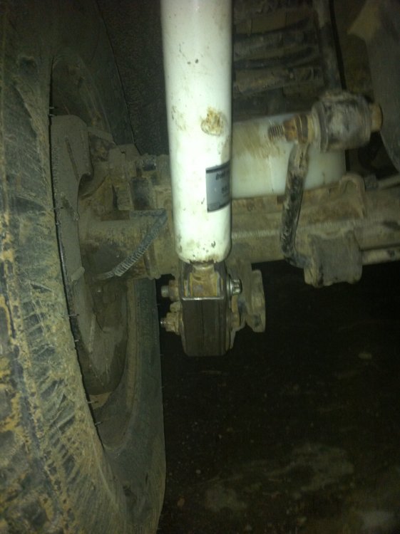

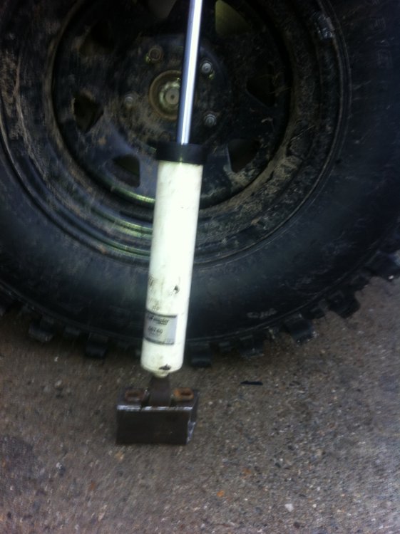

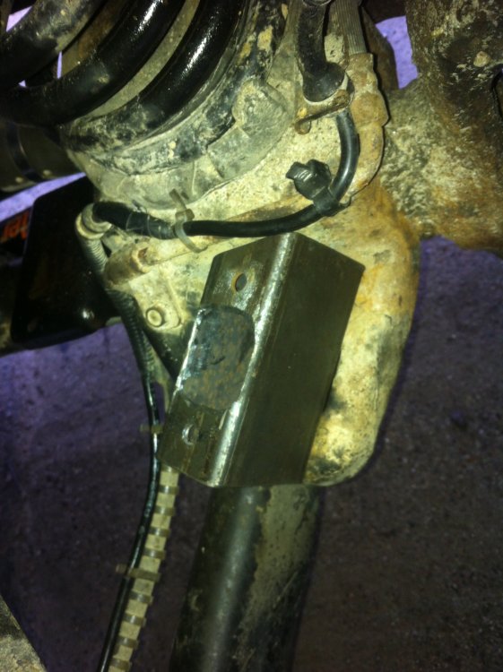

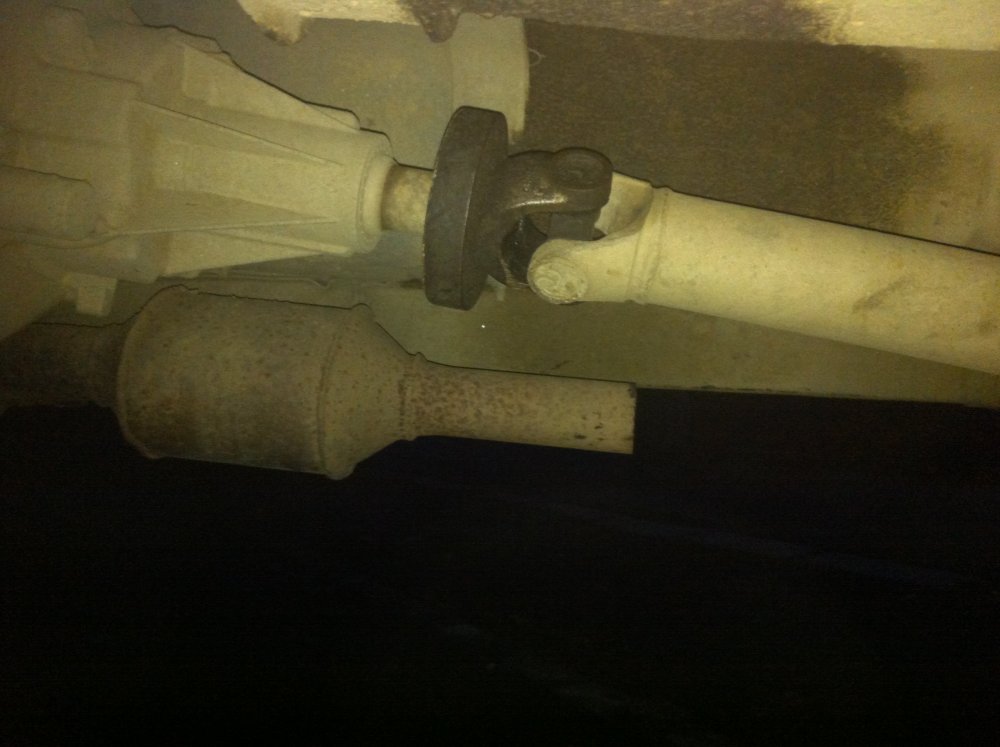

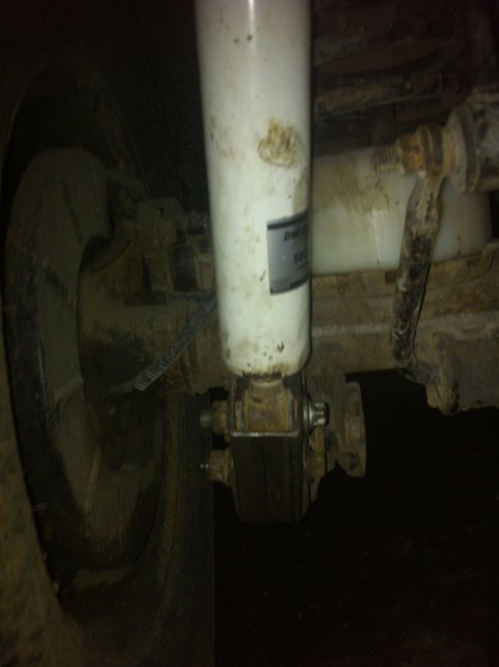

Viorel Cretu Posted January 22, 2015 Author Share Posted January 22, 2015 (edited) Re: Jeep WJ - transformare... Astazi am confectionat prelungitoare de 50 mm pt telescoapele spate si am executat un ''tuning'' esapamentului,cu flexul bineinteles...am eliminat totul dupa ultimul catalizator...suna a V8 acum:wink:[ATTACH=CONFIG]235023[/ATTACH] Edited January 23, 2015 by Viorel Cretu " Nu mai lua viata asa in serios - la urma urmei, oricum nu scapi viu din ea !!! " Link to comment Share on other sites More sharing options...
Viorel Cretu Posted January 29, 2015 Author Share Posted January 29, 2015 Re: Jeep WJ - transformare... Asemanator am confectionat inaltatoare si pt telescoapele fata, dupa ce unul stock a cedat in padure dupa ce a suferit prea multe 'alungiri peste limita':grin: " Nu mai lua viata asa in serios - la urma urmei, oricum nu scapi viu din ea !!! " Link to comment Share on other sites More sharing options...
savagex Posted January 30, 2015 Share Posted January 30, 2015 Re: Jeep WJ - transformare... ....am executat un ''tuning'' esapamentului,cu flexul bineinteles...am eliminat totul dupa ultimul catalizator...suna a V8 acum:wink:[ATTACH=CONFIG]235025[/ATTACH][ATTACH=CONFIG]235024[/ATTACH][ATTACH=CONFIG]235023[/ATTACH][ATTACH=CONFIG]235022[/ATTACH] Cu asta se incepe la o asa masina! In teren catalizatorul are prostul obicei de a se lasa in jos, trebuie asigurat cumva! Subaru justy 1,3 4x4 Link to comment Share on other sites More sharing options...
Viorel Cretu Posted January 30, 2015 Author Share Posted January 30, 2015 Re: Jeep WJ - transformare... Catalizatorul e foarte bine asigurat dar nu se vede in poza. Nu joaca in jos deloc. Oricum e foarte posibil sa tai si catalizatorul si sa atasez o toba de motocicleta. Acum e zgomotoasa rau. Cand o pornesc in parcare, porneste si alarma masinii unui vecin :wink:... " Nu mai lua viata asa in serios - la urma urmei, oricum nu scapi viu din ea !!! " Link to comment Share on other sites More sharing options...
savagex Posted February 3, 2015 Share Posted February 3, 2015 Re: Jeep WJ - transformare... Stiu cum e....eu am ramas in plina zi cu un 5.9 si fara catalizator prin Cluj....razboi nu alta, nu exista om sa nu se uite la mine. Asta tot 2 sonde lambda are?...ala avea una inainte de catalizator si una dupa. Subaru justy 1,3 4x4 Link to comment Share on other sites More sharing options...

Viorel Cretu Posted February 19, 2015 Author Share Posted February 19, 2015 Re: Jeep WJ - transformare... @savagex Motorul 4.7 este V8 si are doua sonde stanga+dreapta imediat dupa iesirea galeriilor de evacuare, urmeaza catalizatoarele mici, doua sonde st+dr dupa cele doua, apoi tobele se unesc intr-una, catalizatorul mare, teava, toba finala si iesirea. @Ioncii Multumesc de aprecieri! Am decis sa nu ma opresc aici cu inaltarea si deja am achizitionat foarte avantajos de la @Roly telescoape noi pt fata +3"" de la Rancho USA, cu actiune neutra pe care le voi monta peste inaltatoarele mele de 2" si urmeaza telescoape +3'' pe spate si arcuri +2'' pe care deasemenea le voi monta impreuna cu flansele distantiere din poliamida de 70 mm, rezultandu-mi in final un lift de +5". Am achizitionat (tot de la Roly) bump-stopere fata+spate si chitul de coborare al cutiei de transfer. Mai ramane de ridicat bratul A al puntii spate, tendoane reglabile, trackbarr reglabil fata si mai mult ca sigur un cardan fata cu cruce dubla. Mai sunt de bagat bani...:grin: " Nu mai lua viata asa in serios - la urma urmei, oricum nu scapi viu din ea !!! " Link to comment Share on other sites More sharing options...
