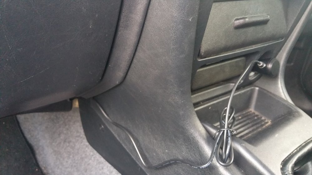

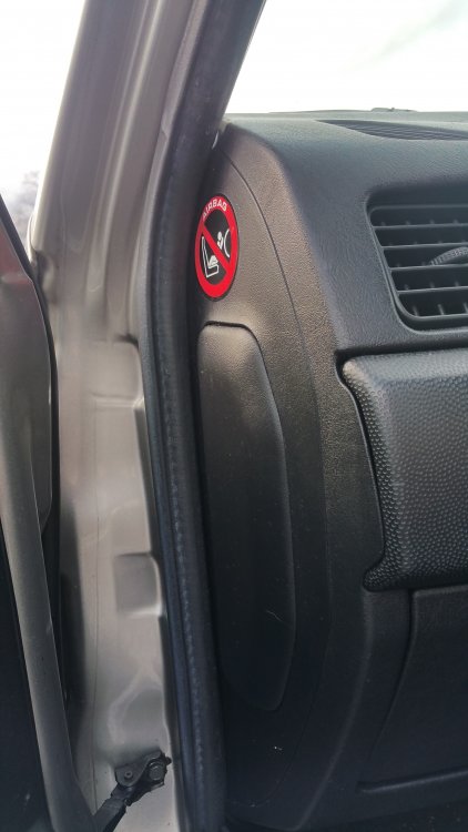

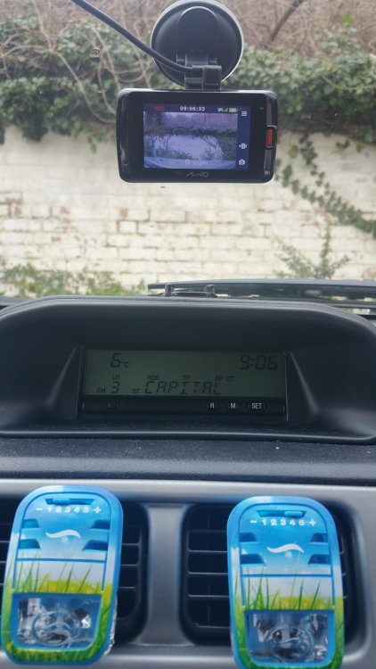

plummer Posted March 12, 2018 Author Share Posted March 12, 2018 (edited) Re: Shogun Pinin a.k.a. "Pufarinã" Update: Firul de alimentare de la camera e destul de lung ca sa se mascheze pe sub plafon, apoi pe sub chederul de langa usa si pe sub bord. E o operatiune de 10 minute maxim. Include 1 surubelnita mica, un imbus cat mai subtire posibil pentru a impinge firul sub masca de plastic de la pasager si apoi in spatele chederului. Am incercat cu 2 surubelnite la inceput dar se zgarie plasticul daca nu esti atent. Asa ca am schimbat cu imbusul care face minuni :banana Cateva foto edificatoare: Si un filmulet cu toata lucrarea: Edited March 12, 2018 by plummer ~ Silence is a gift ~ ~ Learn to value its essence ~ Link to comment Share on other sites More sharing options...

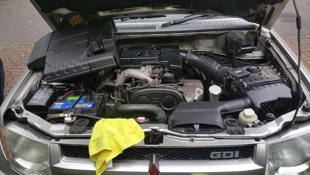

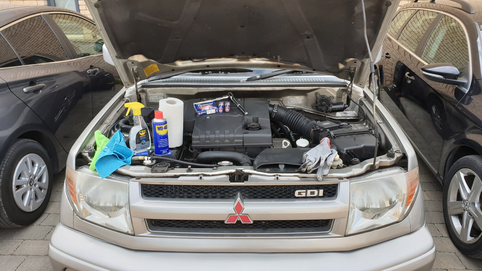

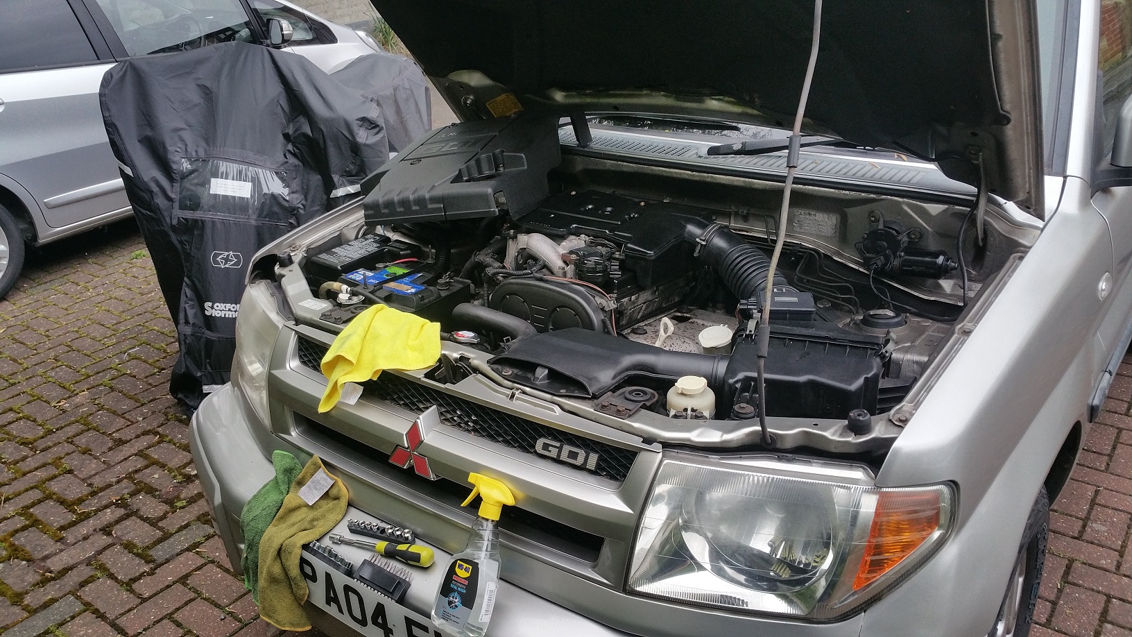

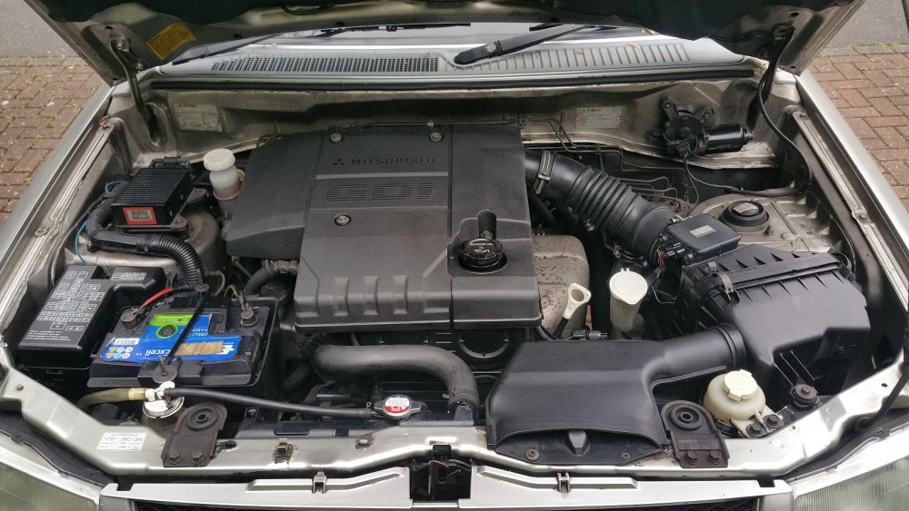

plummer Posted April 29, 2018 Author Share Posted April 29, 2018 Re: Shogun Pinin a.k.a. "Pufarinã" Azi am profitat de timpul liber si am curatat compartimentul motor de praf si panza de paianjen. Acum are aspect mai civilizat :grin: :dr2 ~ Silence is a gift ~ ~ Learn to value its essence ~ Link to comment Share on other sites More sharing options...

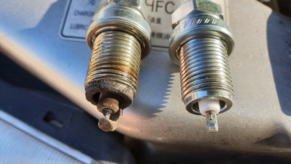

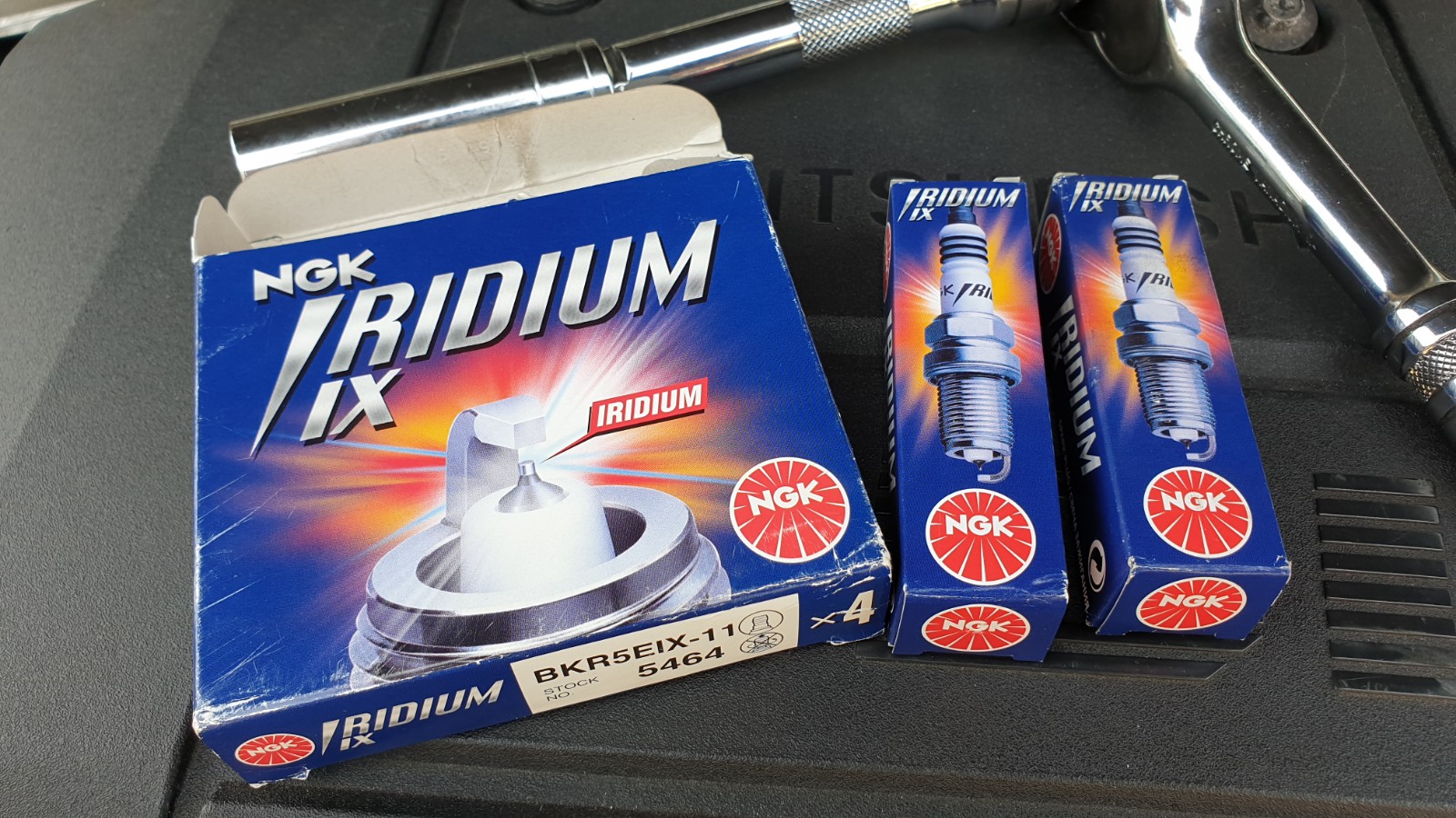

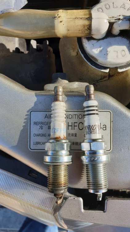

plummer Posted September 22, 2018 Author Share Posted September 22, 2018 Re: Shogun Pinin a.k.a. "Pufarinã" Am schimbat bujiile weekend-ul trecut. De cand cu noul fratior, merge foarte bine ca masina de weekend si nu numai :j [ATTACH=CONFIG]290332[/ATTACH] [ATTACH=CONFIG]290337[/ATTACH] [ATTACH=CONFIG]290338[/ATTACH] :h5 ~ Silence is a gift ~ ~ Learn to value its essence ~ Link to comment Share on other sites More sharing options...
