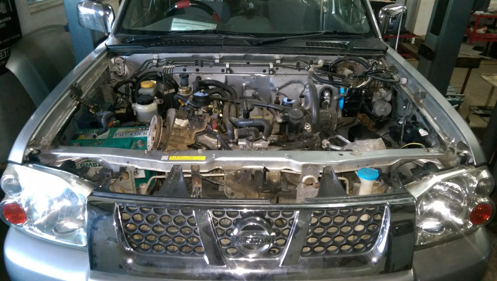

ovidiua-car Posted March 25, 2015 Share Posted March 25, 2015 Pentru ca foarte multi posesori de Navara D22 au intampinat probleme la motor,am trecut la conversia de motor....de la Terrano II in D22. Motorul de Terrano etse foarte fiabil,ca si putere este aproape identic cu cel de Navara(D22-133Cp,iar R20 130 CP). Totul functioneaza perfect!!!!!! Am facut minim 10 conversi.......si toata lumea multumita.Costurile sunt oarecum identice cu achizitia unui motor sh de D22.....care tot se va strica..... 2 Link to comment Share on other sites More sharing options...

ccristi27 Posted March 26, 2015 Share Posted March 26, 2015 Re: Conversie motor la Navara D22 Pentru ca ne-am indepartat de la subiectul topicului pun si eu o intrebare, Ce modificari se fac pt a introduce motorul de Terrano? Banuiesc ca are alte prinderi de sasiu, conducte si alte chestii diferite de motorul original RD22? Multumesc "Good goods are never cheap / Cheap goods are never good" Link to comment Share on other sites More sharing options...
ovidiua-car Posted March 26, 2015 Author Share Posted March 26, 2015 Re: Conversie motor la Navara D22 Motor +cutie+calculator+tampoane +parte din cablaj motor.......etc,dar merita...sau cel puțin așa susțin cei care au trecut de la YD25 la TD27T 1 Link to comment Share on other sites More sharing options...
