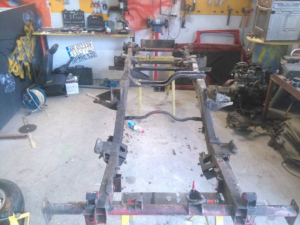

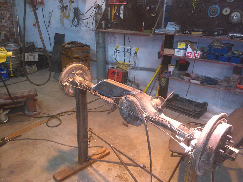

astazi m-am apucat de puntea spate
11201609_891977077543522_6070061228600880075_n.jpg.e392019e776d252018cc419efee3a799.jpg11863392_891977004210196_7275303441947431169_n.jpg.c1a97c61432bea8bfe8abe6ffec63fd5.jpg11873526_891976917543538_905307160213999346_n.jpg.b2eec31e8f96da1981d422d70e11c01f.jpg11891225_891976960876867_6468278857016327082_n.jpg.0045d1b5ded487c48b0f2458892092a1.jpg11891997_891977130876850_5069090204982361887_n.thumb.jpg.d634095058f8d28e0121ad1d05bcd33f.jpg11895968_891977227543507_1191543815474144028_n.jpg.34cf3987b640481e1220433d7eb21a4d.jpg11899971_891977097543520_3694413036415205662_n.jpg.cb9d559f5ea2599c909b834a53450e38.jpg11900049_891977034210193_7018060339314925960_n.jpg.f4b4b80420398d5e15af40dfeb4b67b6.jpg

Re: Conversie la elicoidale ?
Povestea mea cu unibalu' - la inceput au fost ok , apoi in cateva luni au au batut putin , aproape suportabil ... si dupa ceva ani s-a mentinut trancaneala desi masina nu se balangane pe suspensii in nici un fel ci se balangane doar din anvelope .
Dupa gresare , pret de cinci minute este liniste , apoi iar troncane ....
Le voi inlocui cu bucse de cauciuc OE , care sunt hiflex ( nu sunt pline ca la dacie ) .

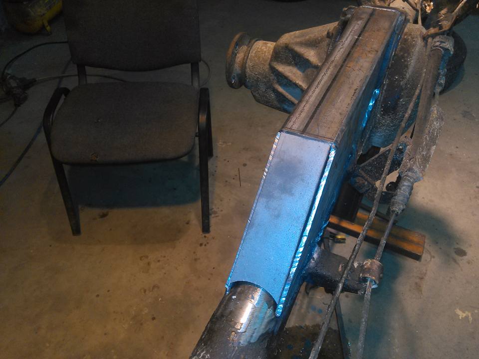

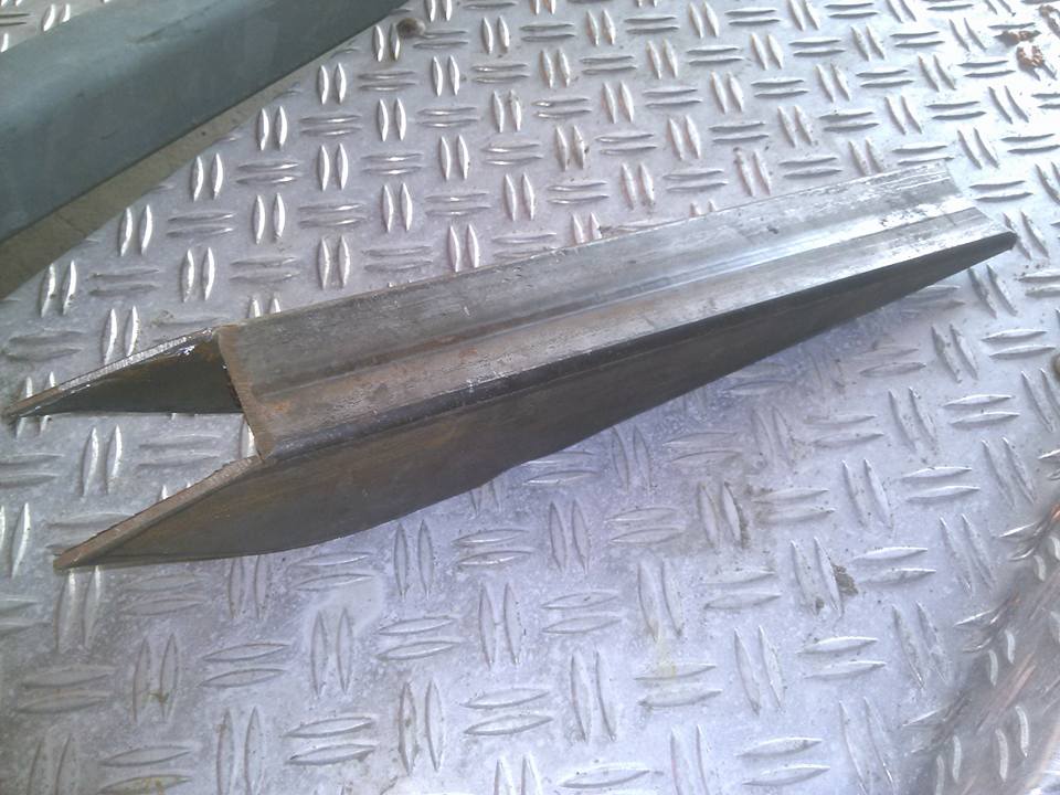

si daa tot am zis de ramforsat puntea...iaca am facut-o !
10984622_892883987452831_3914250863565774914_n.jpg.7c5f4969e7f2deb9321311d21b4cc6dd.jpg11144444_892884070786156_5535232960052431786_n.jpg.0557b53332bc70cf28d58efe2e859ae5.jpg11866250_892883507452879_198464372591279600_n.jpg.079f8847c2cefcc2c17911ce044120f0.jpg11889452_892884207452809_4225549754646134072_n.thumb.jpg.09d685ed57c4e70913a5696f4ebc58bb.jpg11889612_892884014119495_5225913670841750012_n.jpg.ea476602cf7efe922640169fb968fadc.jpg11899859_892884040786159_520696915987899948_n.jpg.0eb70072fb33b537d258127c12e8741e.jpg11903734_892883964119500_6648393850932907057_n.jpg.410195bd3b0c612e4749487aae4592b2.jpg
buna treaba ca idee, doar ca ai facut-o cam inalta. o sa loveasca baia motorului in ea.
sper sa se inalte destul cat sa nu loveasca....daca nu o mai cofetaresc, bag plasma in functie :)
