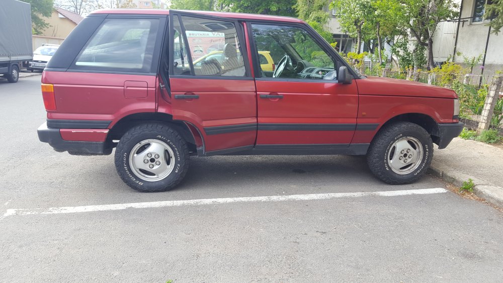

bebe99 Posted April 17, 2019 Author Share Posted April 17, 2019 Am reusit sa fac o poza acaretului. Link to comment Share on other sites More sharing options...

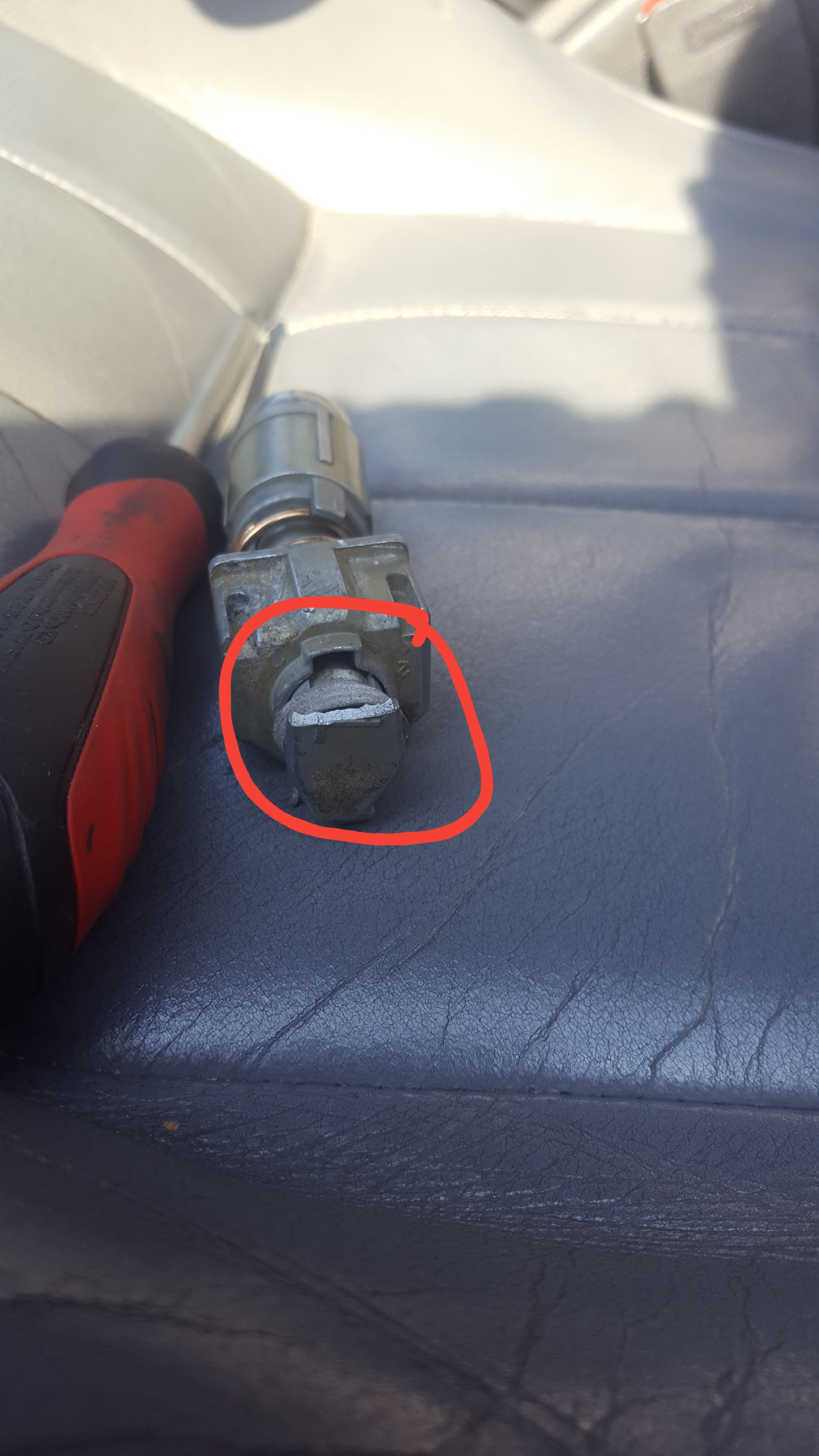

bebe99 Posted April 17, 2019 Author Share Posted April 17, 2019 Anvelopele sunt pe drum, dar s-a rupt, la propriu butucul din usa. Asa ca, acum, stau cu masina deschisa. Am gasit butuci la dezmembrari, dar doar pentru partea dreapta sau cu urechile rupte. Am cautat noi, dar toate magazinele sunt stoc zero la acel reper. Link to comment Share on other sites More sharing options...
sierrafery Posted April 17, 2019 Share Posted April 17, 2019 Care reper s-a rupt? daca zici "butuc" si trebuie sa stai cu masina deschisa sa inteleg ca nu ai telecomanda? NU RASPUND USERILOR CU PROFIL INCOMPLET LA MASINA(model, an, motor, transmisie), NU RASPUND PE PM LA PROBLEME TEHNICE SAU DE INTERES GENERAL Discovery Td5 ES , "00. manual, ECU tunat, intercooler marit...merge de rupe Link to comment Share on other sites More sharing options...

bebe99 Posted April 17, 2019 Author Share Posted April 17, 2019 Asta s-a rupt, si butucul in trei bucati Link to comment Share on other sites More sharing options...

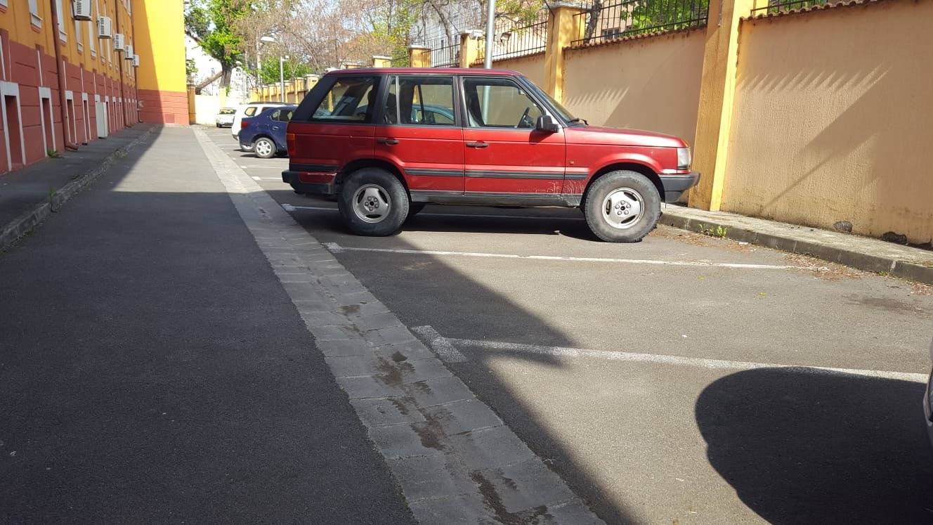

bebe99 Posted April 18, 2019 Author Share Posted April 18, 2019 Incaltari noi si potrivite! Link to comment Share on other sites More sharing options...
