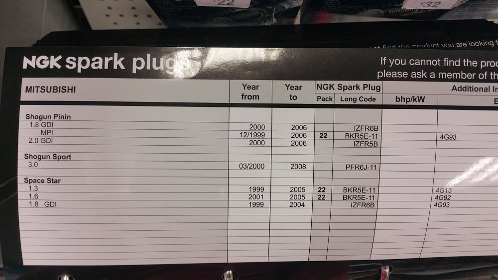

plummer Posted March 12, 2018 Share Posted March 12, 2018 Re: Mitsubishi Pinin clapeta de acceleratie-rezolvare Uite si o poza cu codurile ca sa compari cu ce ai cumparat :h5 ~ Silence is a gift ~ ~ Learn to value its essence ~ Link to comment Share on other sites More sharing options...
