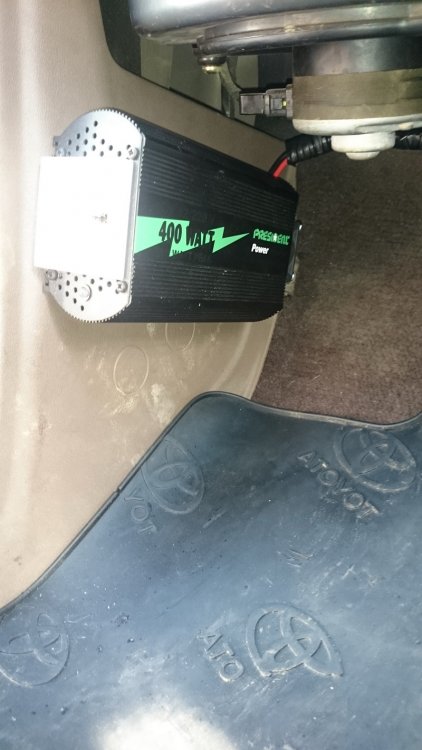

nessum Posted December 6, 2016 Share Posted December 6, 2016 Re: Invertor O chestie din asta mi-am pus pe masina, legata direct la baterie. Toyota LJ 70 Transsylvania Off Road Club www.helpdani.eu Link to comment Share on other sites More sharing options...
