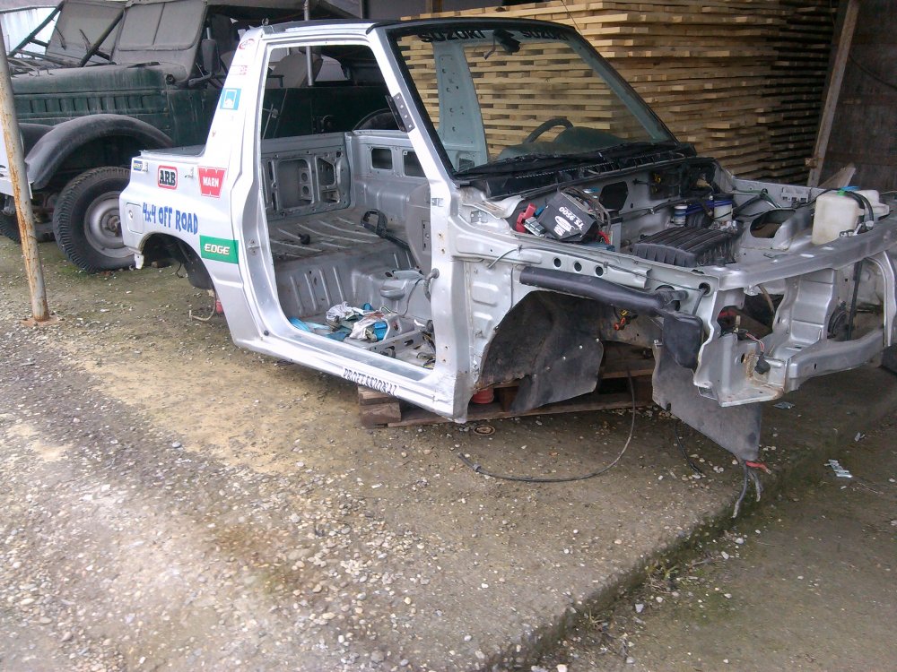

larry24 Posted February 28, 2014 Author Share Posted February 28, 2014 Re: suzuki vitara cu punti de nissan patrol asa arata pana sa ajunga la valcea http://forum.club4x4.ro/attachment.php?attachmentid=175086&d=1365http://forum.club4x4.ro/attachment.php?attachmentid=175084&d=1365751301&thumbhttp://forum.club4x4.ro/attachment.php?attachmentid=175084&d=1365751301&thumb=1=1751304&thumb=1 asa Link to comment Share on other sites More sharing options...

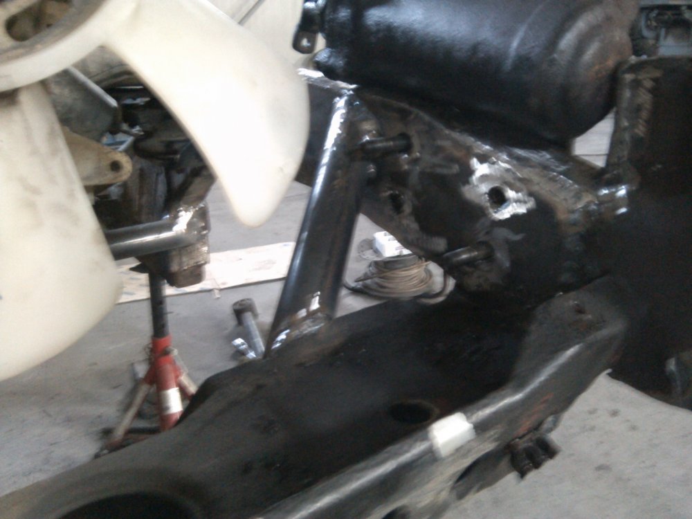

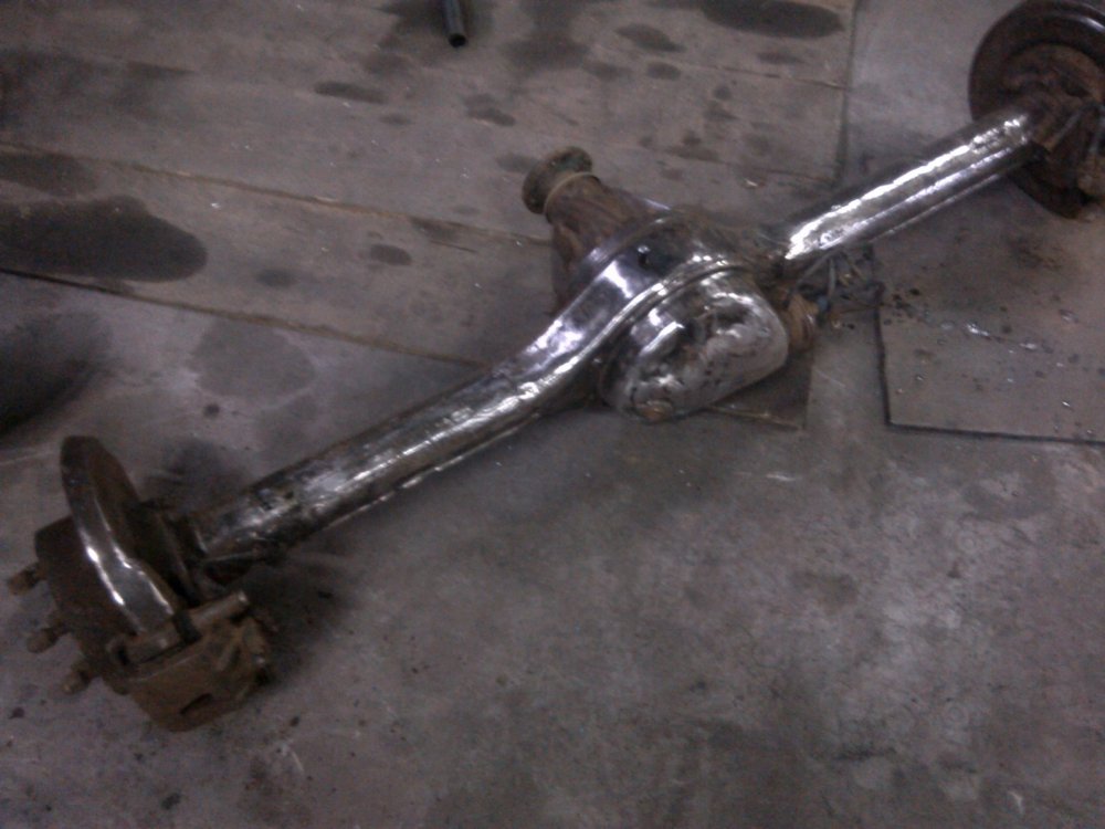

larry24 Posted March 5, 2014 Author Share Posted March 5, 2014 Re: suzuki vitara cu punti de nissan patrol rezultatul dupa o zi de munca Link to comment Share on other sites More sharing options...
alin-jeep Posted March 6, 2014 Share Posted March 6, 2014 Re: suzuki vitara cu punti de nissan patrol In sfarsit Schneider vrea masina ! Pana acum are punti si numere :grin: . Urmeaza :motor ,cutie ,reductor ,roti,suspensie,troliu... Ai grija sa nu micsorezi portbagajul ca sa incapa cantitatea de bere necesara :h5 Spor la treaba ! ALIN Link to comment Share on other sites More sharing options...
schneider Posted March 7, 2014 Share Posted March 7, 2014 (edited) Re: suzuki vitara cu punti de nissan patrol Spor avem,dar asteptam sa ajunga uniball-urile si coiloverele. Uniball-urile vin la inceputul saptamanii vitoare. Coiloverele...1-2 saptamani. Am confectionat placutele pentru montat tendoanele(linkurile).Urmeaza sa le sudeze Lari pe punti si pe sasiu. Edited March 7, 2014 by schneider Link to comment Share on other sites More sharing options...

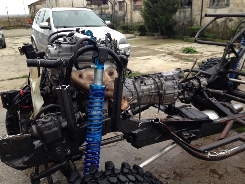

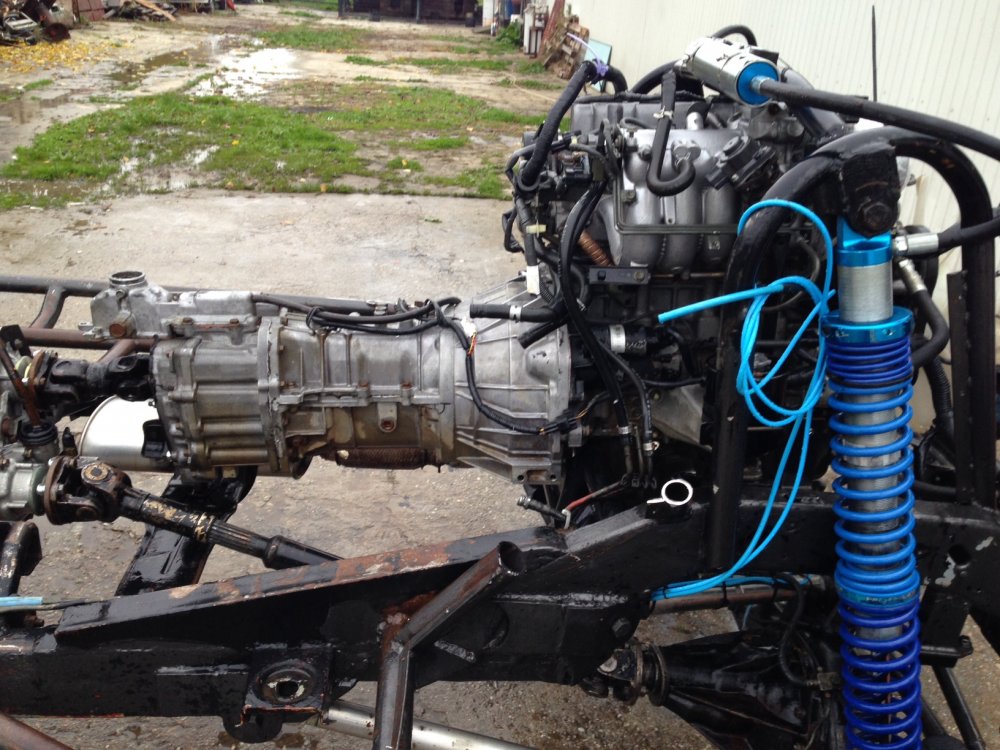

larry24 Posted March 13, 2014 Author Share Posted March 13, 2014 (edited) Re: suzuki vitara cu punti de nissan patrol avem caseta cu greutate si traversa care sa permita miscarea cardanului Edited March 13, 2014 by Astral Link to comment Share on other sites More sharing options...
