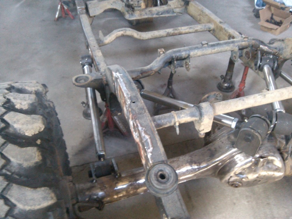

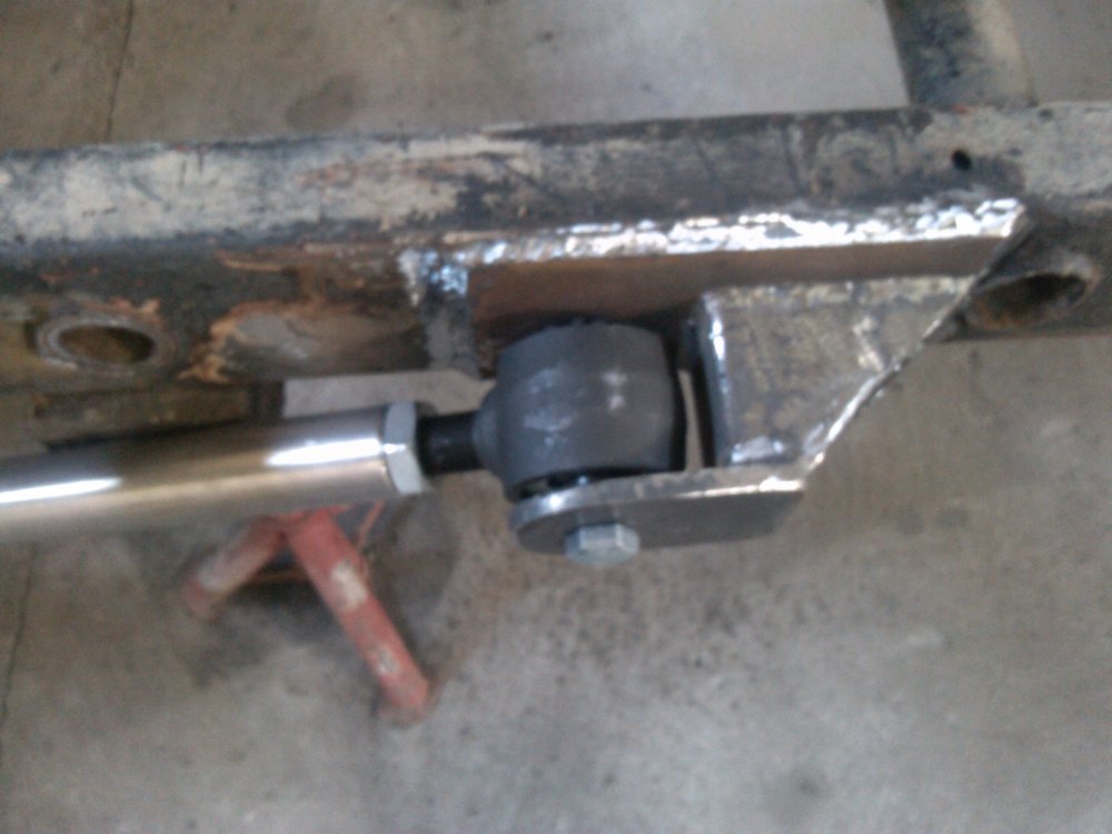

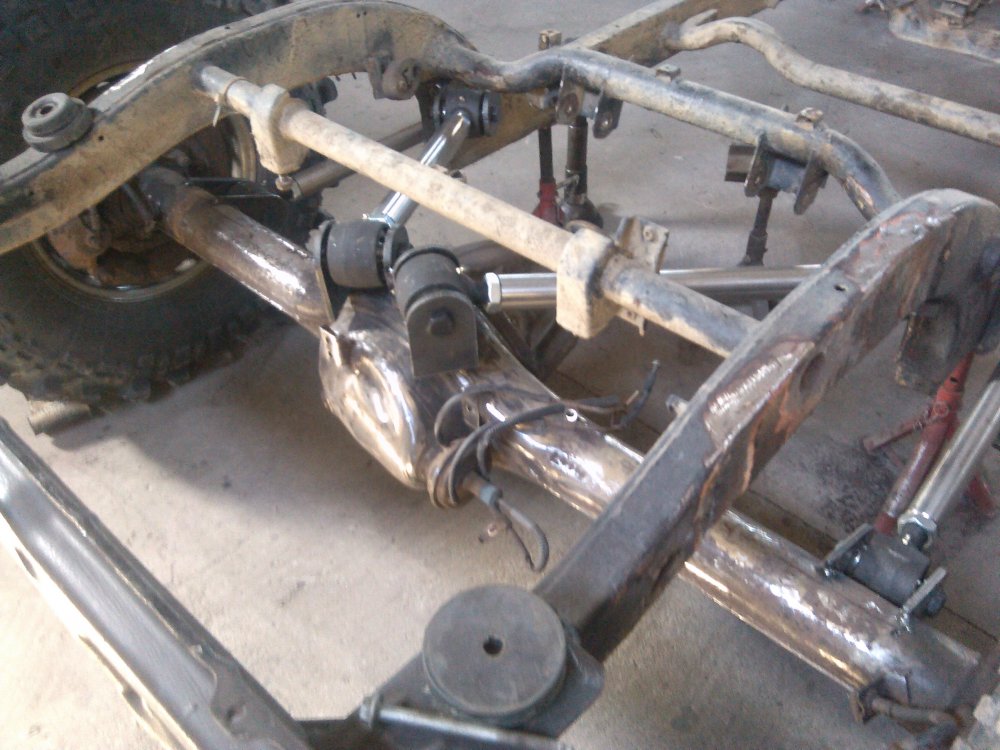

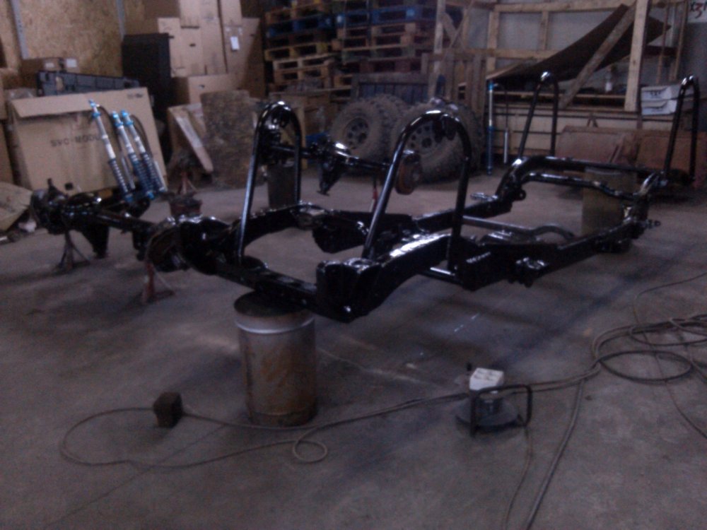

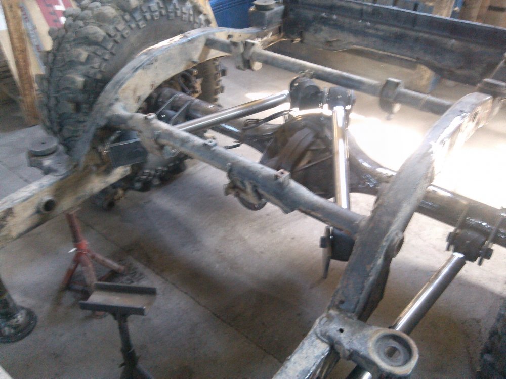

larry24 Posted March 22, 2014 Author Share Posted March 22, 2014 Re: suzuki vitara cu punti de nissan patrol sa punctat 4lincul spate Link to comment Share on other sites More sharing options...

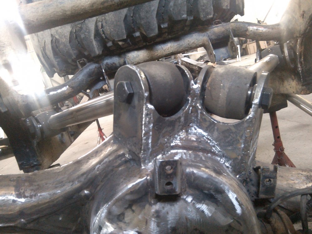

cfantana Posted March 23, 2014 Share Posted March 23, 2014 Re: suzuki vitara cu punti de nissan patrol Bratele superioare mi se par prea scurte in comparatie cu cele inferioare.Fa o simulare si vezi sa nu rasuceasca mult puntea. Offroad Racing Romania-THE ORIGINAL since 2006 KAMIKAZE TEAM Link to comment Share on other sites More sharing options...
cos Posted March 23, 2014 Share Posted March 23, 2014 Re: suzuki vitara cu punti de nissan patrol Pana la o limita in coborarea puntii e in regula , asa cum se vede . Odata trecut de limita aia , chiar o rasuceste prea mult , dar coborarea limita e greu de atins , probabil nu se ajunge atat de jos . ... sa fim corecti pana la capat ! Nu cere nimeni sa fii impecabil si un fel de varf de gama , doar corect e destul ! Link to comment Share on other sites More sharing options...

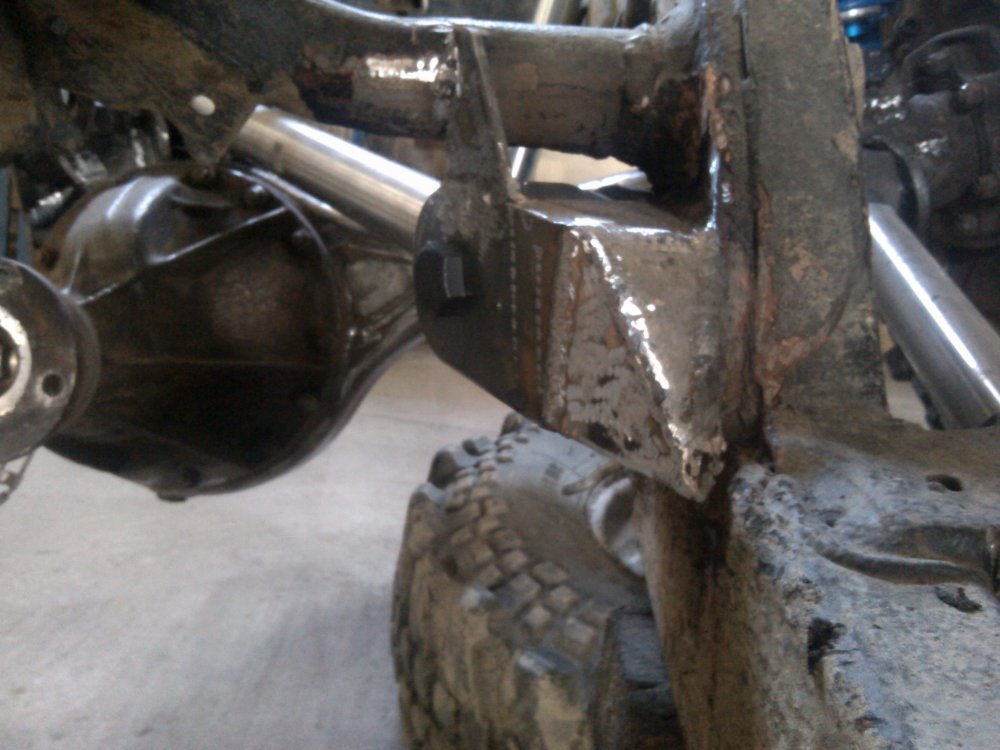

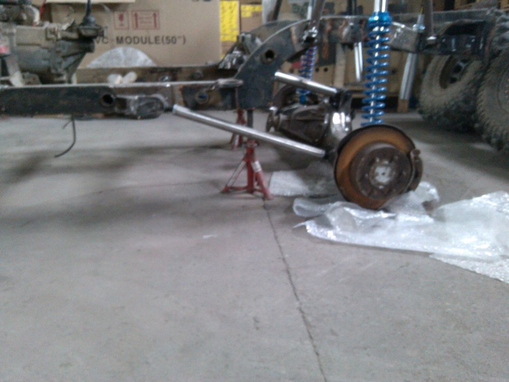

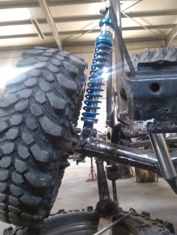

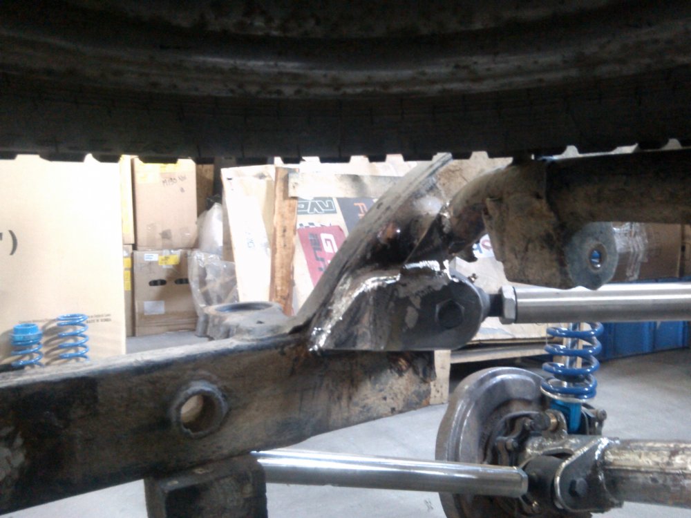

larry24 Posted April 7, 2014 Author Share Posted April 7, 2014 Re: suzuki vitara cu punti de nissan patrol asa arata unghiul grupului cand puntea e lasata la maxim Link to comment Share on other sites More sharing options...

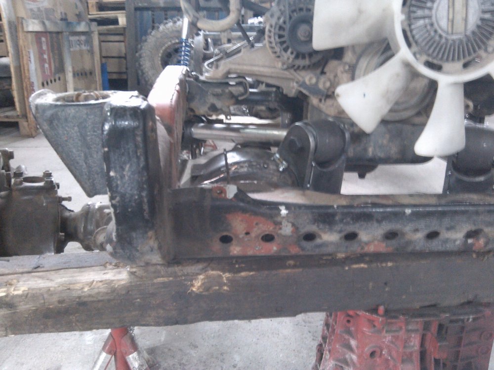

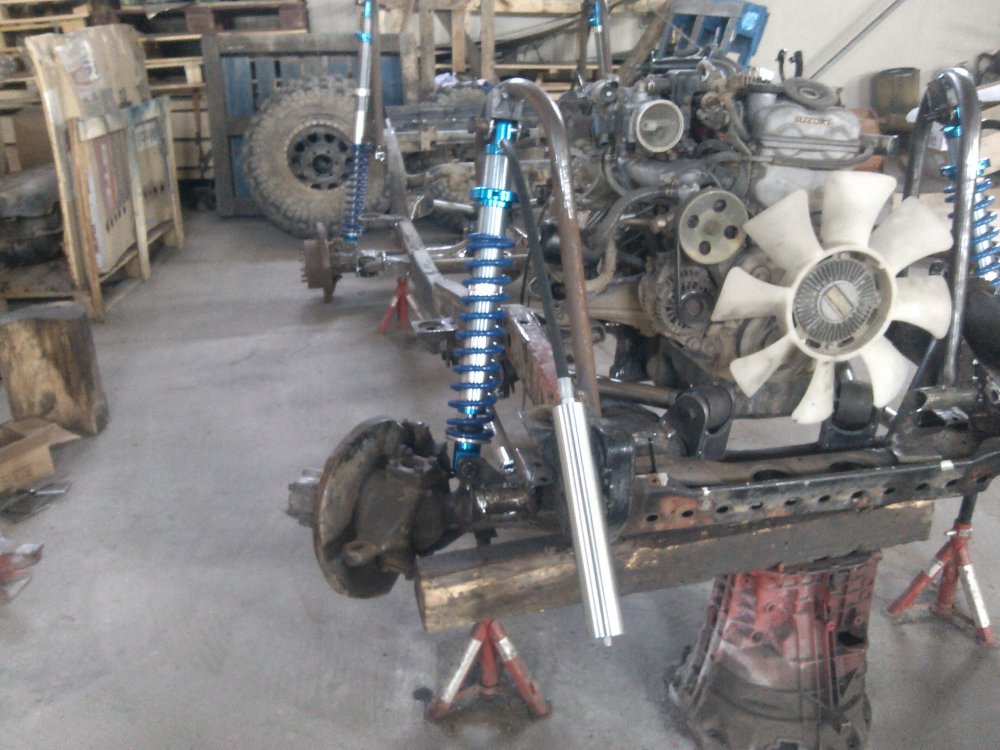

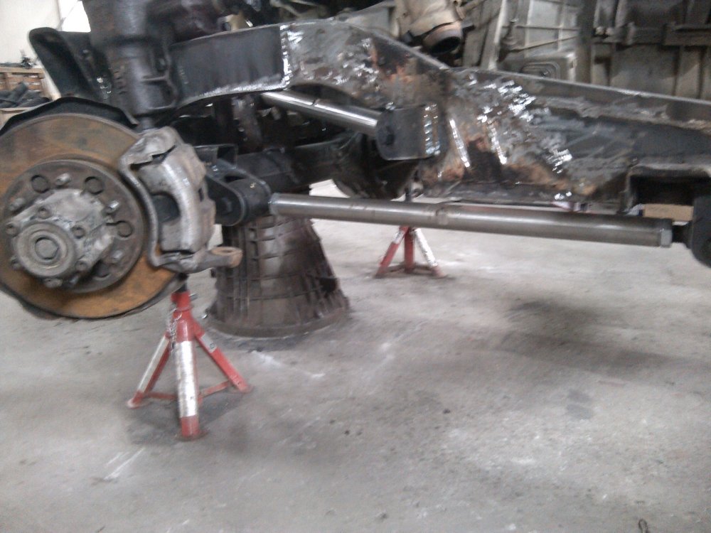

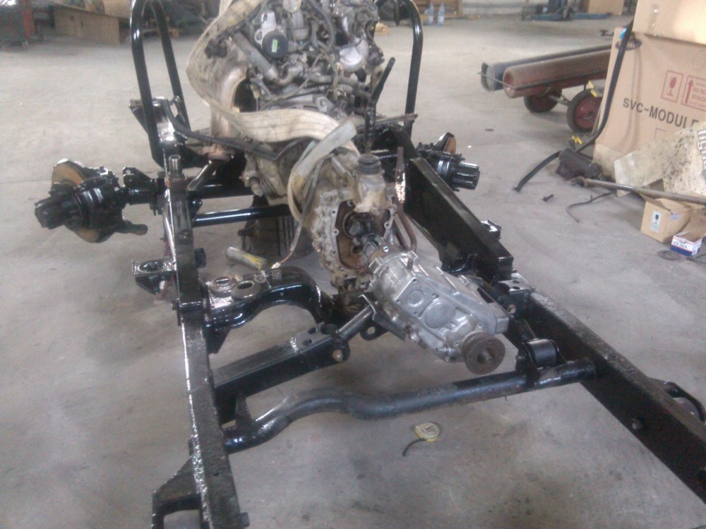

larry24 Posted April 7, 2014 Author Share Posted April 7, 2014 Re: suzuki vitara cu punti de nissan patrol 4linc fata Link to comment Share on other sites More sharing options...
alin-jeep Posted April 7, 2014 Share Posted April 7, 2014 Re: suzuki vitara cu punti de nissan patrol Interesant 4-link pe fata . Oare pe strada cum se va comporta ? (daca va mai vedea asfaltul :grin:) Link to comment Share on other sites More sharing options...

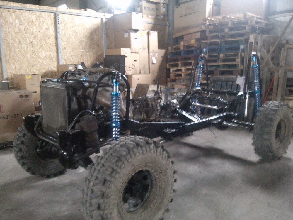

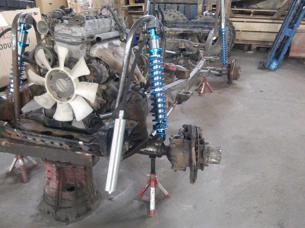

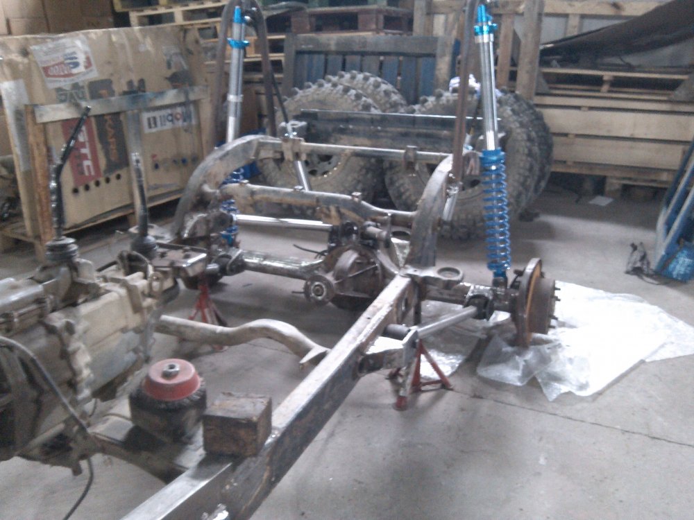

larry24 Posted April 8, 2014 Author Share Posted April 8, 2014 (edited) Re: suzuki vitara cu punti de nissan patrol s-au montat si coiloverele fata Edited April 8, 2014 by Astral Link to comment Share on other sites More sharing options...

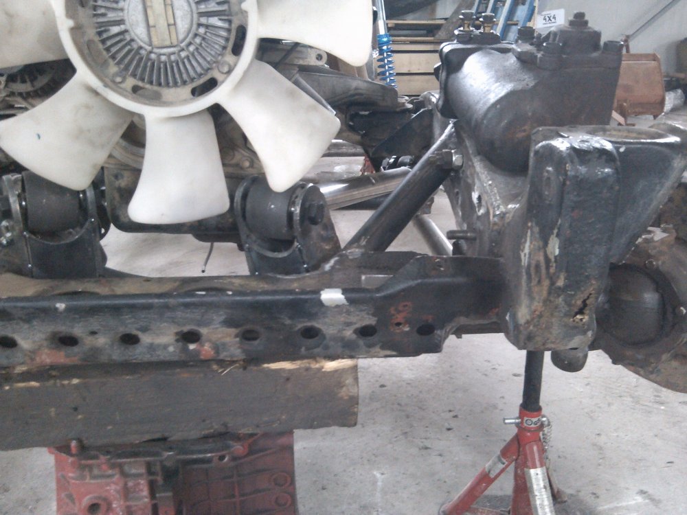

fulgeras Posted April 8, 2014 Share Posted April 8, 2014 (edited) Re: suzuki vitara cu punti de nissan patrol Te salut! Intreb si eu acuma, tendonul din partea dreapta de la V care vine sus pe punte, la flexare maxima nu loveste carcasa la grup?sau puntea cum este acuma va fi la maxim flexata? Mi se pare cam aproape tendonul ala de grup... Edited April 8, 2014 by Astral Christian Dan :grin: Link to comment Share on other sites More sharing options...
larry24 Posted April 9, 2014 Author Share Posted April 9, 2014 Re: suzuki vitara cu punti de nissan patrol espe pozitia cea mai de sus a punti Link to comment Share on other sites More sharing options...

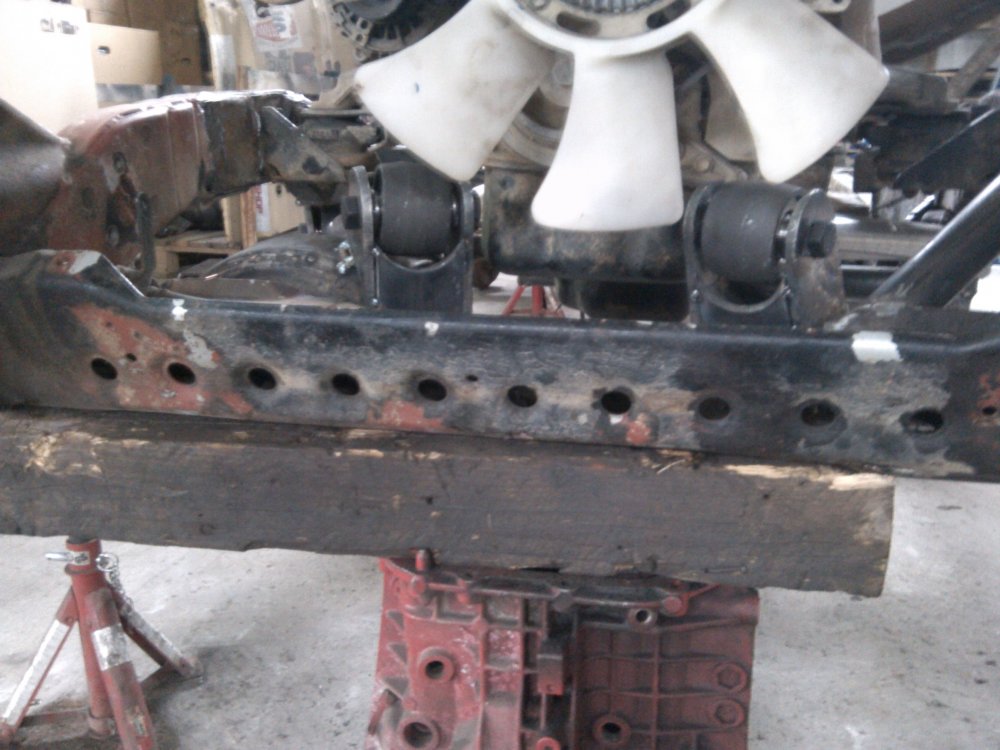

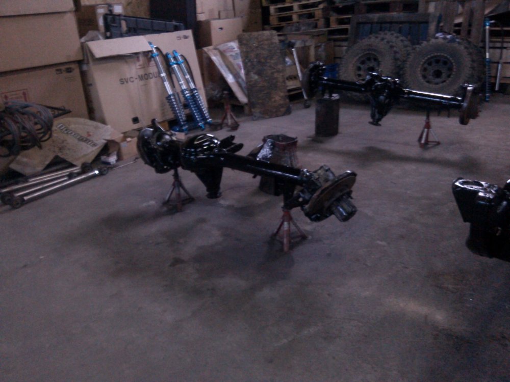

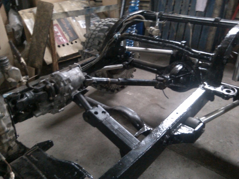

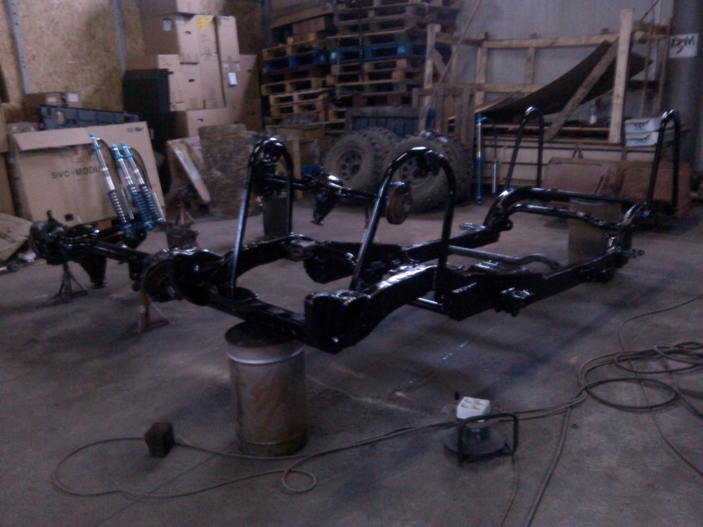

larry24 Posted April 12, 2014 Author Share Posted April 12, 2014 Re: suzuki vitara cu punti de nissan patrol pregatirea pentru montajul final Link to comment Share on other sites More sharing options...

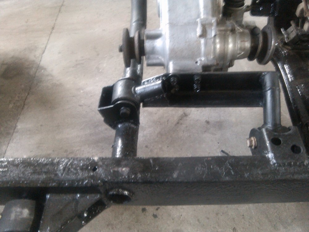

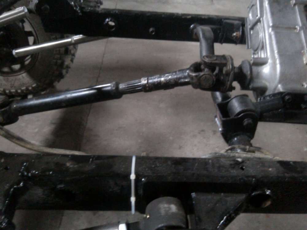

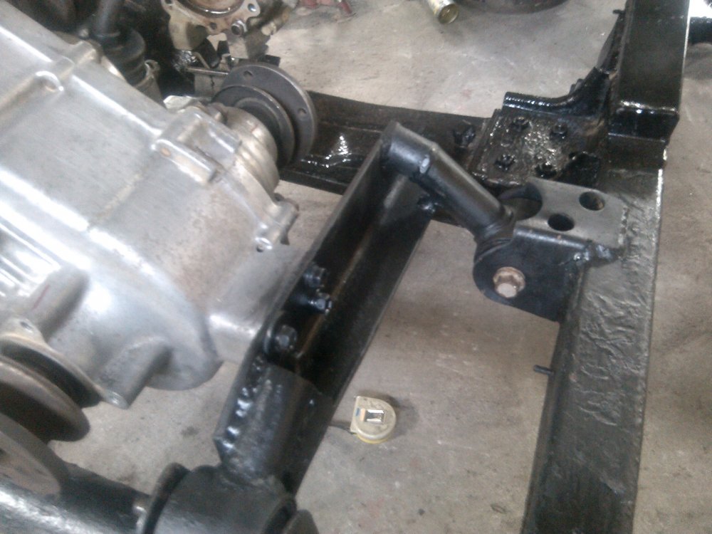

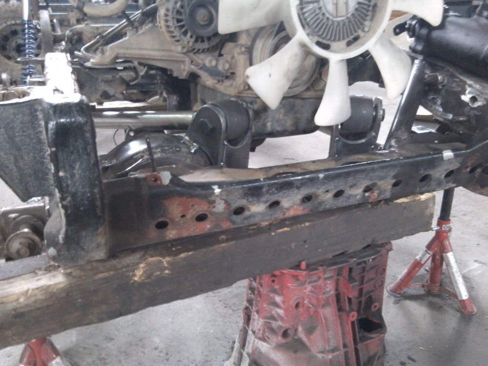

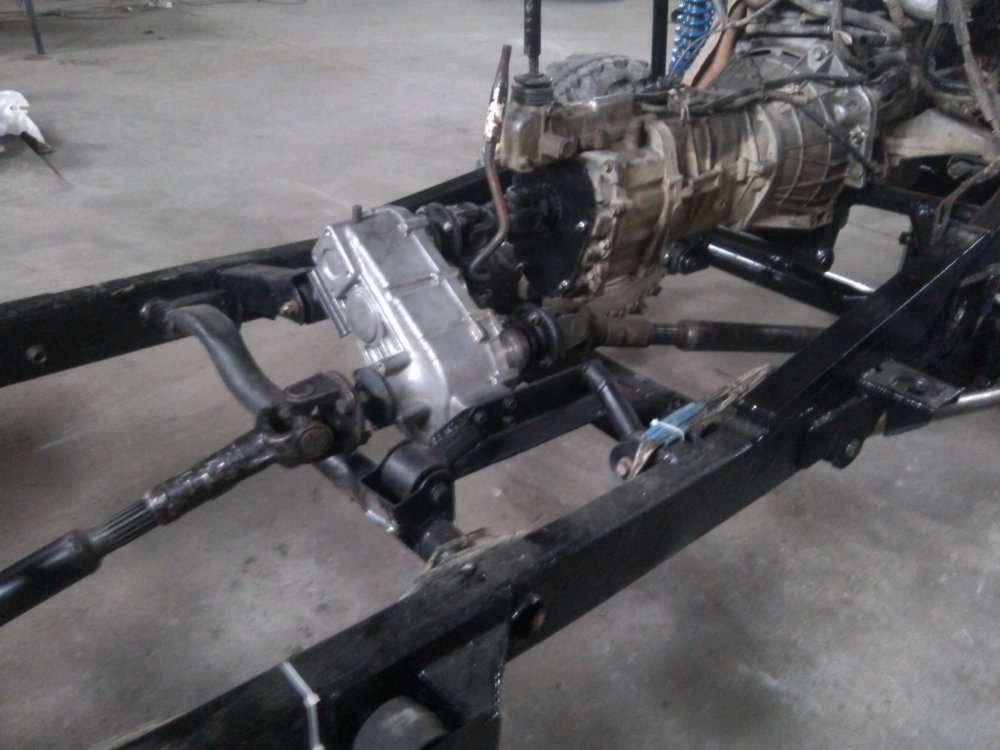

larry24 Posted April 14, 2014 Author Share Posted April 14, 2014 Re: suzuki vitara cu punti de nissan patrol am montat si reductorul de samurai 1 Link to comment Share on other sites More sharing options...
viorelvlad Posted April 16, 2014 Share Posted April 16, 2014 Re: suzuki vitara cu punti de nissan patrol Frumoasa lucrare, imi place ca reductorul ,s-a fixat solid ,asteptam sa o vedem la lucru in padure . Suzuki Samurai Toyota LJ 70, 3000cmc VW Golf Plus , de zi Link to comment Share on other sites More sharing options...
crt82sil Posted April 16, 2014 Share Posted April 16, 2014 Re: suzuki vitara cu punti de nissan patrol Salut! Montarea reductorului de samurai s-a facut pentru economie de bani (e mai ieftin decat sa schimbi rapoatele in reductor?) sau pentru ca e mai rezistent reductorul de samurai decat cel de vitara cu rapoarte schimbate? Ce rapoarte erau in reductorul de vitara si ce rapoarte sunt in cel de samurai? An investment in knowledge always pays the best interest. Dacă crezi că educaţia este scumpă, să vezi ignoranţa cât te va costa. Link to comment Share on other sites More sharing options...
Teodor4x4 Posted April 16, 2014 Share Posted April 16, 2014 (edited) Re: suzuki vitara cu punti de nissan patrol Ce rapoarte erau in reductorul de vitara si ce rapoarte sunt in cel de samurai? De fabrica pe Vitara vin urmatoarele rapoarte in reductor: Low / High -> 1.816 / 1.000 In cazul SJ-ului 410: Low / High -> 2.558 / 1.590 Edited April 16, 2014 by Teodor4x4 4x4, Way of Life ! Link to comment Share on other sites More sharing options...
larry24 Posted April 16, 2014 Author Share Posted April 16, 2014 (edited) S-a montat reductor de samurai penru ca e mai rezistent dupa mine si pentru ca are flanse de cardan nu culisanta ca la vitara .la flex la vitara iti iese cardanul din cutie. Transmisia e gata... S-au modificat flansele de cardane, s-au facut si s-au montat cardane HD de aro Am facut un capac cu semering sa inchida cutia, am schimbat rulmentul dintre cutie si reductor pentru ca nu mai are ungere am pus unul cu zet. Edited April 16, 2014 by Astral Link to comment Share on other sites More sharing options...
