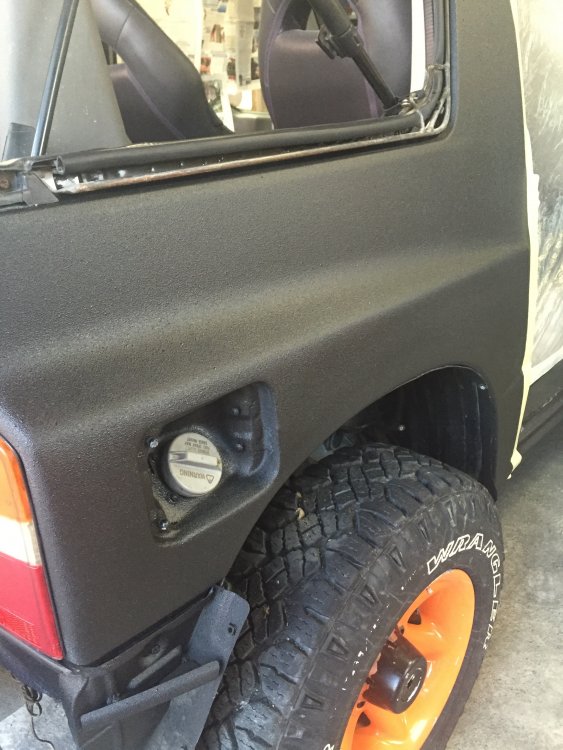

ovidiu nedelcu Posted July 27, 2016 Share Posted July 27, 2016 Re: Vopsirea caroseriei cu vopsea U-Pol RAPTOR Am vopsit si eu masina... ovidiu nedelcu 0752127812 Link to comment Share on other sites More sharing options...
ovidiu nedelcu Posted July 27, 2016 Share Posted July 27, 2016 Re: Vopsirea caroseriei cu vopsea U-Pol RAPTOR azi am cumparat si Raptor colorabil ovidiu nedelcu 0752127812 Link to comment Share on other sites More sharing options...
ovidiu nedelcu Posted July 27, 2016 Share Posted July 27, 2016 Re: Vopsirea caroseriei cu vopsea U-Pol RAPTOR maine o sa vopsesc barele si bandourile ovidiu nedelcu 0752127812 Link to comment Share on other sites More sharing options...
