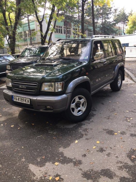

SUPERDRAGOS Posted October 9, 2016 Share Posted October 9, 2016 Ete ca nu mai sunt in tatonari.. Sper ca macar de acum incolo sa ne consultam 0722.246.245-YMS/e-mail-stoica.mdragos@yahoo.com Link to comment Share on other sites More sharing options...
Yonutz Posted October 9, 2016 Share Posted October 9, 2016 Re: Sfaturi achizitie Isuzu tropper 2001 3.o No feru e fain, sper sa nu ai probleme cu dansa ca apai sigur ne da cu consult. :grin: consiliere - diagnoza - evaluare - recovery Link to comment Share on other sites More sharing options...
SUPERDRAGOS Posted October 9, 2016 Author Share Posted October 9, 2016 Re: Sfaturi achizitie Isuzu tropper 2001 3.o Pai oricum o sa trec pt.consult pe la tine,chiar daca nu are probleme.. 0722.246.245-YMS/e-mail-stoica.mdragos@yahoo.com Link to comment Share on other sites More sharing options...

SUPERDRAGOS Posted October 15, 2016 Author Share Posted October 15, 2016 (edited) Re: Sfaturi achizitie Isuzu tropper 2001 3.o Pai imi rod unghiile ca nu am nimic sa-i fac..Dar am gasit eu-nuca de la schimbator nu mai are pielea pe care cea de la reductor o are...Banuiesc ca s-a rupt si cineva a scos-o.E cu cusatura americana,pe care n-am facut-o pana acum.Dar toate au un inceput. PS-Azi e a treia oara cand o demontez dimineata si o montez dupa amiaza exact cum a fost...Tot timpul se gasesc alte urgente. Edited October 15, 2016 by SUPERDRAGOS 0722.246.245-YMS/e-mail-stoica.mdragos@yahoo.com Link to comment Share on other sites More sharing options...
