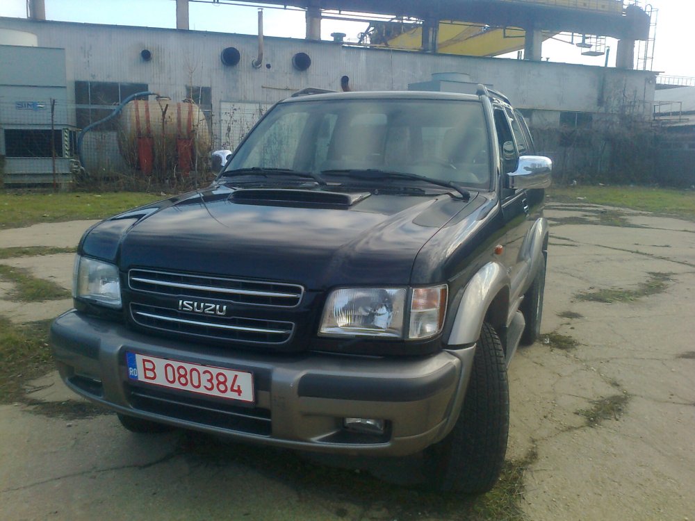

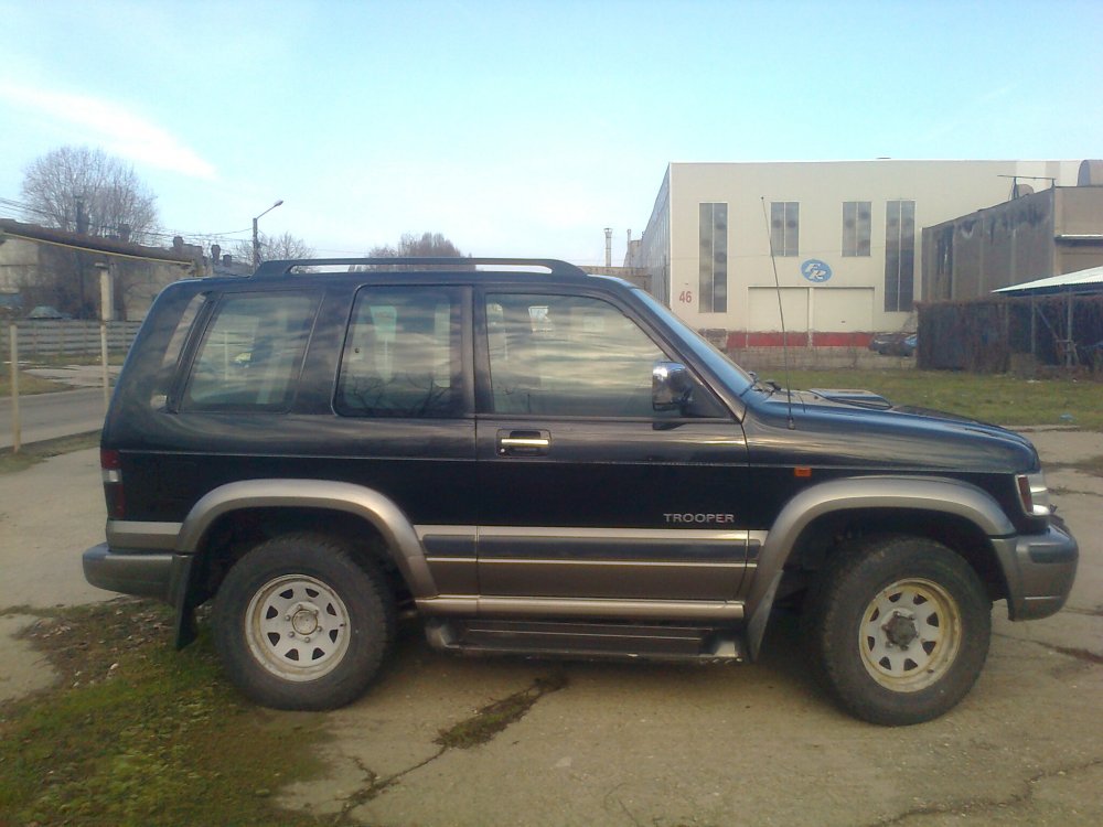

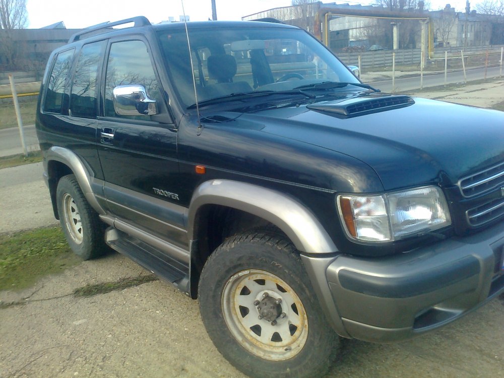

SUPERDRAGOS Posted June 24, 2017 Author Share Posted June 24, 2017 Re: De la Frontera la Trooper Mi se pare mie sau e cam prafuit...? :wink: 0722.246.245-YMS/e-mail-stoica.mdragos@yahoo.com Link to comment Share on other sites More sharing options...
stelea Posted June 25, 2017 Share Posted June 25, 2017 Re: De la Frontera la Trooper Mi se pare mie sau e cam prafuit...? :wink: Un pic ... 4x4MANIA is where we are !!! Link to comment Share on other sites More sharing options...

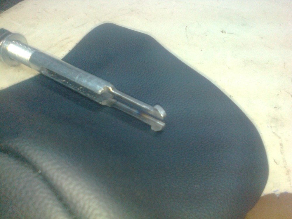

SUPERDRAGOS Posted August 23, 2017 Author Share Posted August 23, 2017 Re: De la Frontera la Trooper De ce nu incarca alternatorul cand era rece..?Colectorul sau ceva in genul,o chestie de cupru pe care calca un carbune.Piese proaste,de-abia au tinut 16 ani.. Nu se gasea nicaieri de cumparat asa ceva,s-a modificat insa o bucsa de Peugeot sau ceva frantuzesc,romaneste,si s-a rezolvat problema.. 0722.246.245-YMS/e-mail-stoica.mdragos@yahoo.com Link to comment Share on other sites More sharing options...

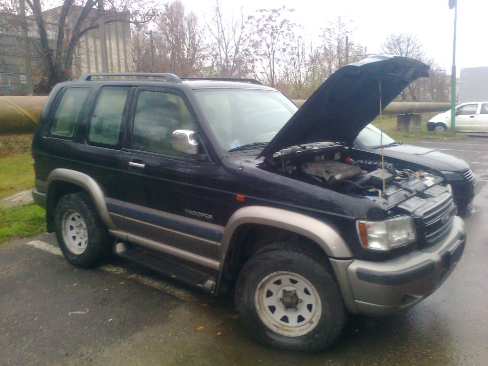

SUPERDRAGOS Posted December 3, 2017 Author Share Posted December 3, 2017 Re: De la Frontera la Trooper Tocmai mi-am descoperit o latura ascunsa...Cred ca sunt sadomasochist.Am mai luat unul. Masina are 115.000,euro 3(!) utilitara in acte,4 locuri,din 2003.Toate bune si frumoase dar nu porneste,de asta a fost si foarte ieftina.Incepem sapaturile,va tin la curent.Ce pot sa spun momentan ca la sufa nu troncane deloc trasa prin gropi si motorul invarte foarte bine cand dai la automat.. :ypu 0722.246.245-YMS/e-mail-stoica.mdragos@yahoo.com Link to comment Share on other sites More sharing options...
stelea Posted December 3, 2017 Share Posted December 3, 2017 Re: De la Frontera la Trooper Oare de ce am impresia ca se va rezolva cu pornirea :wink: 4x4MANIA is where we are !!! Link to comment Share on other sites More sharing options...
SUPERDRAGOS Posted December 3, 2017 Author Share Posted December 3, 2017 Re: De la Frontera la Trooper Asteptam un tech II,sa vedem ce zice..Ideea ca nu stiu ce au incercat aia de la GL de unde am luat-o.Mai sunt ceva furtunase de vacuum pe care nu le dibuiesc,mai un fir,o atentie.. 0722.246.245-YMS/e-mail-stoica.mdragos@yahoo.com Link to comment Share on other sites More sharing options...
stelea Posted December 3, 2017 Share Posted December 3, 2017 Re: De la Frontera la Trooper Cred ca are problema clasica (lipsa conditie de la presiunea de ulei), dar l-au hacuit aiurea ... 4x4MANIA is where we are !!! Link to comment Share on other sites More sharing options...
SUPERDRAGOS Posted December 3, 2017 Author Share Posted December 3, 2017 Re: De la Frontera la Trooper Da,am senzor cumparat de cateva luni in torpedou,parca stiam..Dar pana la tech nu ne apucam de demontat. 0722.246.245-YMS/e-mail-stoica.mdragos@yahoo.com Link to comment Share on other sites More sharing options...
stelea Posted December 3, 2017 Share Posted December 3, 2017 Re: De la Frontera la Trooper Normal ca trebuie mai intai TECH 2 ... Avea si @Yonutz ... 4x4MANIA is where we are !!! Link to comment Share on other sites More sharing options...
SUPERDRAGOS Posted December 5, 2017 Author Share Posted December 5, 2017 Re: De la Frontera la Trooper Nu are tech II,are ceva cu care nu s-a putut conecta,la mine cel putin,desi si-a dat tot interesul. 0722.246.245-YMS/e-mail-stoica.mdragos@yahoo.com Link to comment Share on other sites More sharing options...
stelea Posted December 5, 2017 Share Posted December 5, 2017 Re: De la Frontera la Trooper Nu are tech II,are ceva cu care nu s-a putut conecta,la mine cel putin,desi si-a dat tot interesul. :wtf1: Nici maiandrei?!?! 4x4MANIA is where we are !!! Link to comment Share on other sites More sharing options...

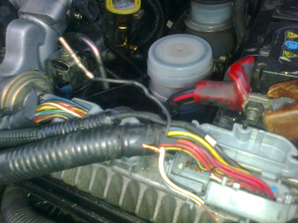

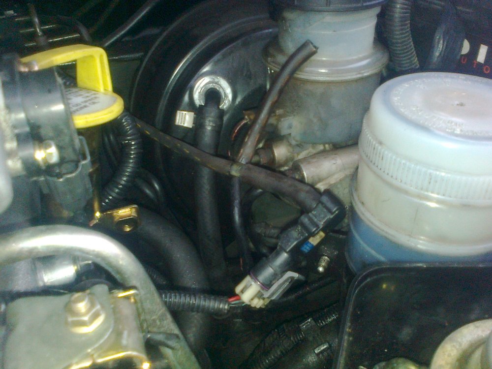

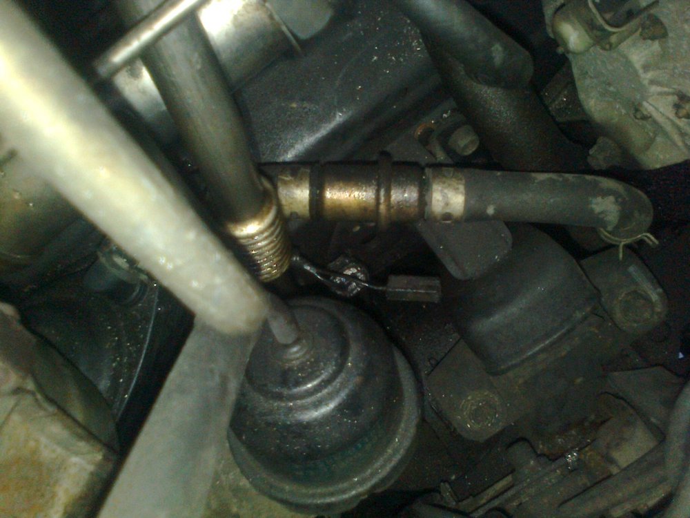

SUPERDRAGOS Posted December 9, 2017 Author Share Posted December 9, 2017 Re: De la Frontera la Trooper Maiandrei are,precum si @kuskru-el s-a deplasat de cateva ori pana aici.Pana acum am constatat ca bobina de la electrovalva ce tine presiunea de ulei in rampa este in scurt (iese fum din fire cand o pun la baterie),deci era blocata pe inchis. Pe Piese Auto respectiva bobina se vindea cu tot cu electrovalva,cu tot cu pompa de inalta,la 800-1000 ron.Am luat electrovalva completa,de la BG cu 350 ron.Am mai gasit o mufa desfacuta intr-un loc greu accesibil,banuiesc ca e de la senzorul de vibrochen,care nu arata nimic pe tester cand dadeam la cheie.Mai vedem azi ce se intampla. 0722.246.245-YMS/e-mail-stoica.mdragos@yahoo.com Link to comment Share on other sites More sharing options...
SUPERDRAGOS Posted December 11, 2017 Author Share Posted December 11, 2017 Re: De la Frontera la Trooper Se mai intampla de exemplu ca presiunea de ulei se pierde undeva intre pompa de ulei si injectoare,vreun o-ring lipsa,sau injectoarele stranse prost.Aceiasi presiune se poate pierde pe la sorbul de ulei de la injectie,tot din cauza vreunui o-ring ciufulit.Deci s-a dat in urmarire deja.. 0722.246.245-YMS/e-mail-stoica.mdragos@yahoo.com Link to comment Share on other sites More sharing options...

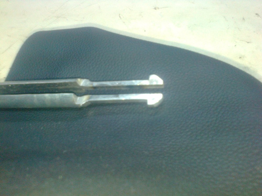

SUPERDRAGOS Posted February 18, 2018 Author Share Posted February 18, 2018 Re: De la Frontera la Trooper Si cam asa arata un injector SF desfacut 0722.246.245-YMS/e-mail-stoica.mdragos@yahoo.com Link to comment Share on other sites More sharing options...

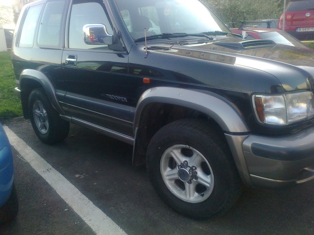

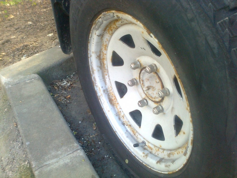

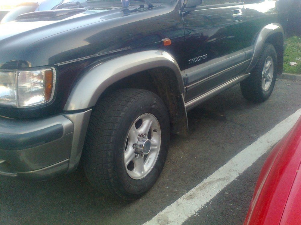

SUPERDRAGOS Posted March 9, 2018 Author Share Posted March 9, 2018 Re: De la Frontera la Trooper Si ce mai avem noi aici...? A mai aparut una,nu am putut sa o ratez.. :grin: 0722.246.245-YMS/e-mail-stoica.mdragos@yahoo.com Link to comment Share on other sites More sharing options...

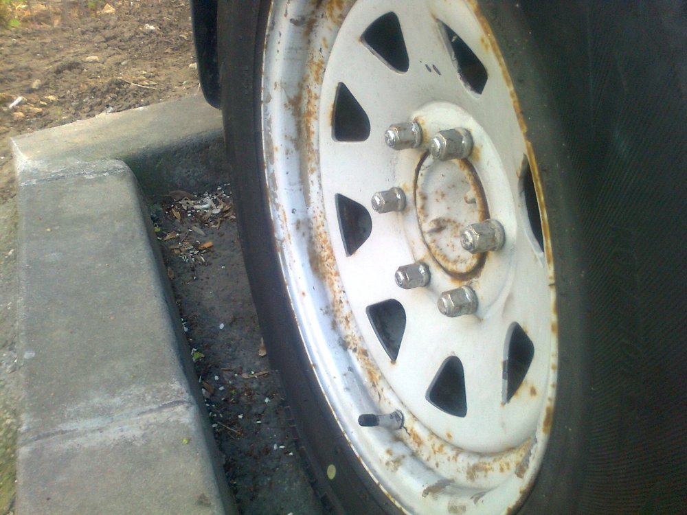

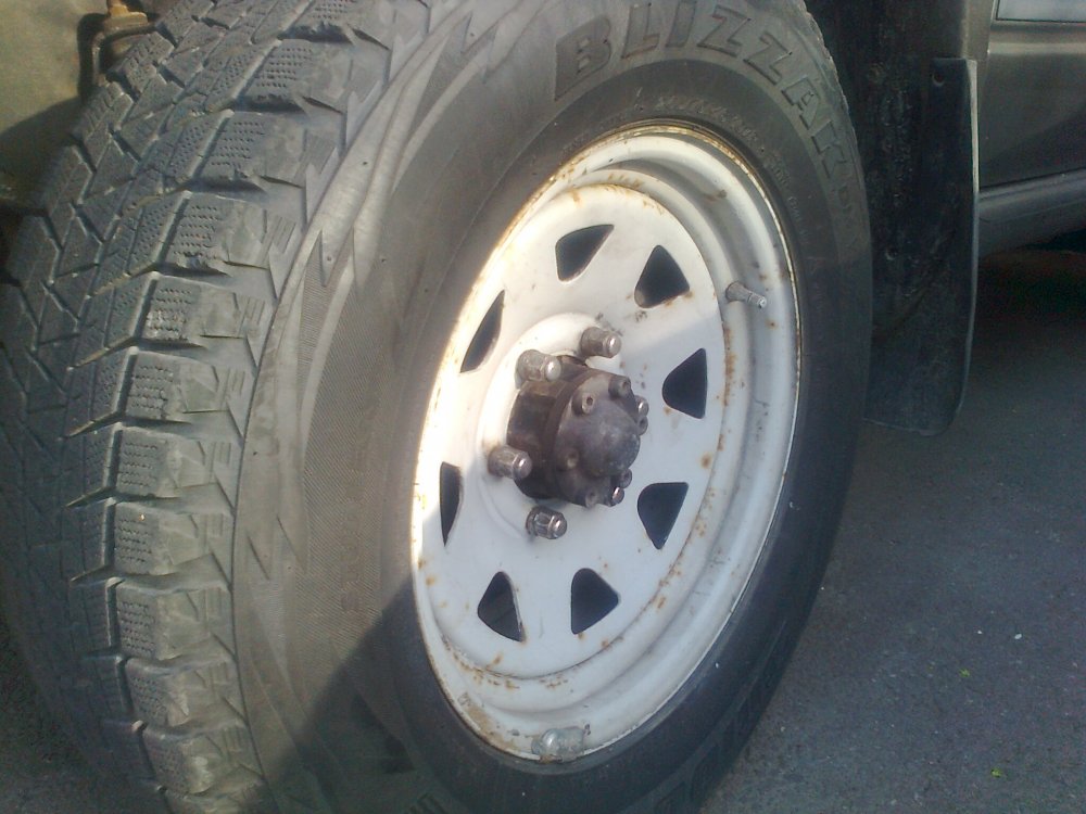

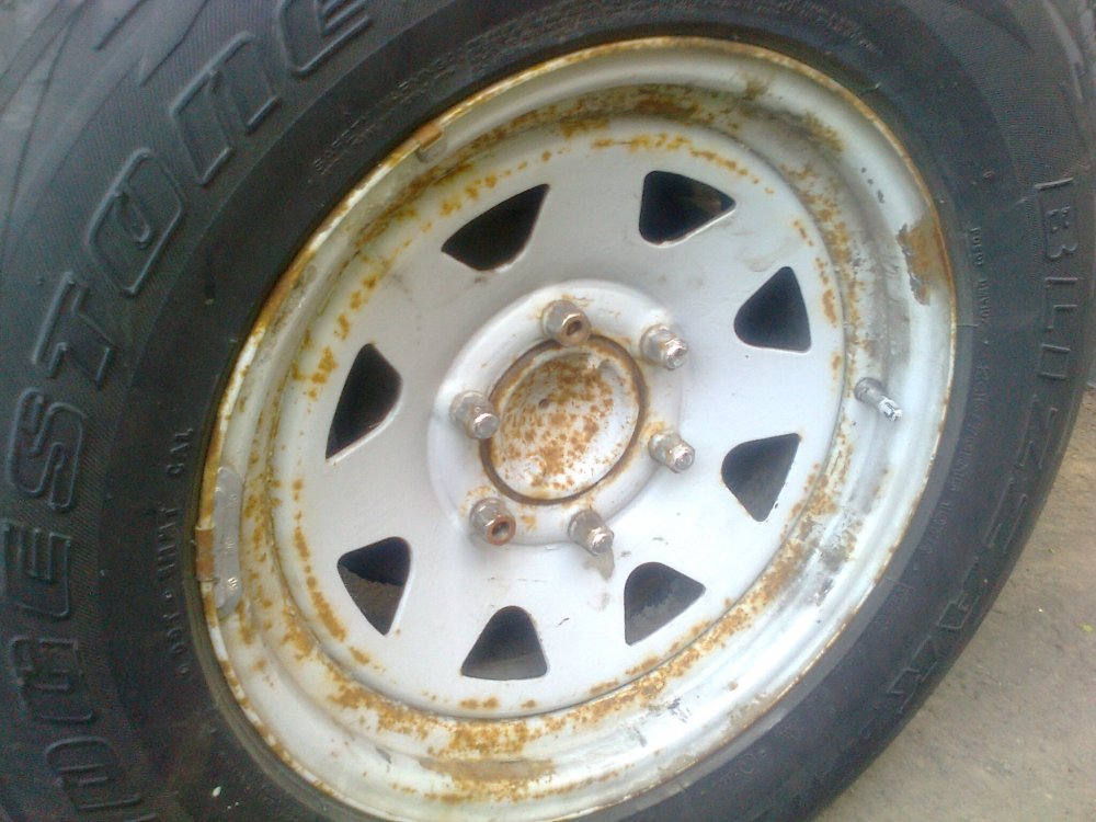

SUPERDRAGOS Posted April 10, 2018 Author Share Posted April 10, 2018 Re: De la Frontera la Trooper Jantele de aproape 0722.246.245-YMS/e-mail-stoica.mdragos@yahoo.com Link to comment Share on other sites More sharing options...
Astral Posted April 10, 2018 Share Posted April 10, 2018 Re: De la Frontera la Trooper Si ce mai avem noi aici...? [ATTACH=CONFIG]287082[/ATTACH]........ A mai aparut una,nu am putut sa o ratez.. :grin: Esti ceva de speriat !!! :ha: Sa fie intr-un ceas bun ! :h5 REGULAMENT FORUM CLUB 4X4 Rescue 4x4 & MyTrip Link to comment Share on other sites More sharing options...

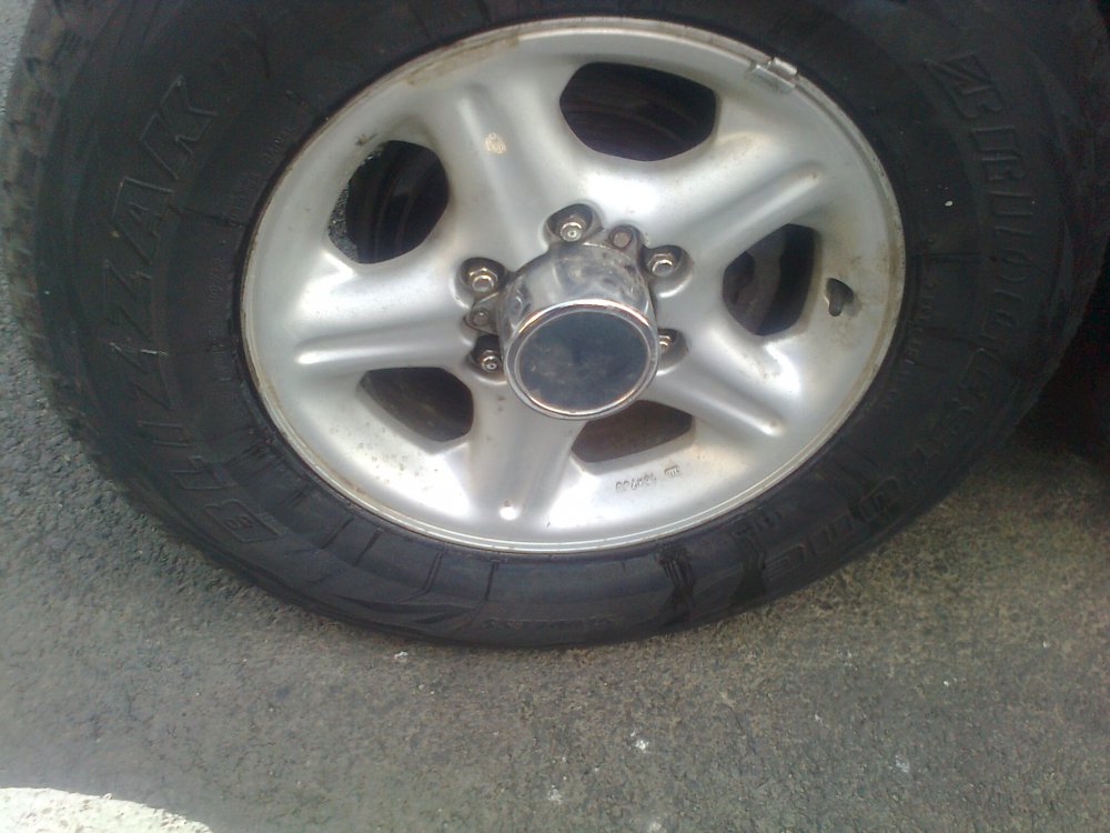

SUPERDRAGOS Posted April 12, 2018 Author Share Posted April 12, 2018 Re: De la Frontera la Trooper Sa fie primit..!Ieri i-am luat jante originale,le voi pune in cursul zilei de azi-neasteptat de bune chiar daca sunt sh (evident).Revin cu ceva poze. 0722.246.245-YMS/e-mail-stoica.mdragos@yahoo.com Link to comment Share on other sites More sharing options...

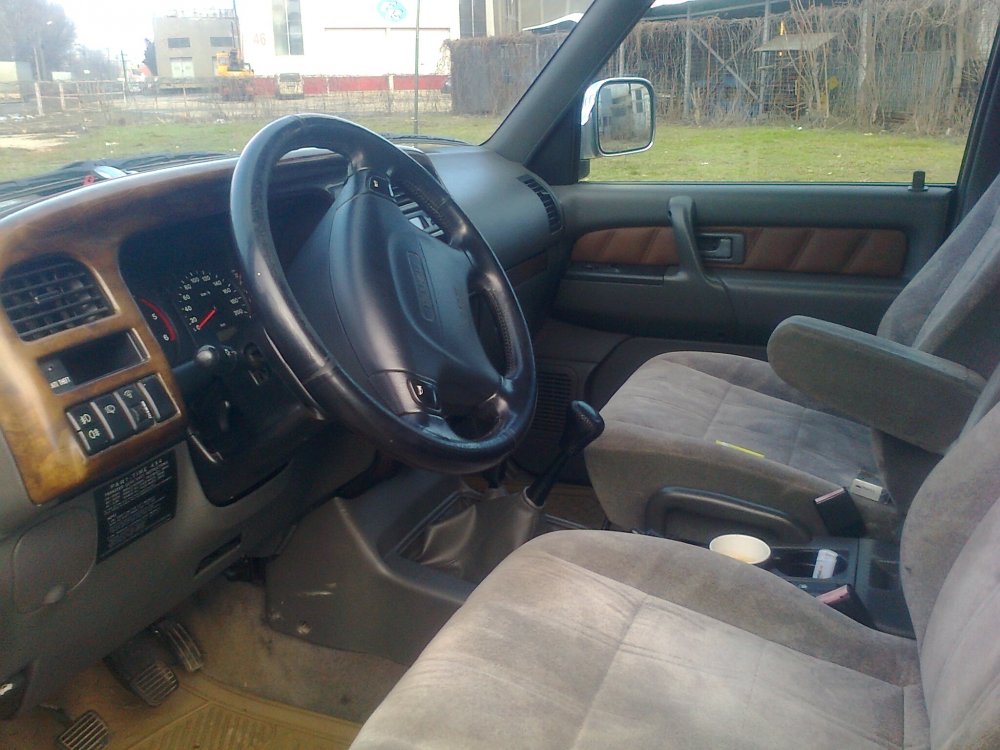

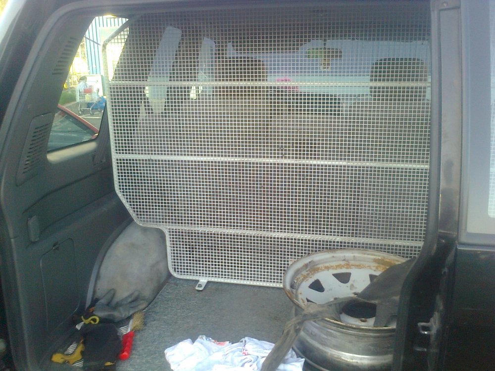

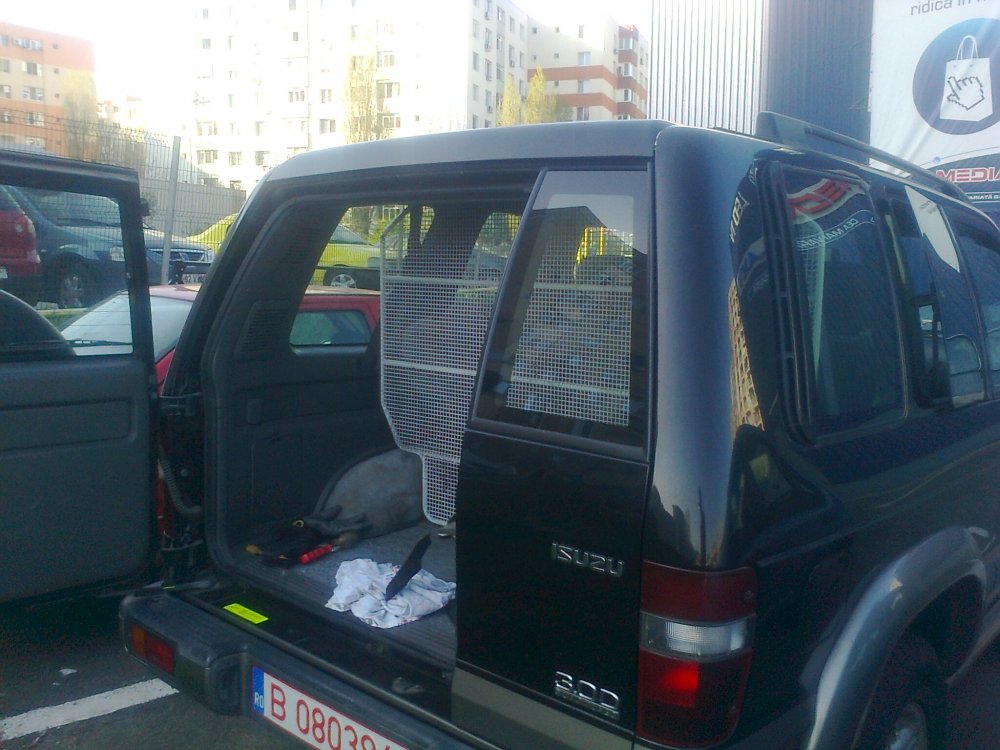

SUPERDRAGOS Posted April 14, 2018 Author Share Posted April 14, 2018 Re: De la Frontera la Trooper Cum ziceam.. Pregatita pentru programarea de luni de la RAR deci.. 0722.246.245-YMS/e-mail-stoica.mdragos@yahoo.com Link to comment Share on other sites More sharing options...
Astral Posted April 14, 2018 Share Posted April 14, 2018 Re: De la Frontera la Trooper Cum ziceam.. .....[ATTACH=CONFIG]287767[/ATTACH] Pregatita pentru programarea de luni de la RAR deci.. Sa nu-mi spui ca e autoutilitara ...!? Dupa cum e pus grilajul, o fi si cu 4 locuri ?!? REGULAMENT FORUM CLUB 4X4 Rescue 4x4 & MyTrip Link to comment Share on other sites More sharing options...
stelea Posted April 14, 2018 Share Posted April 14, 2018 Re: De la Frontera la Trooper Sa nu-mi spui ca e autoutilitara ...!? Dupa cum e pus grilajul, o fi si cu 4 locuri ?!? Nu, e cu 5 locuri ... si autoutilitara :grin: 4x4MANIA is where we are !!! Link to comment Share on other sites More sharing options...
SUPERDRAGOS Posted April 15, 2018 Author Share Posted April 15, 2018 (edited) Re: De la Frontera la Trooper Cu 5 locuri am crezut si eu ca e..Dar in cartea de IT sunt trecute doar 4.Bancheta fiind mai ingusta decat la 5 usi,ma gandesc ca toate astea scurte,la 3 usi sunt de fapt cu 4 locuri. Pregatiti pt RAR deci,regulamentar-grilaj,stingator,trusa si triunghiuri,ne imbracam frumos,blugii aia noi,eventual si cravata. Cealalta verde e utilitara cu 5 locuri. Edited April 15, 2018 by SUPERDRAGOS 0722.246.245-YMS/e-mail-stoica.mdragos@yahoo.com Link to comment Share on other sites More sharing options...
stelea Posted April 15, 2018 Share Posted April 15, 2018 Re: De la Frontera la Trooper Cu 5 locuri am crezut si eu ca e..Dar in cartea de IT sunt trecute doar 4.Bancheta fiind mai ingusta decat la 5 usi,ma gandesc ca toate astea scurte,la 3 usi sunt de fapt cu 4 locuri. (...). Decat 3 inghesuiti, mai bine doi comod :wink: 4x4MANIA is where we are !!! Link to comment Share on other sites More sharing options...
SUPERDRAGOS Posted April 15, 2018 Author Share Posted April 15, 2018 (edited) Re: De la Frontera la Trooper Orezarii incapeau lejer si 4 cred... Oricum accesul la locurile din spate e facut dupa chipul si asemanarea lor,doar pe la locul din dreapta si ideal pt persoane mic si slabe,pana in 45 kg cred. :dr2 Edited April 15, 2018 by SUPERDRAGOS 0722.246.245-YMS/e-mail-stoica.mdragos@yahoo.com Link to comment Share on other sites More sharing options...
