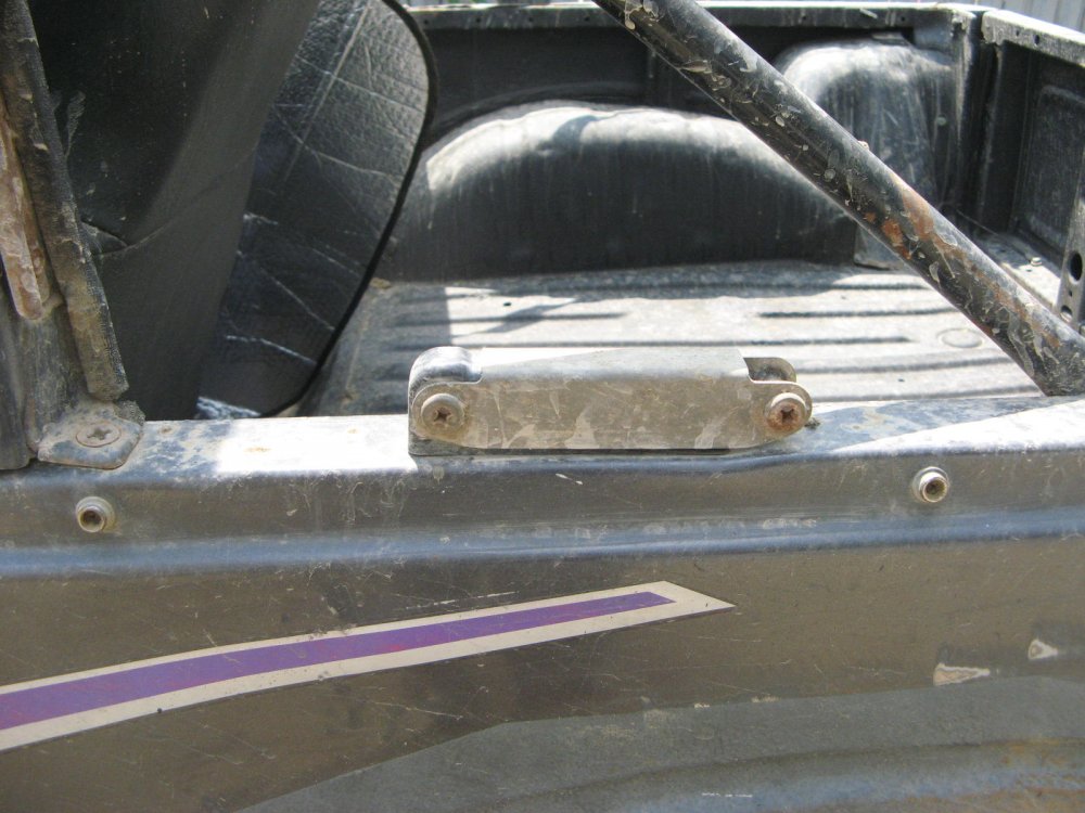

szmaco Posted June 25, 2016 Share Posted June 25, 2016 (edited) Re: compatibilitati piese samurai Stie careva ce cod are piesa? De fapt plasticul care tine este prins pe caroserie? Multumesc!! Edited June 25, 2016 by szmaco Link to comment Share on other sites More sharing options...
szmaco Posted July 7, 2016 Share Posted July 7, 2016 Re: compatibilitati piese samurai [ATTACH=CONFIG]265929[/ATTACH] Stie careva ce cod are piesa? De fapt plasticul care tine este prins pe caroserie? Multumesc!! Piesa se numeste Top Bow si are codul 78481-80000. Link to comment Share on other sites More sharing options...
