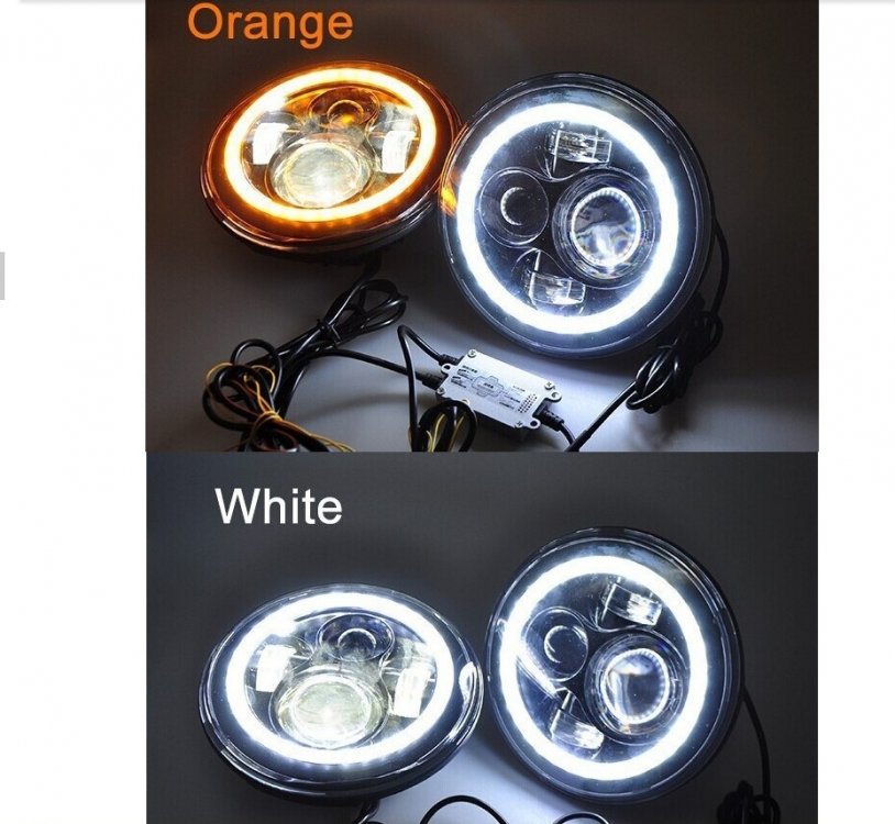

yknot Posted December 9, 2015 Share Posted December 9, 2015 (edited) Re: compatibilitati piese samurai Poti incerca un set din asta: Le poti lua de pe aici: http://www.aliexpress.com/item/2-Pieces-White-with-White-7-LED-Headlight-H4-High-low-Lumen-Auto-Headlight-7inch-Headlight/32399979725.html Gasesti la preturi incepand de pe la 140$ perechea, in functie de model si de vanzator. Edited December 9, 2015 by yknot 4x4 Link to comment Share on other sites More sharing options...

XTra Posted January 6, 2016 Share Posted January 6, 2016 Re: compatibilitati piese samurai Poti incerca un set din asta: [ATTACH=CONFIG]254086[/ATTACH][ATTACH=CONFIG]254087[/ATTACH] Le poti lua de pe aici: http://www.aliexpress.com/item/2-Pieces-White-with-White-7-LED-Headlight-H4-High-low-Lumen-Auto-Headlight-7inch-Headlight/32399979725.html Gasesti la preturi incepand de pe la 140$ perechea, in functie de model si de vanzator. Farurile astea sunt de JK. Sunt interesante dar cum se pot adapta pe Sami? Link to comment Share on other sites More sharing options...
yknot Posted January 6, 2016 Share Posted January 6, 2016 Re: compatibilitati piese samurai Fiind de 7" le poti pune in "montura" de samurai. 4x4 Link to comment Share on other sites More sharing options...
