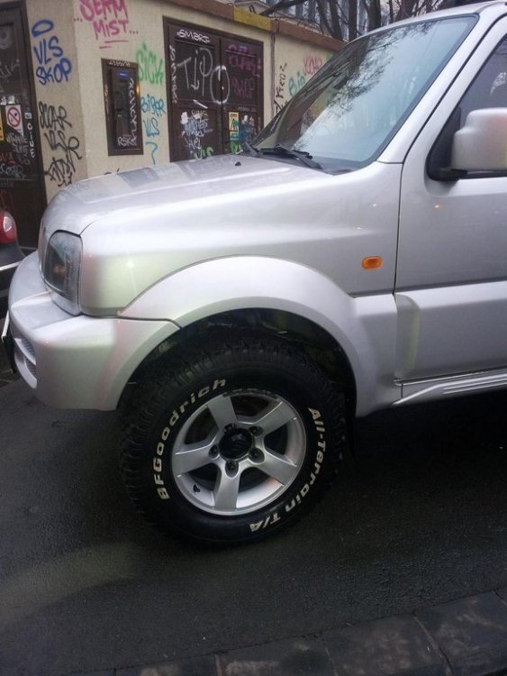

A13xF1v Posted January 17, 2013 Author Share Posted January 17, 2013 (edited) Re: Jimny saga Dimensiuni 215/75/15. Sper sa nu se supere vecinul. Se pare ca nu merg fara SL/BL Edited January 17, 2013 by A13xF1v Link to comment Share on other sites More sharing options...
