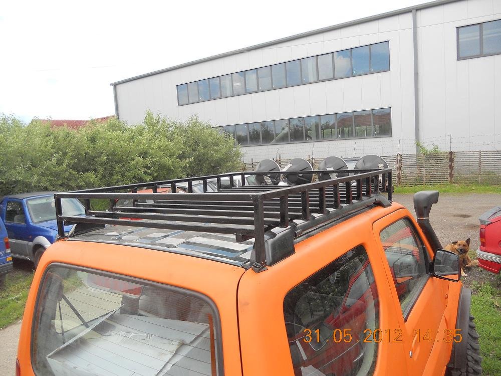

unde Posted May 31, 2012 Share Posted May 31, 2012 Re: Noul meu agregat '' Jimy '' Optima Yellow Top YT S 4,2, 12V/55A La pag. 2 a topicului ai poza si mai multe detalii. Mersi! Asta e varianta ce latimea standard 174mm. Suzuki Jimny 1.3i 2004 "There is nothing wrong with the planet... people are f*cked" - George Carlin Saving the planet Link to comment Share on other sites More sharing options...

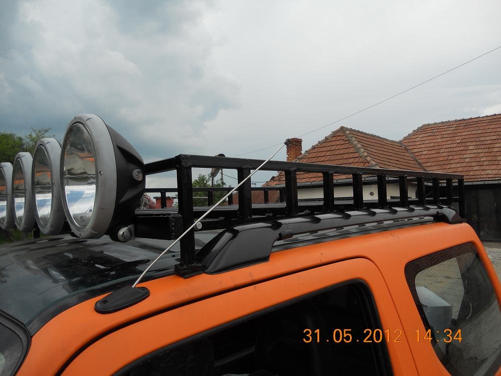

VAXXi Posted May 31, 2012 Share Posted May 31, 2012 Re: Noul meu agregat '' Jimy '' Barele de pe portbagaj raman, de ele fixez portbagajul pe plafon Ah, ma gandeam ca ai facut un roof rack integral eliminand barele de fabrica, ceva de genul asta: Suzuki Jimny 1.3 DOHC JLX 2007 = ProComp +2", body +1", flanşe, amortizor OME, scut, snorkel, BFG A/T 215/75R15, CB, StP, folie, xenon. Daewoo Espero 1.8 CD SOHC 1995 = aşteaptă anul 2027. Link to comment Share on other sites More sharing options...

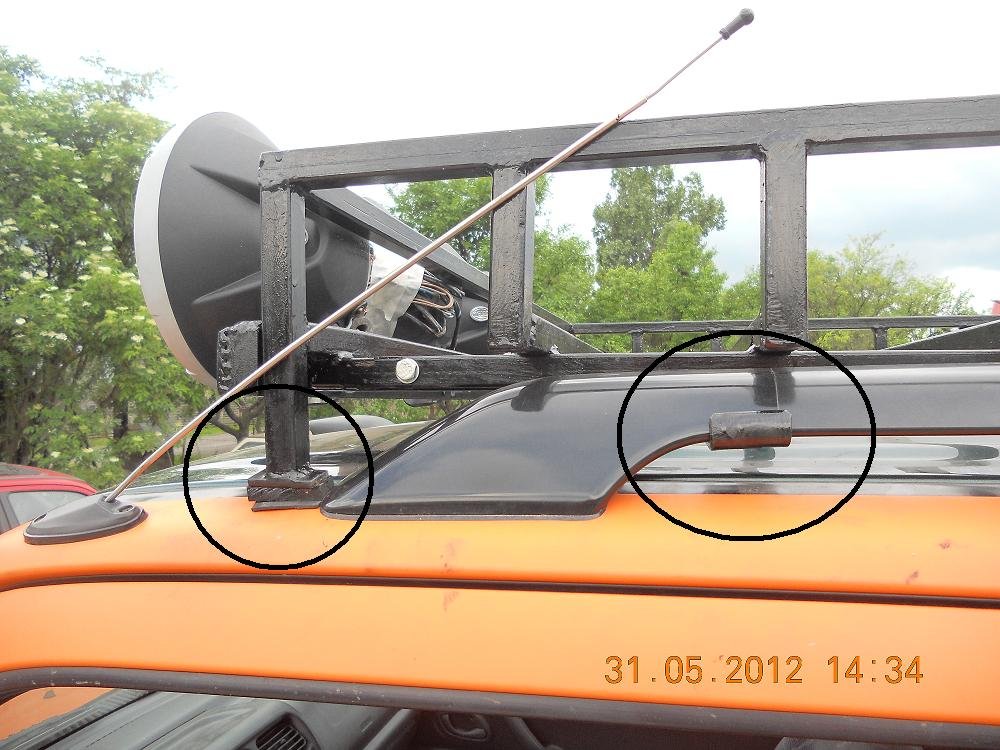

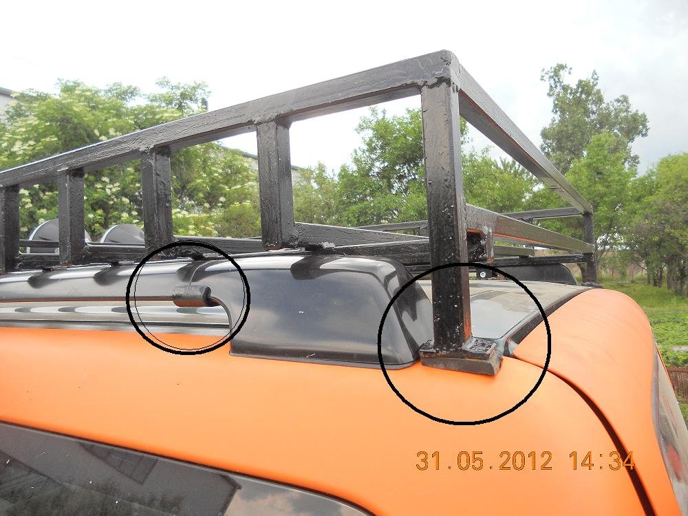

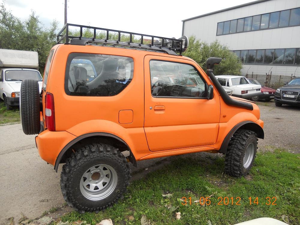

dorin4x4 Posted May 31, 2012 Author Share Posted May 31, 2012 Re: Noul meu agregat '' Jimy '' Atasez poze cu portbagajul montat, am incercuit punctele de prindere si sustinere. Link to comment Share on other sites More sharing options...
unde Posted May 31, 2012 Share Posted May 31, 2012 Re: Noul meu agregat '' Jimy '' Nu arata rau, dar vezi ca la prinderea pe bara te "sprijini" pe ornamentele alea de plastic, care nu sint foarte rezistente. Ar fi interesat de aflat si cite kg are. Suzuki Jimny 1.3i 2004 "There is nothing wrong with the planet... people are f*cked" - George Carlin Saving the planet Link to comment Share on other sites More sharing options...
dorin4x4 Posted May 31, 2012 Author Share Posted May 31, 2012 Re: Noul meu agregat '' Jimy '' Nu e greu, aproximez intre 25 si 30kg Link to comment Share on other sites More sharing options...
alexb25 Posted May 31, 2012 Share Posted May 31, 2012 Re: Noul meu agregat '' Jimy '' Arata foarte bine, felicitari. Cat de greu au fost de realizat picioarele portbagajului ? vreau si eu sa fac acelasi lucru, un roofrack cu prindere pe suruburile din plafon, da' m-a cam descurajat curbura aia asimetrica a capetelor de plastic care tin barele originale de portbagaj (nu stiu cat de bine poate fi reprodusa in metal). Un roofrack frumos au cei de la Zanfi, dar costa o avere: 850E :sh2 http://www.zanfi.it/modules.php?name=catalog&file=product_info&cPath=63_95&products_id=1374 Jimnyholic inside :j Link to comment Share on other sites More sharing options...

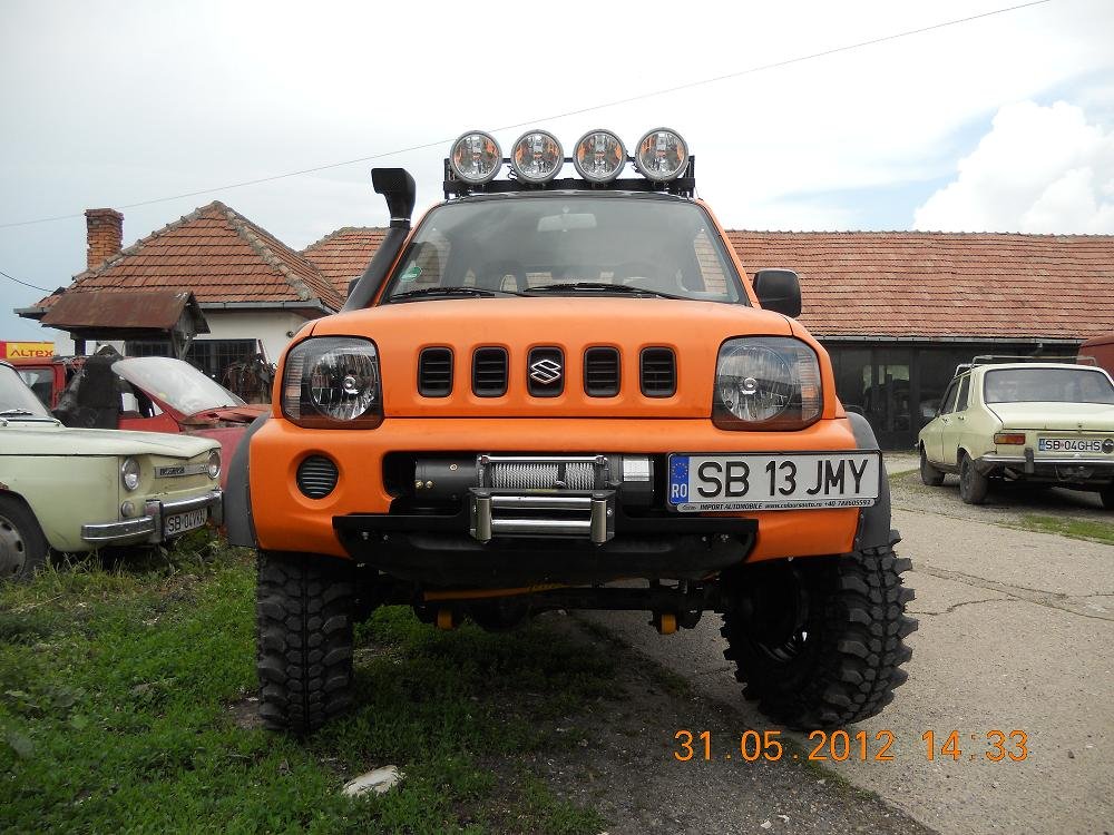

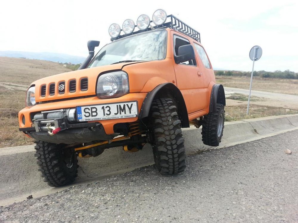

dorin4x4 Posted June 1, 2012 Author Share Posted June 1, 2012 (edited) Re: Noul meu agregat '' Jimy '' Intradevar arata foarte bine porbagajul Zanfi, ca de altfel tot ce au ei de vanzare, dar si preturile sunt pe masura. Cam asa arata agregatul meu in momentul de fata : Mai sunt de facut mici retusuri la caroserie, la partea electrica de legat troliul, proiectoarele, montat statia, mai vreau sa pun un proiector pe spate, schimbul de consumabile si filtre, rulmentii kingpin si sper ca am terminat :ypu Edited June 1, 2012 by dorin4x4 Link to comment Share on other sites More sharing options...
Vili Posted June 1, 2012 Share Posted June 1, 2012 Re: Noul meu agregat '' Jimy '' Felicitari! :br Cu terminatul, doar o etapa, ca urmeaza altele, diferential blocabil, rollcage, beadlock uri, etc. Ce iti recomand sa pui in faza asta, ar fi praguri laterale. Investitia nu este mare, dar protejezi pragul masinii la impactul cu bolovani, busteni etc. Punct de sprijin pentru Hi-lift, in caz ca ai nevoie sa ridici masina in padure. La inclinari laterale copilotul are unde sa stea sa tina contrabalans. Link to comment Share on other sites More sharing options...

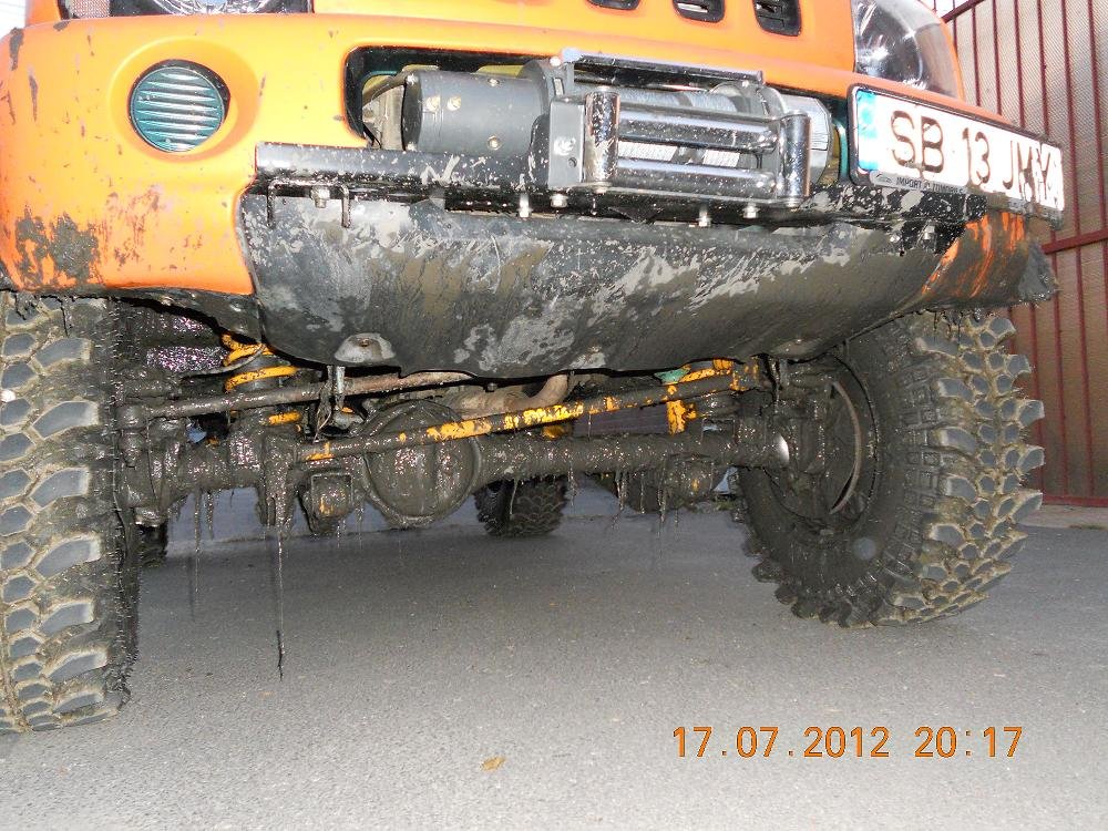

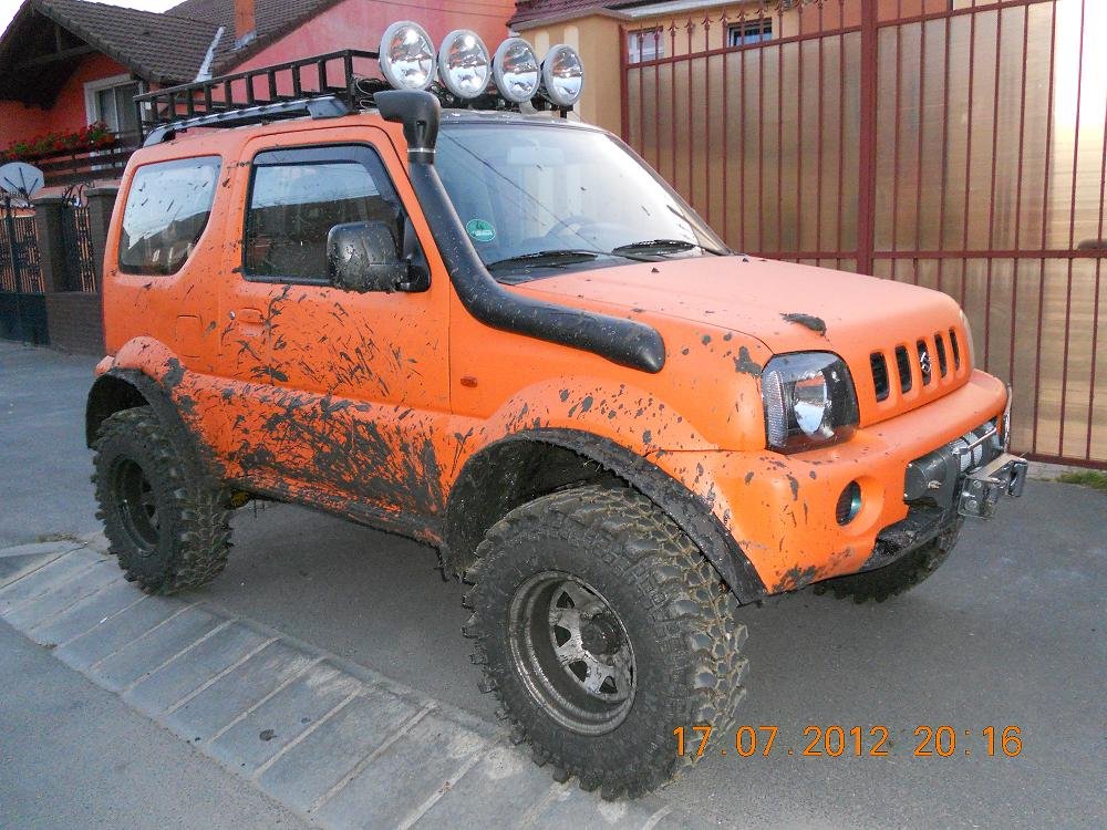

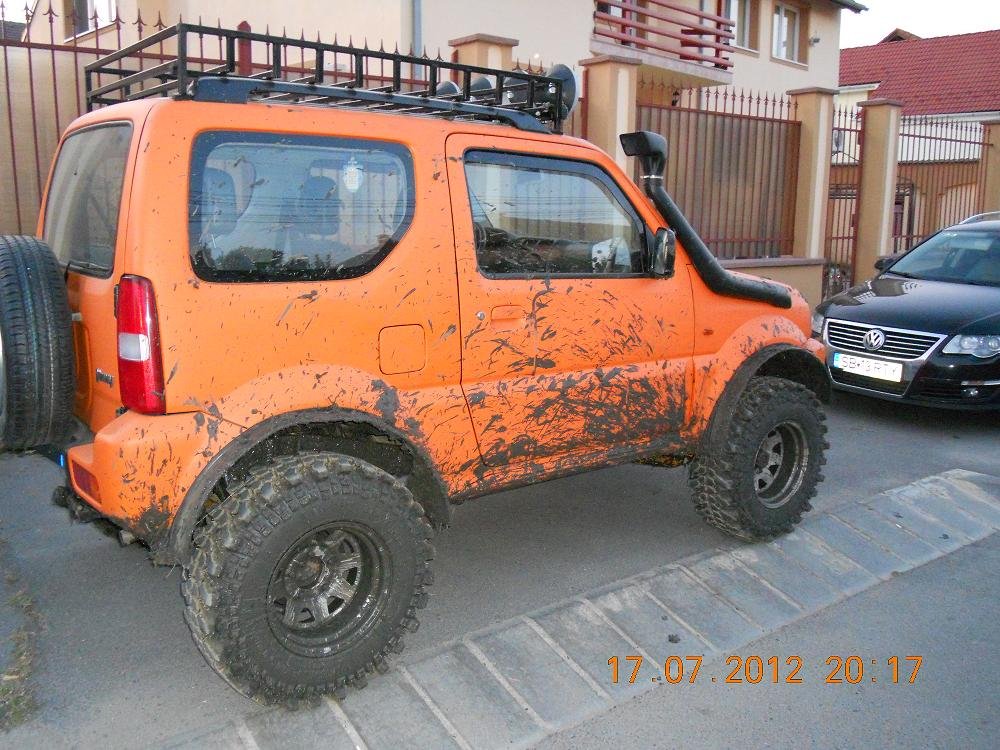

dorin4x4 Posted July 17, 2012 Author Share Posted July 17, 2012 Re: Noul meu agregat '' Jimy '' Cu toate ca masina in ca nu este gata, astazi am iesit la prima noroiala, pot sa spun ca masina s-a comportat excelent, atasez si ceva poze ... Link to comment Share on other sites More sharing options...
Astral Posted July 17, 2012 Share Posted July 17, 2012 Re: Noul meu agregat '' Jimy '' Frumusica tare....ca o mandarina ! :h5 REGULAMENT FORUM CLUB 4X4 Rescue 4x4 & MyTrip Link to comment Share on other sites More sharing options...
macfero Posted July 17, 2012 Share Posted July 17, 2012 Re: Noul meu agregat '' Jimy '' Arata f.bine masina:h5 Cum stai la flexari ? Ating cauciucurile ? Link to comment Share on other sites More sharing options...

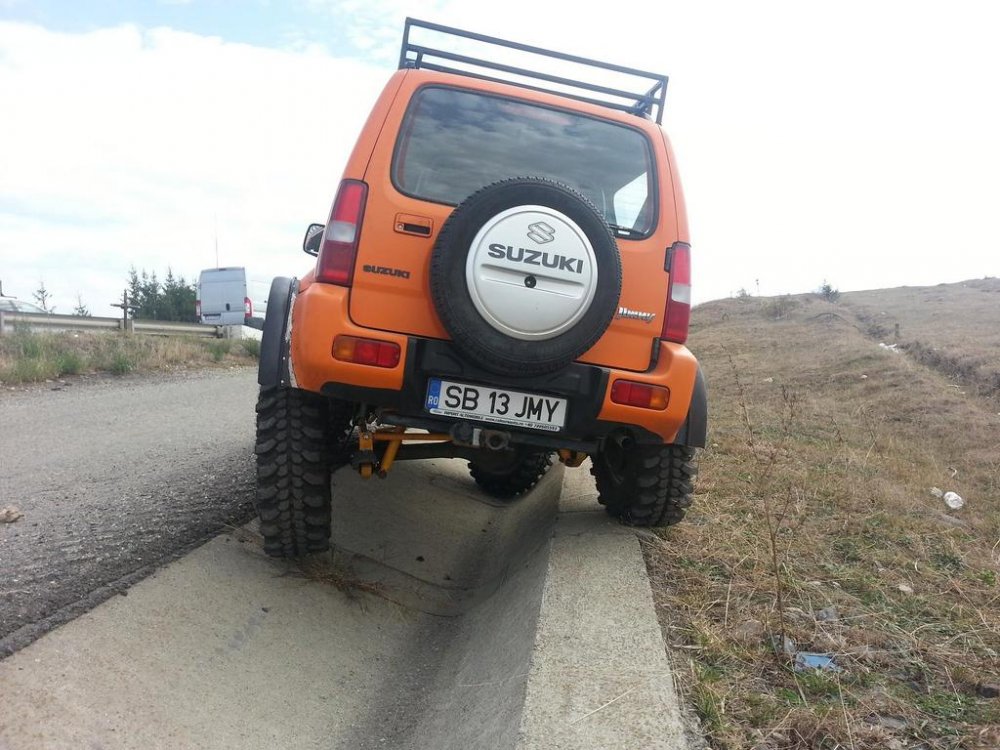

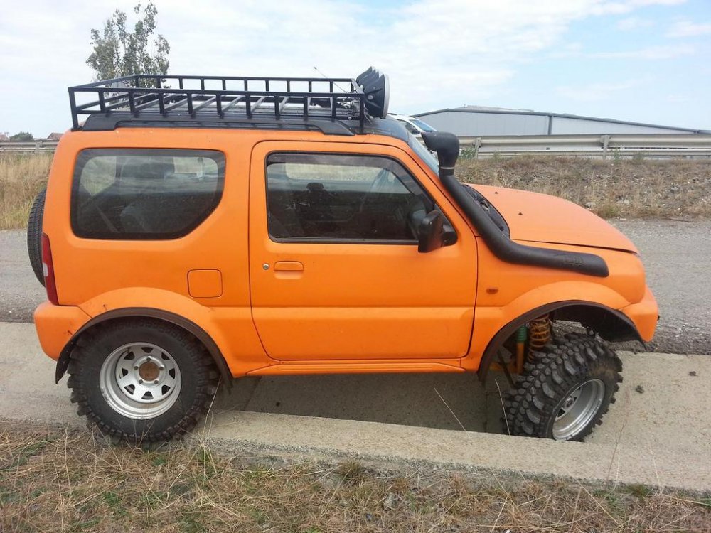

dorin4x4 Posted July 19, 2012 Author Share Posted July 19, 2012 Re: Noul meu agregat '' Jimy '' La flexari sta bine, nu atinge nicaieri, sunt f multumit de suspensie, cu toate ca poate e pre devreme sa ma pronunt. Arata f.bine masina:h5 Cum stai la flexari ? Ating cauciucurile ? Link to comment Share on other sites More sharing options...
dorin4x4 Posted July 19, 2012 Author Share Posted July 19, 2012 Re: Noul meu agregat '' Jimy '' Astazi am iesit iarasi cu masina pe un teren ceva mai accidentat, flexeaza foarte bine, atat de bine incat ating toate 4 rotile, asa ca masina intra iar in modificari, trebuie sa mai fac loc de cel putin 3 cm la toate aripile :ang2 Arata f.bine masina:h5 Cum stai la flexari ? Ating cauciucurile ? Link to comment Share on other sites More sharing options...

dorin4x4 Posted September 18, 2012 Author Share Posted September 18, 2012 Re: Noul meu agregat '' Jimy '' Am reusit sa finalizez coafarea aripilor spate, dupa mici teste nu mai ating nicaieri, urmeaza proba in teren :dr2 Atasez si neste poze ... [ATTACH=CONFIG]151429[/ATTACH] Link to comment Share on other sites More sharing options...
