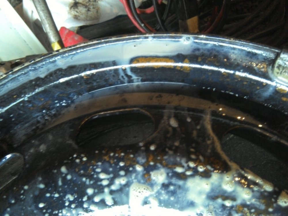

Yonutz Posted June 5, 2013 Share Posted June 5, 2013 Re: Vactan sau Kelfos - Inhibitori de Rugina Normal o suprafata corecta este neagra, neagra-violet. Daca iese rosie atunci fie nu ai aplicat destul fie nu ai curatat bine suprafata inainte de aplicare. De preferat ...a se aplica pe ud ptr o reactie mai buna. consiliere - diagnoza - evaluare - recovery Link to comment Share on other sites More sharing options...
liviuplaton Posted June 6, 2013 Share Posted June 6, 2013 Re: Vactan sau Kelfos - Inhibitori de Rugina Link to comment Share on other sites More sharing options...
u2_2 Posted June 6, 2013 Share Posted June 6, 2013 (edited) Re: Vactan sau Kelfos - Inhibitori de Rugina Mie imi pare ca acolo unde ai pete rosiatice nu a fost bine curatata vopseaua sau acoperirea anterioara ? Oricum, cred ca ar fi fost o idee buna sa dai jos plumbii de echilibrare... Edited June 6, 2013 by u2_2 Link to comment Share on other sites More sharing options...
liviuplaton Posted June 6, 2013 Share Posted June 6, 2013 (edited) Re: Vactan sau Kelfos - Inhibitori de Rugina Unde-s petele rosii e tabla curata cred ca am curatat-o de vreo 4 ori cu flexul, am umezit cu apa, am sters-o cu diluant dar tot asa se face. Edited June 8, 2013 by Astral Link to comment Share on other sites More sharing options...
liviuplaton Posted June 8, 2013 Share Posted June 8, 2013 Re: Vactan sau Kelfos - Inhibitori de Rugina Dupa mai multe incercari am ajus la o concluzie, in zona cu rugina cad dai cu kelfos se face negru lucios , unde e tabla curata fara rugina se inroseste. Link to comment Share on other sites More sharing options...
