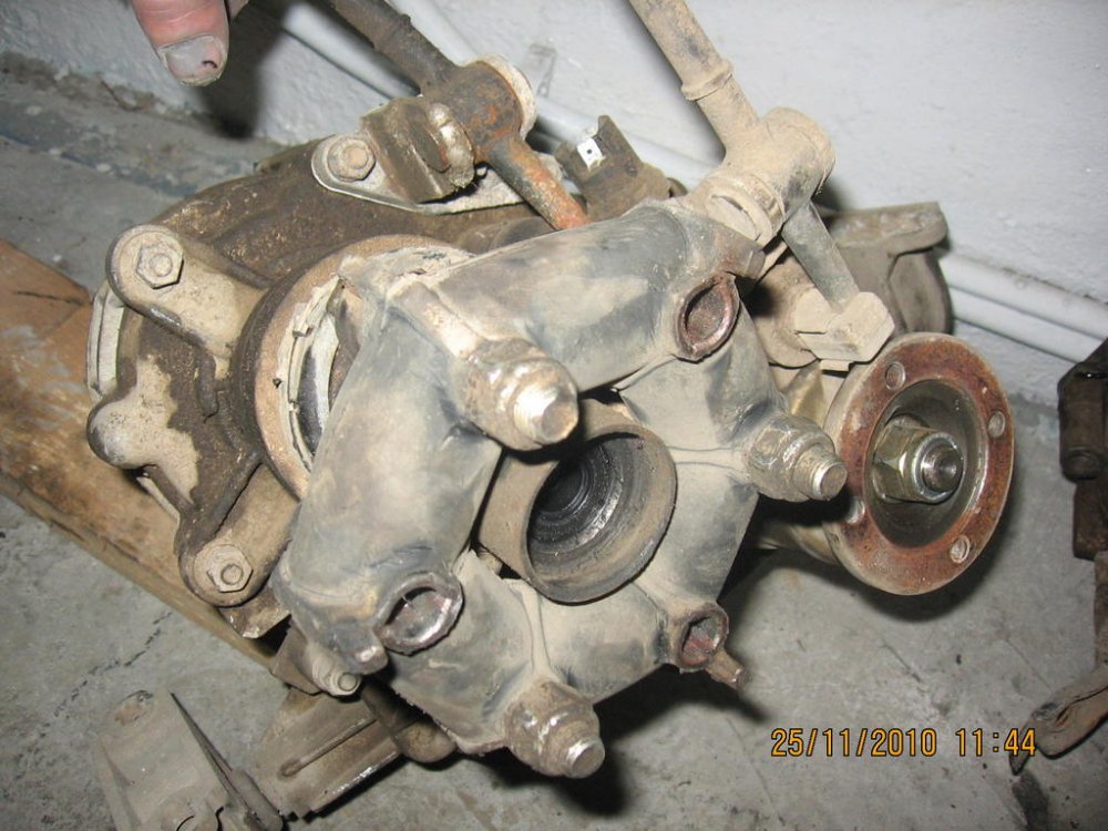

...m-am gandit sa pun cateva poze cu agregatu' dus la doctor

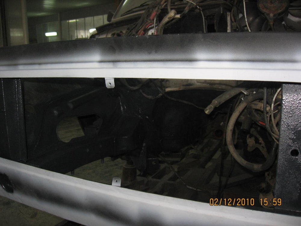

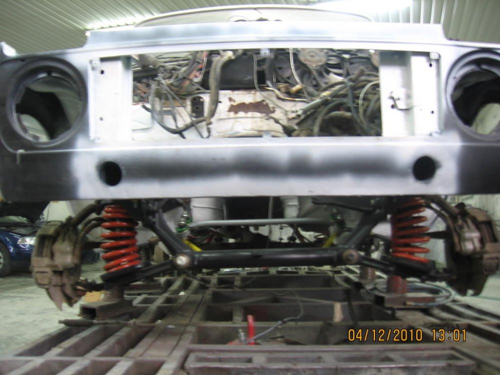

.....dupa un pic de cosmetizare
IMG_9301.thumb.jpg.9b7801ee9b175ce4da417c6173de8be3.jpg686828428_IMG_9301.thumb.jpg.cbe3b87d66553799cc66062326899682.jpg

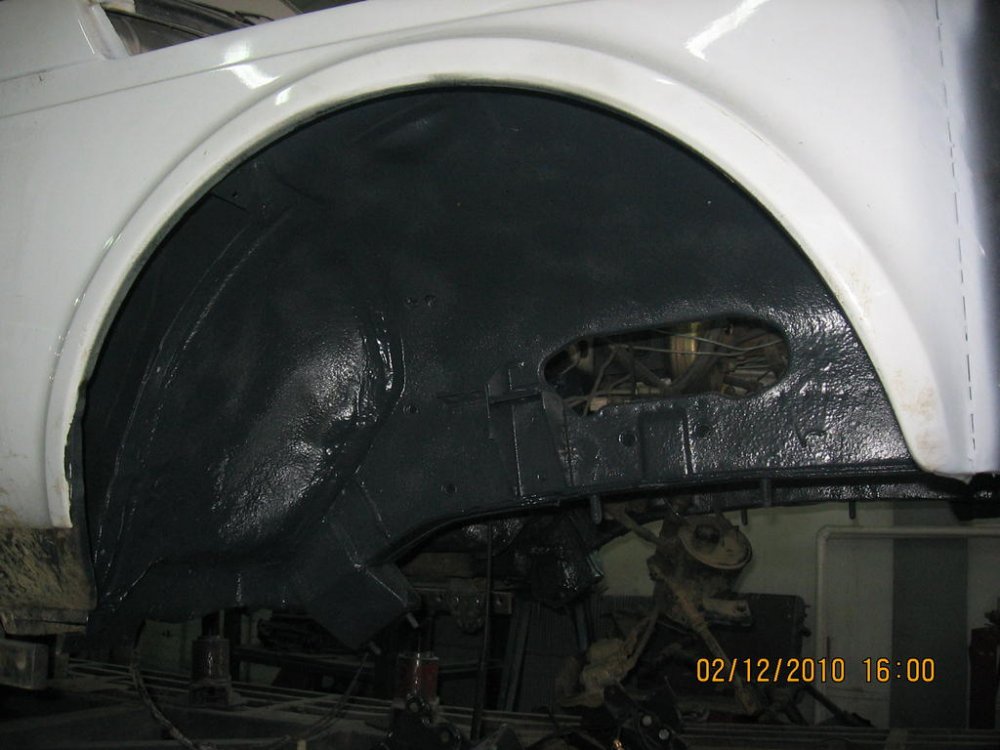

...un pic de grund si antifon la incinta motor si tunelIMG_9307.thumb.jpg.c51f6f707432071a65fcc1fb6a794d46.jpg
Edited by dan chiperi

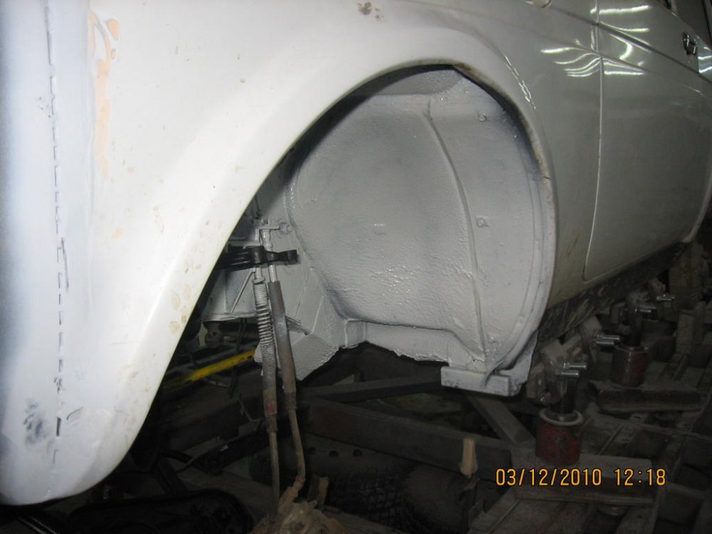

...de asemeni antifon la aripi, si la pedalier stanga dreapta pe interior(inclusiv covoras insonorizant din ala cauciucat)
IMG_9308.thumb.jpg.022b505fe63dd94a592946a6b3066842.jpgIMG_9309.thumb.jpg.3928cb9b941193dbb7419f241084d26b.jpg
...apoi o revopsire in culoarea caroseriei
IMG_9310.thumb.jpg.8e1ae2f0fb47603b16377604e31aaddc.jpgIMG_9311.thumb.jpg.9510dc89f8392e97b6bbffc70afc6877.jpg
IMG_9312.thumb.jpg.71aeb47df519f58fe3263aed223c6af7.jpgIMG_9314.thumb.jpg.cc7e2b0ac43016a10192234b24aa61dd.jpg
IMG_9317.thumb.jpg.8beb8db96da75adf549006241946fa21.jpgIMG_9319.thumb.jpg.823c4b730e17bf023d1e2088181780fa.jpg

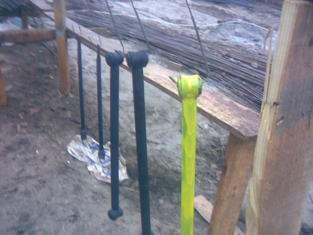

...apoi "un tratament facial" :grin: cu kit si grund pt zonele in care a fost "atinsa" sau aparura mici pete de rugina
IMG_9322.thumb.jpg.652e2fb8f28a0d9c71ef738eb0a01498.jpgIMG_9323.thumb.jpg.e7c9244372fc5103d5fefb611d5cc169.jpg
IMG_9324.thumb.jpg.3eecb54cd1659c9620c942b1ffaa59be.jpg.....cam atat pt inceput:wink:, trecand pe mana altui "propitar", a capatat o noua fata. De acum mai bagam banuti si in gaz, ca sa o mai si scoatem la aer

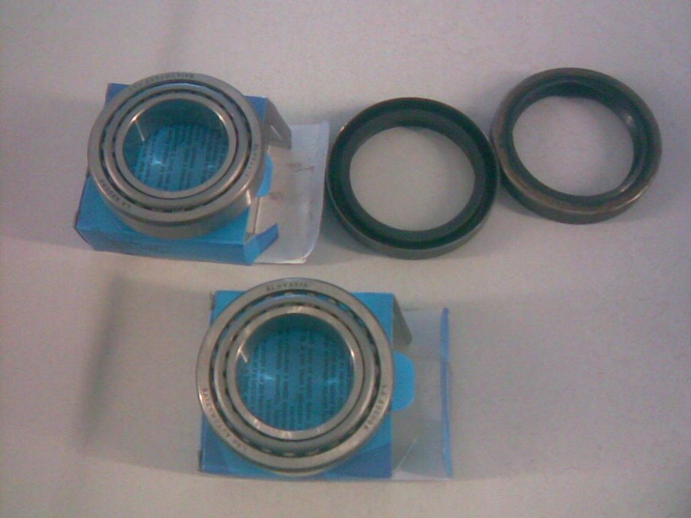

Evident ca, a crapat un rulment :grin:, si nu din cauza ca e prost , ci pt ca baietii nu stiu sa-l stranga. era varza adica numai "bile", doar numai dupa 1000 km. Sper sa nu cada si celalalt
11032011(006).thumb.jpg.ca33f071ee247510274b09e8d829d5a3.jpg11032011(007).thumb.jpg.95c665786c53c228f0d384158a2005c9.jpg, si inlocuit cu rulmenti luati din Moldova, made in slovacia :ha:11032011(002).thumb.jpg.55be61abc2f21205b960028f4674b87f.jpg11032011(005).thumb.jpg.c58239882d147ec6dc904fc1926dfe06.jpg. Si daca tot dadui roata jos am schimbat si placutele11032011(009).thumb.jpg.9d466416a0266e46514152b5f3273996.jpgpencil.png

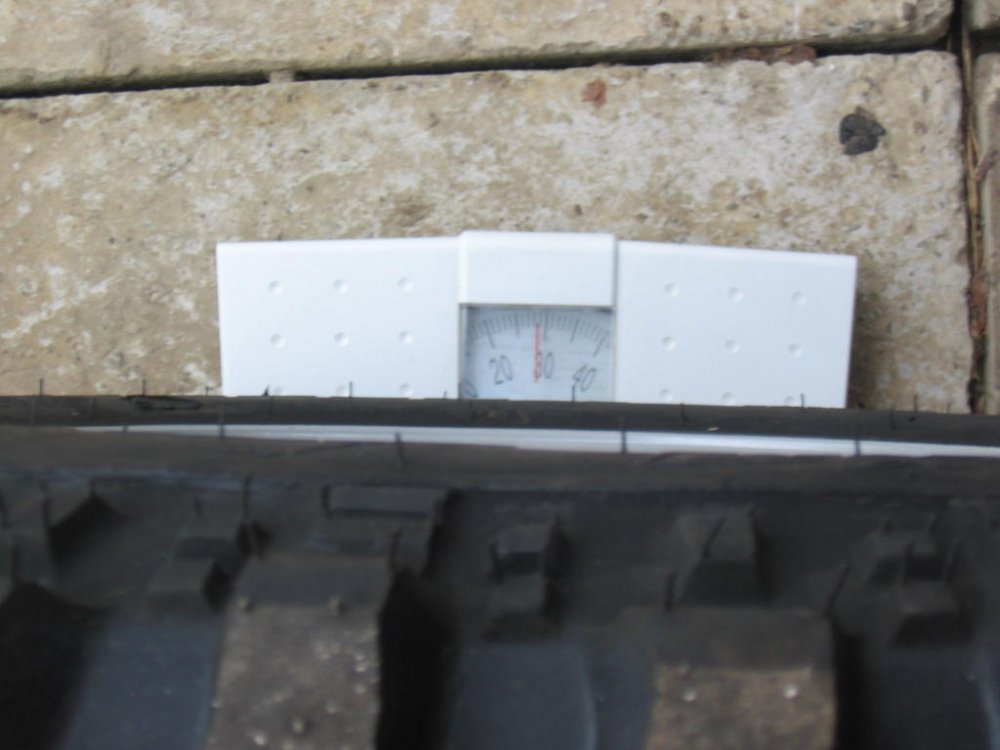

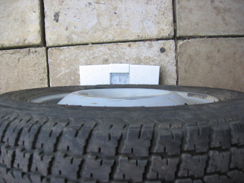

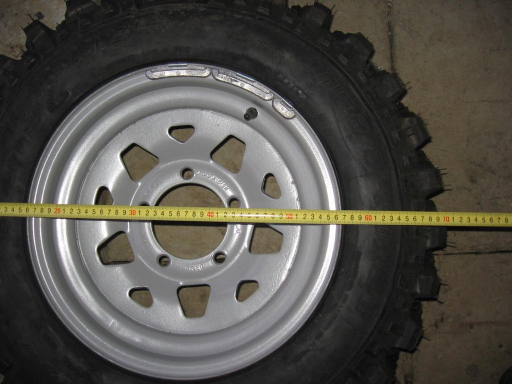

.........dupa o f lunga asteptare :old, am achizitionat mult asteptatele anvelope, puse evident pe jante de 15" (de aro tip JR sablate si vopsite electrostatic)IMG_8308.thumb.jpg.9eeb042783e672591c09584c39f235e5.jpgIMG_0901.thumb.jpg.092bfecaae5859dd2301809cd485f867.jpg
La proba cantarului, am constatat ca cei 2 concurenti: 1.janta+cauciuc original niva19kg/buc IMG_0919.thumb.jpg.49cde0a00552178ac0a29ce5c9a1c417.jpg si ...
2. noile achizitii cauciuc+janta 28kg/buc IMG_0917.thumb.jpg.4a3a19a16f1f3409f2758fb45c95b66b.jpg, sunt din categorii diferite de greutate :grin:.....sa speram ca nu vor da socuri prea mari incat sa crape grupul.

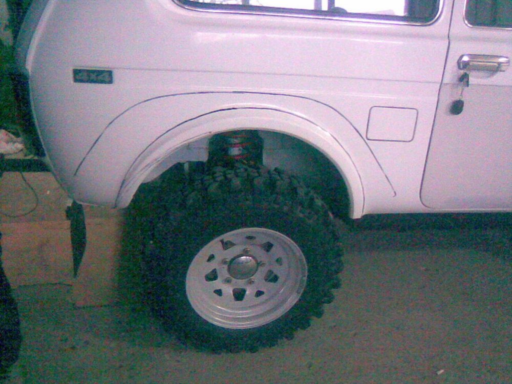

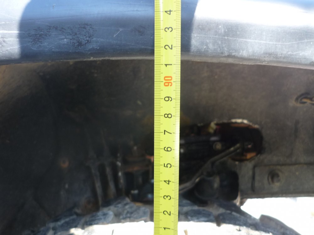

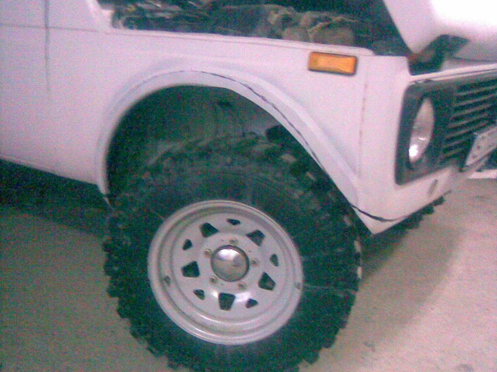

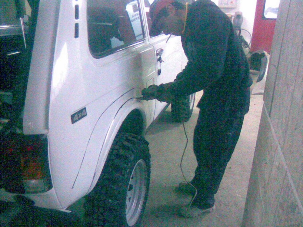

......o alta "problema" intampinata a fost ca dupa ce am pus noile cauciucuri nu mai puteam vira:ha:. Noile cauciucuri 195/80/15 ar fi trebuit dupa calcul, sa-mi iasa ca diametru cam la fel cu cele de niva 185/75/16 dar se pare ca 80-ul din indicatia resapatelor nu se refera si la crampoane, ele sint peste acel 80% din latime
IMG_0920.thumb.jpg.f096e5f7f515dcb5ea2c671077fdcf19.jpgIMG_0922.thumb.jpg.e010c731769db0fa6a0a8bd77b0f384f.jpg
.....si vorba unui impatimit care tocmai adusese flexul si statea cu el in mana in fata mea:"prima taietura e mai dureroasa, restul vin de la sine":uameni.
Am purces sa vedem ce si unde atinge.....taieturi.thumb.jpg.026142272af06093a60fd09abb3db3d9.jpg
Am dat aceste detalii pt ca eu nu prea am avut de unde sa le iau, sau nu le-am gasit si poate le e de folos si altora.....

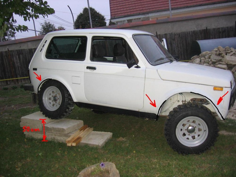

@ u.b.u. merci de pont, dar e prea putin pt ce mi s-a intamplat pe teren,la inclinari mari a puntii spate. Chiar si dupa taierile indicate mai sus, atinge in teren in anumite situatii.
Am bagat-o la facut barile fata spate(ceva home made),si evident taierile in mod gospodaresc a aripilor:grin: . Revin cu poze....dupa lifting:banana

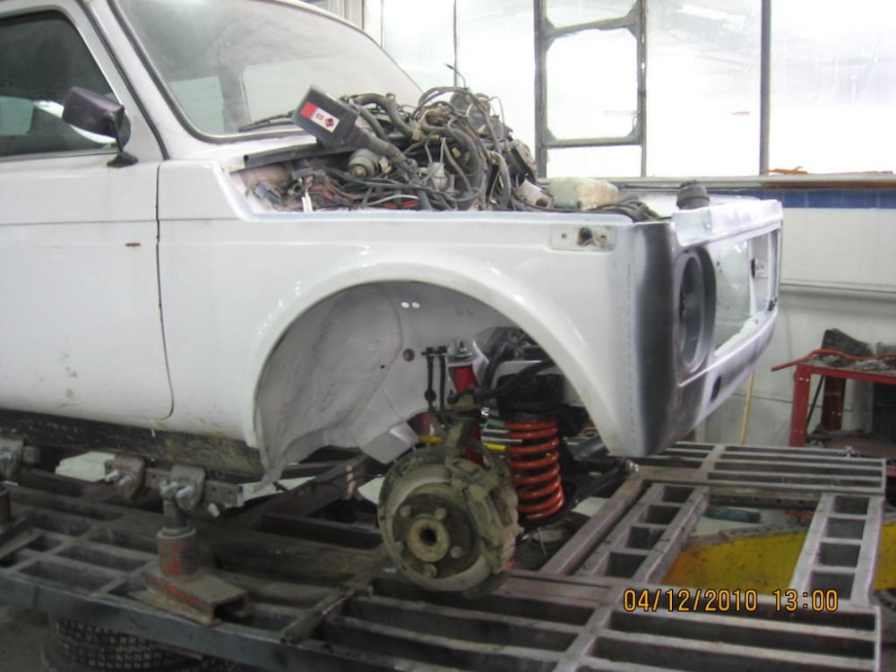

Re: LADA NIVA IASI - "Natasha"

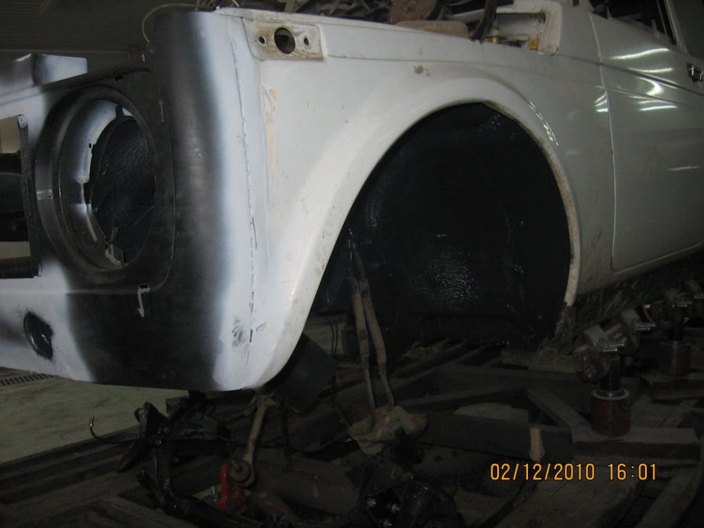

.......dupa cum spuneam , am bagat-o la lifting:grin:.
am scot tot din spate pt ca taieturile sunt in interiorul habitaclului si sa nu ia foc ceva de la suduri(mai ales ca pe partea dreapta spate dupa aripa am descoperit un rezervor de expansiune a vaporilor de benzina)15112011(006).thumb.jpg.f208da7b38893e2c50b8ecc86499de04.jpg15112011(007).thumb.jpg.9bf0edc51cb2eeb27140fa6c319542a4.jpg,
apoi se va suda oala inapoi pe aripa exterioara
in fata e mai simplu
15112011(012).thumb.jpg.b565ffb51963e9da8bdfa45cb5fc8746.jpg15112011(014).thumb.jpg.01a4edce7b5abcd893f71390f21e26e4.jpg.
revin cu detalii pe masura ce avanseaza lucrarile
