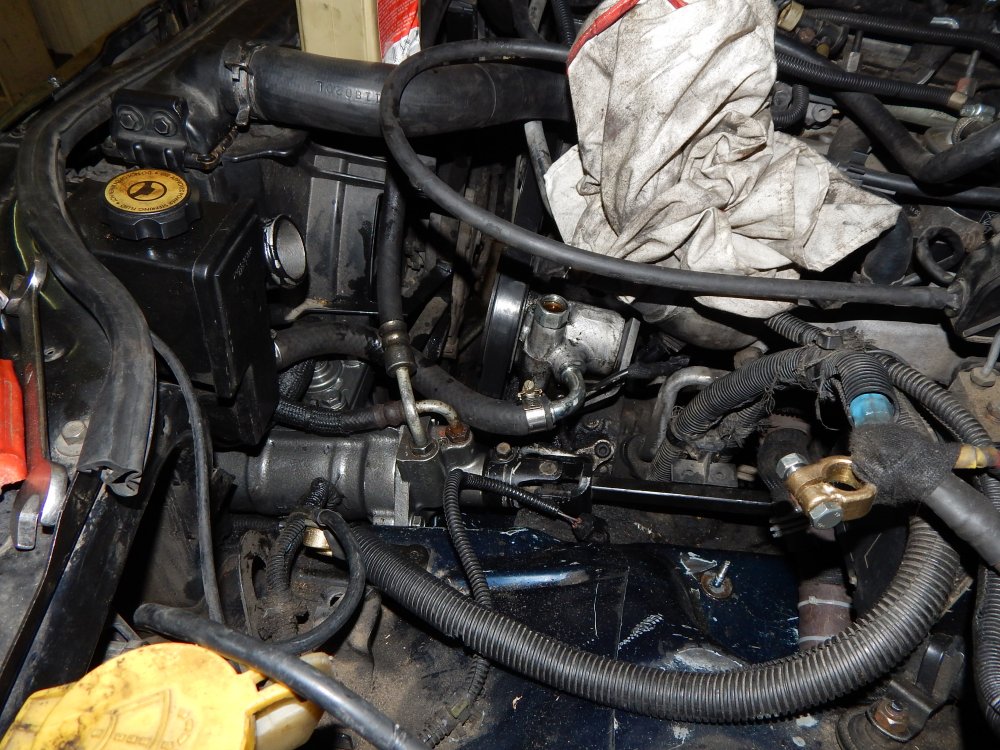

ssrli Posted May 18, 2016 Share Posted May 18, 2016 (edited) Re: Jeep Grand Cherokee WG 2.7 CRD -probleme si rezolvari Mersi pentru idei! Am rezolvat ieri dupa ce am dat caseta jos, o combinatie de presa si ciocan a mers struna. Masina se pare ca avea deja o caseta reconditionata...Delphi scrie mare si lat pe ea... http://i52.photobucket.com/albums/g8/DAdrianD/IMG_20160517_190606638_1.jpg Edited May 18, 2016 by ssrli '02 WG CRD - EGR delete '94 MX5 NA8 - Low, fast and stupid. Link to comment Share on other sites More sharing options...
