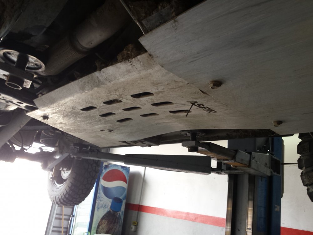

adrianfd Posted September 28, 2015 Author Share Posted September 28, 2015 Re: Noua mea jucarie Jeep Cherokee KJ 2005 2.8CRD sa mai scoatem niste poze de la naftalina. La mall, in Neamtului (mai tarziu altele de sus din creasta pe vreme buna), si Asfir-ul se indoaie: Link to comment Share on other sites More sharing options...

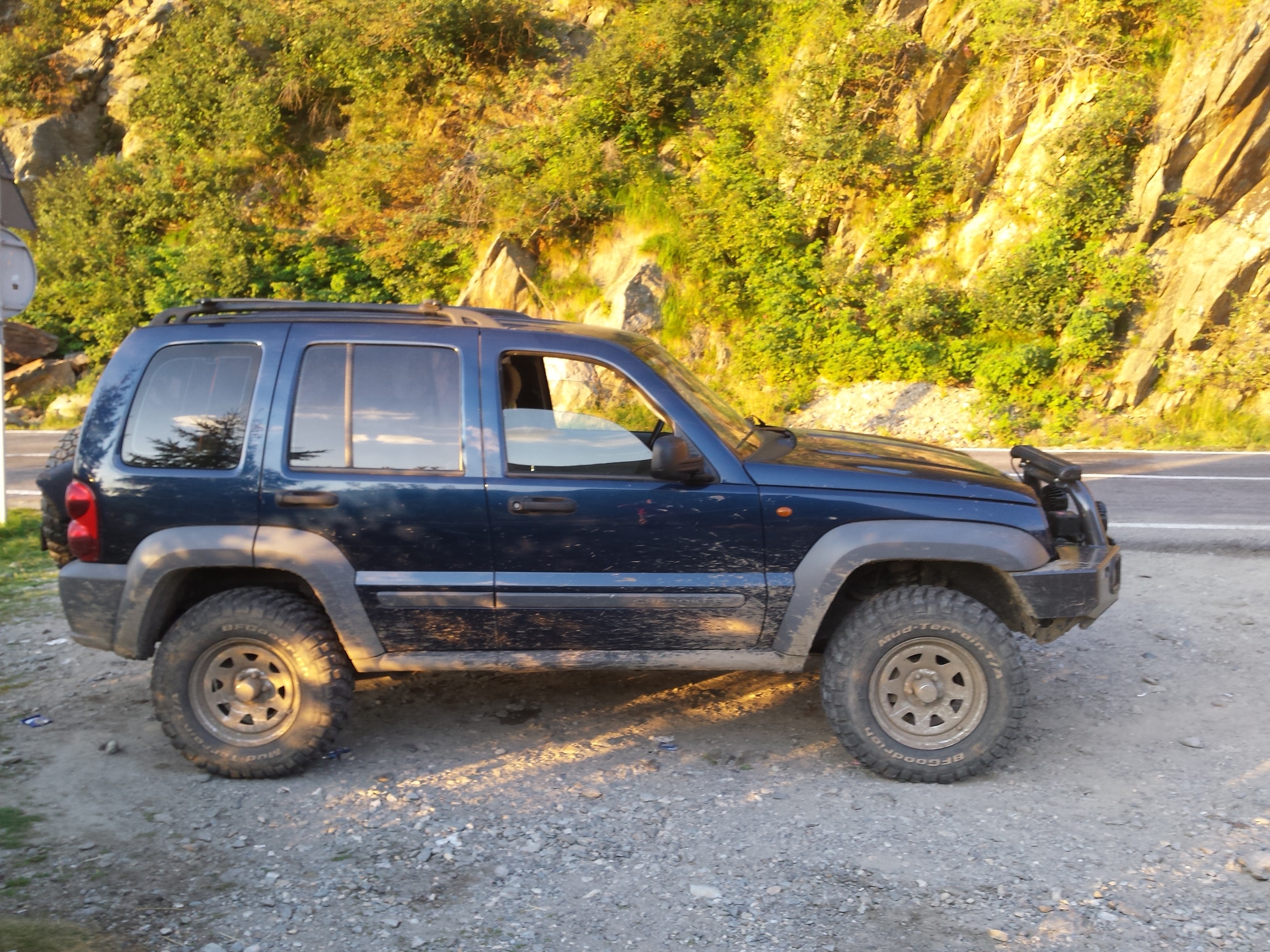

adrianfd Posted September 28, 2015 Author Share Posted September 28, 2015 Re: Noua mea jucarie Jeep Cherokee KJ 2005 2.8CRD Continuam, prin Neamtului si pe Orjogoaia, ce de oi dom'le, m-am ascuns intre copaci: Link to comment Share on other sites More sharing options...
